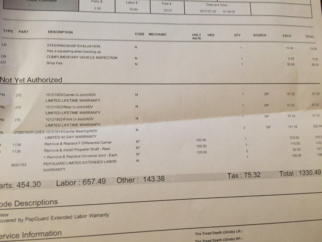

    Got quoted 1300 to replace all 3 U-Joints and Carrier bearing at Pep Boys. Other shop quoted me $400... What has everyone else paid? Been hearing a squeal when in reverse for the past month...

    Depends if it's just the U Joint. I was quoted 1k for a drive shaft after I warped it several years ago. Burned out the carried bearing and apparently it's a 2 for 1 deal (so I was told). It was fixed under warranty so didn't cost me a thing. Just going in what they said. However, didn't look like a hard job.

  10. Jul 22, 2017 at 5:42 PM
    ramonortiz55
    ramonortiz55 Not A Well-Known Member
    Nov 28, 2012
    #92013
    34,697
    Ramon
    Texas
    2015 DCSB Offroad 4x4
    stock
    where do you live?
    ill do it all for $700
    Rambo54 and Phoosa like this.
  11. Jul 22, 2017 at 5:43 PM
    excorcist
    excorcist Well-Known Member
    Aug 25, 2016
    #195492
    2,486
    Reno, NV
    '06 dcsb, '86 pickup, '89 runner
    Am I reading that wrong or are they trying to charge you for two carrier bearings?
    Rambo54, Coolidge and File IFR like this.
  12. Jul 22, 2017 at 5:44 PM
    excorcist
    Aug 25, 2016
    #195492
    2,486
    Reno, NV
    And 660$ in labor... sheesh, that is insane, any somewhat capable mechanic should be able to do this in well under 2 hours.

    Sure looks like it! $141.32 x 2!

    That estimate is for replacing the carrier bearings in the front differential. As in, ring gear bolted to the carrier, and the carrier spins on 2 tapered roller bearings. Even if your truck did need new front differential carrier bearings, there's sure to be a bunch more stuff needed too. Pinion bearings, seals, gear oil, etc. Besides all that, those bearings don't even turn in 2wd.

    The more I read that invoice the more I get annoyed with shops like this... I would love to talk to the "tech" that takes a half hour to remove and replace one u joint.
