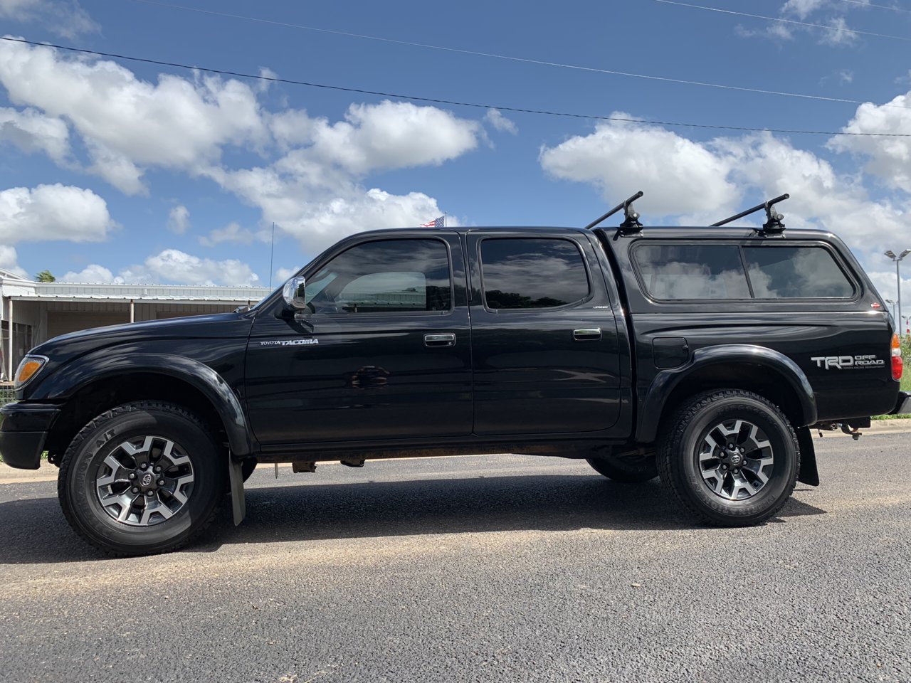

    Well unfortunately my beloved 1st gen had an engine melt down yesterday going 70 on the freeway.. My local Toyota dealer diagnosed I need a new engine. Lower end of the engine has a bad knock.
    Never thought that would happen being I searched for a very clean one with a good service history and the v6 is known to be bullet proof.
    Only thing I’ve changed on it recently was I started using amsoil and I was on my 3rd tank of premium fuel. Not sure if that played a factor but worth noting. Oil on the dipstick was good.
    I’ve never had to buy a used engine. What’s y’all take on buying a used one. American vs. JDM. Best warehouse ? Or just junkyard it ?
