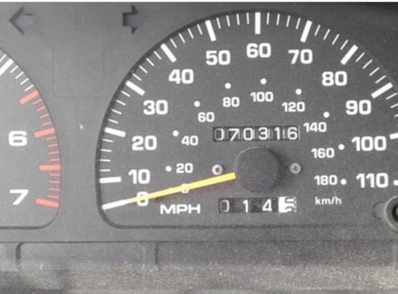

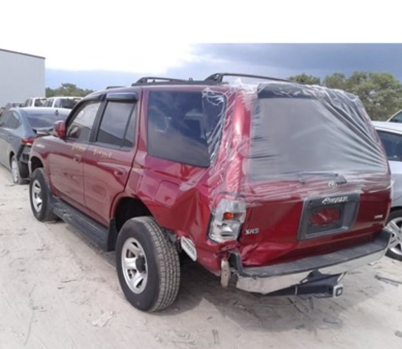

    I recently bought a 70,316-mile engine out of a wrecked 4Runner from LKQ. They provide pictures of the vehicle and the VIN so you can run a CarFAx. It turned out this car was wrecked in February and I bought the engine in April. So the engine had not been sitting long. I could see where the car was put into service in Orlando FL and when the owners took it in for service at the Toyota dealer. They left a good maintenance trail. LKQ provides a replacement warranty. Most shops around here use LKQ for used engines and transmissions.
