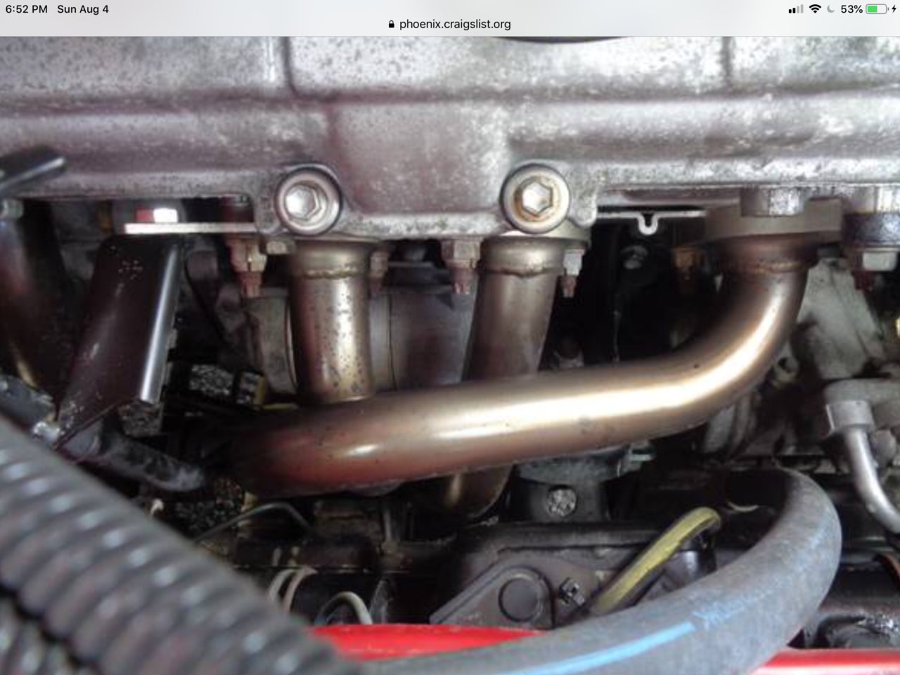

    Have him toss in the stainless steel headers for free and make a deal.

    Haha, yup, that’s with a clutch to or so. so it would be less if an auto, but a snapped exhaust head stud or two can change things

    This truck has headers and those nuts and bolts are a huge hassle to get to and remove, especially the drivers side in particular.
    Hopefully they dont break the studs off in the heads just to get the motor out and headers off.
    If you buy this motor make sure ALL the exhaust studs are accounted for that hold the headers on.

    even if the engine you buy has snapped studs, you can bore them out and grab new ones for less than ten bucks for the pack of studs. Still, its a hassle you can avoid by patiently shopping for the right block.

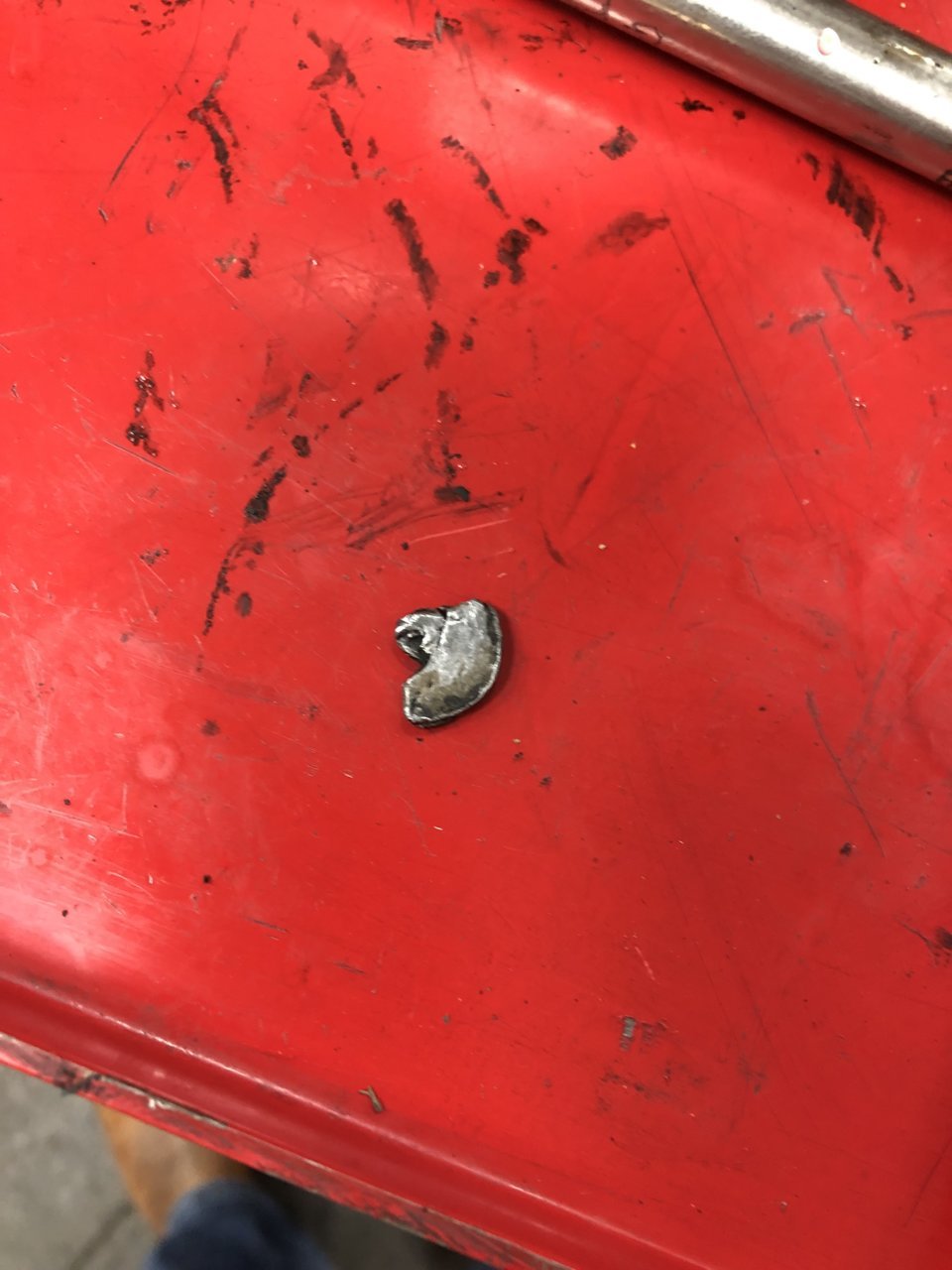

    This was found in one of my cylinders. Not sure what it is but nice to know what ended my 3.4

    I had to take the motor out of my 96 4X4 twice in 6 months due to bad timing... one to replace a rear core plug, the second to replace the exhaust crossover. In between I had to replace the brake vacuum booster... the amount of room with the vacuum booster off is pretty good. 3 minutes and 6 bolts for all of that room. It is coming off everytime from now on. It just might give enough room with headers...
