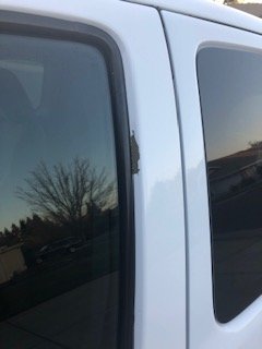

  5. Apr 17, 2021 at 8:26 PM
    #85
    Vorra65
    Vorra65 Well-Known Member
    Jan 24, 2014
    #121341
    224
    How old was your truck, and mileage.....when they finally helped you.
    Mines a 2014 AC, TRD and hit the door at the window with garden hose and spray nozzle- pisser is, the stealership that I ordered my new dc from was going to give me top $$ for it when my new truck gets here.
    Wyldman[OP] likes this.

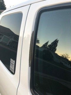

  6. Apr 18, 2021 at 9:23 AM
    #86
    Wyldman
    Wyldman [OP] Well-Known Member
    Oct 16, 2014
    #140497
    57
    Chance
    Rural,MS
    2014 White Tacoma TRD Offroad
    3" Leveling Kit, ~33" General Grabber A/T, 18"x9" Machined Rockstar II, Fender Flares, Road Armour Front Bumper, 10K Smittybuilt Winch.
    I hate to hear that @Vorra65 . Make sure to call Toyota Customer support and let them know this happened. I called them again about 2 weeks ago and they told me, again, that they haven't had enough complaints yet to merit adding our Tacoma's to the list of vehicles that they will fix.
    Everyone who calls and lets them know what's happening gets us one step closer to getting our trucks fixed!
    Keep us updated on what happens.
    Have a good one!

  9. Apr 19, 2021 at 10:11 AM
    #89
    Kinney
    Kinney Member
    Feb 4, 2015
    #147849
    11
    the truck is a 2012 and it has around 120k when they helped me. they had complaints in the area so they were able to send in some pics to toyota to get it painted.
