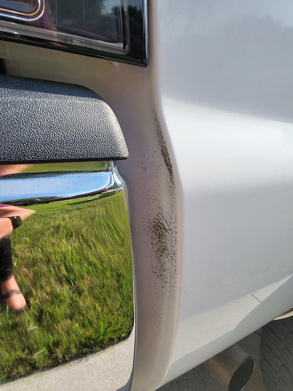

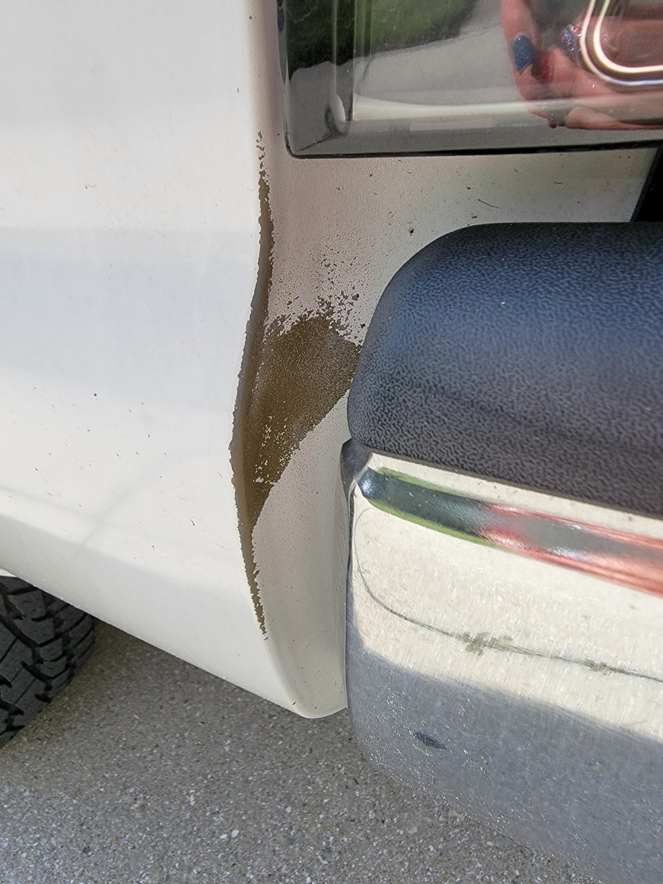

    I know someone that took their white Tacoma to a Toyota dealership with a collision center. Said they approved and repainted. I went to the same center and they explained what causes this and did the "tape test" that pulled off paint in new areas I wouldn't have thought to check and made the current peeling areas much worse (both sides under tail lights/behind bumper, both sides top of fender between windshield and front doors, gas tank door & panel). They sent pictures to corporate and they denied the request telling me Tacomas aren't covered (even after the dealership told me they've been doing Tacomas and my friend just had his done) but they also said I don't have much maintenance history with them. I said I could supply all maintenance history if that's the issue, but the techs at the dealership even commented on how well the truck has been kept. Called corporate and got no where. They had nothing to say other than a letter would be sent out if a support program is issued. The dealership did a courtesy on their own and touched up the areas they pulled paint so the metal is covered, but this is only a quick fix to avoid rusting. Everyone should call and voice their issues.

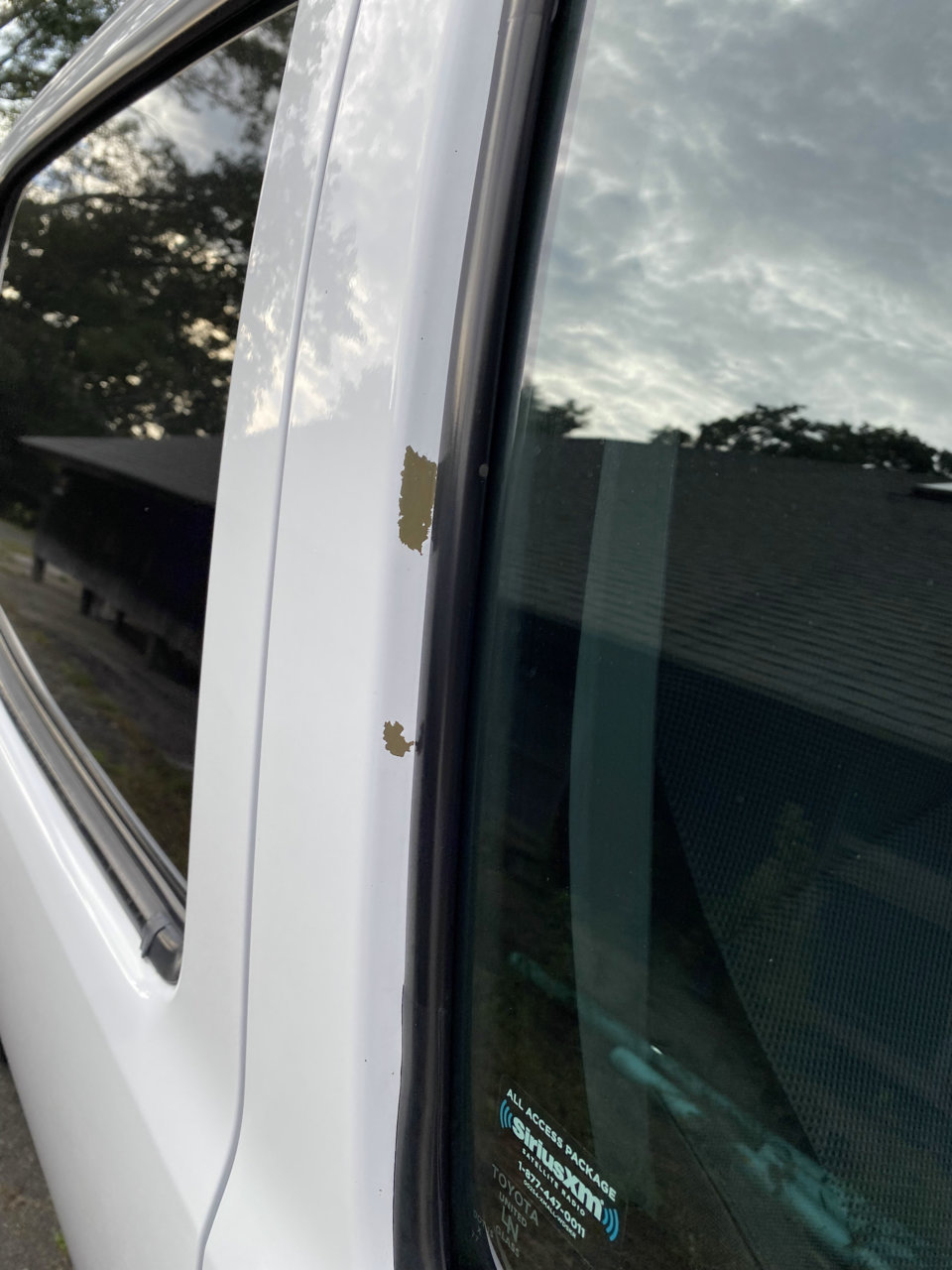

    I just took my peeling super white DCLB to the dealer today, I got the same story, everything but the Tacoma is covered! The Service Manager is going to submit it to Toyota, we'll see what happens. My roof feels like 320 grit sand paper, my doors are peeling around the windows, my A pillars are about to peel, as are the tops of my fenders. The problem is, only the doors will pass the tape and peel test as of today. My hood looks like hell, its all splotchy and the front corners above the headlights are getting dark like the primer is about to break through.
    My truck is a '14 but it has had issues for a few years, I am also only at 37,000 miles. I take good care of my Toyotas, I currently have 3, I've had 7 since 2006. I hope that Toyota shows some mercy. I had thsi exact same issue with my 2006 DCSB, I paid the dealership $800 in 2012 to repaint my hood, roof and tops of the fenders. The new paint was shiner than the new truck paint ever was.
