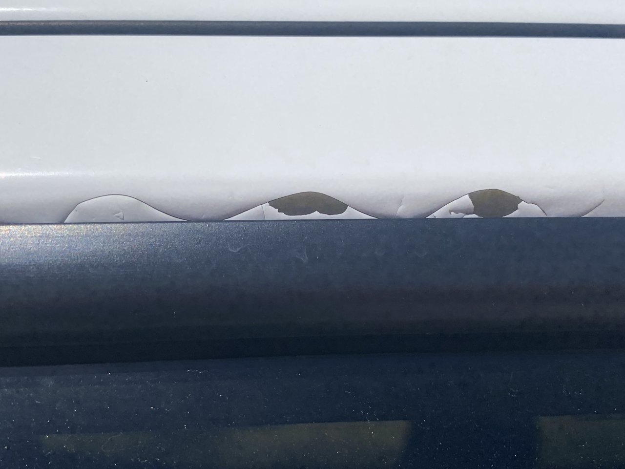

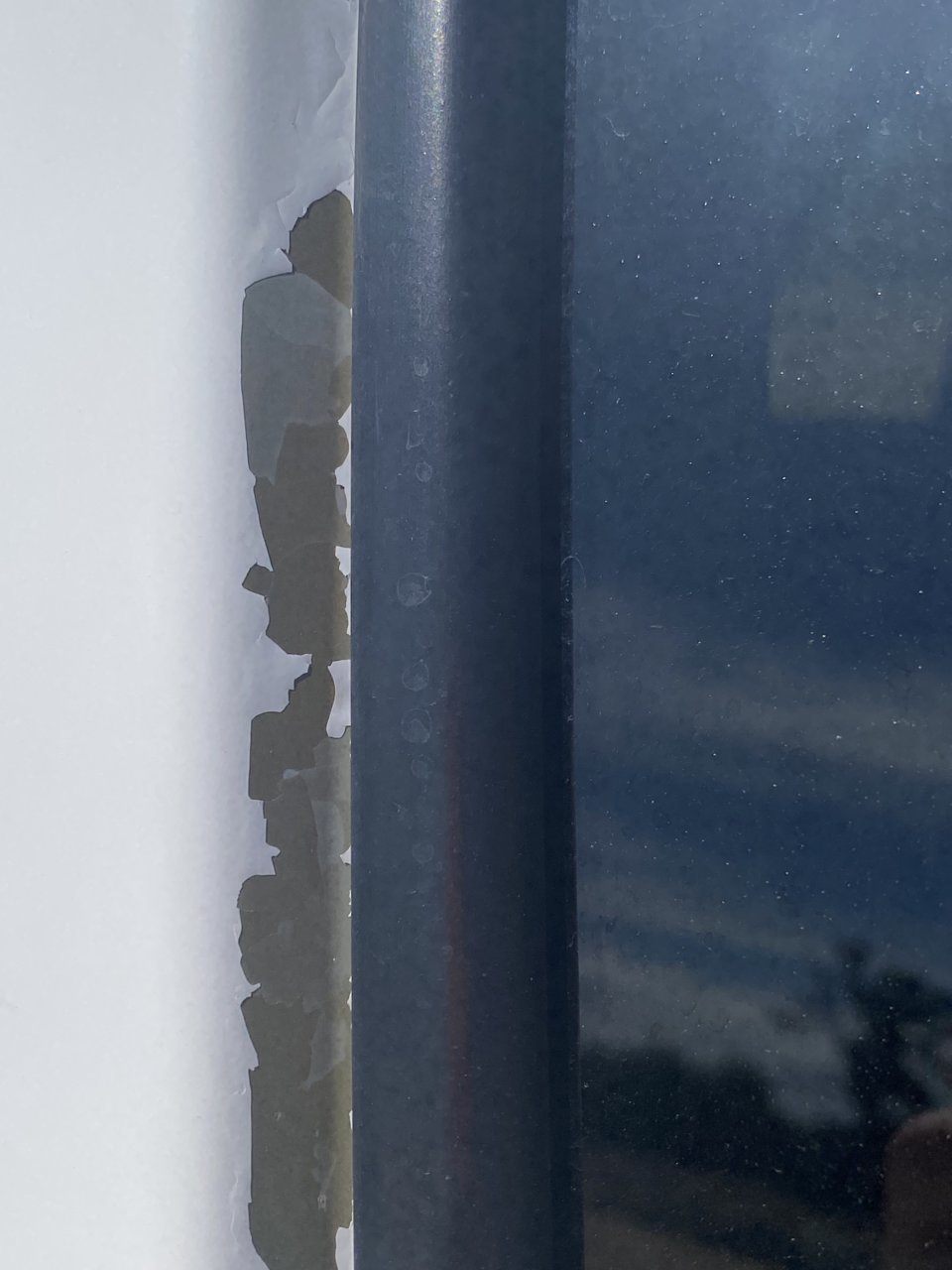

    Original post continues . . . My 2015 Tacoma, white, was in immaculate condition here in California, at 94,000 miles, then, overnight, in February, the paint around the windows began to peel as shown in photos. I was, like, WHAT??? I took it to my local dealer and they acted like they'd never seen this problem before, although admitting it happens to Camrys and the Prius. They took photos and made a report to Corporate. That was 3 weeks ago, and I haven't heard from them since. Luckily, I found this thread and found I'm not the only victim.
    The problem, currently, is just around the windows on the passenger side. I got a quote from a body shop for $1,000. I'm bummed by this experience. I'm the original owner, and I've babied this truck with 23 oil changes so far. The service on all the fluids is up to date. Just put new front rotors on. It's gone from gorgeous to ghetto. I'm not proud of it anymore.

    Hate to see it, welcome to the club. Please open a case with corporate. With this volume of cases showing up on TW daily, the data points are hopefully adding up in the database.
