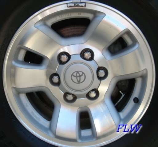

    Which rim is it that Discount says not to use with 32x11.5-15s? Is it one of these?

    I think that running 11.5'' wide tires on aa 7''wide rim is not good. I think you need 8'' wide rims to keep wear on the tires good for 11.5-12.5'' wide tires, even 10'' wide rims for 12.5'' tires. All stock toyota rims are 7'' wide..

    32x11.5-15s on stock Tacoma 15x7 alloys will clear the upper control arm and the tires will look good and wear correctly too. I know this because that is what I ran on my 1st Tacoma.

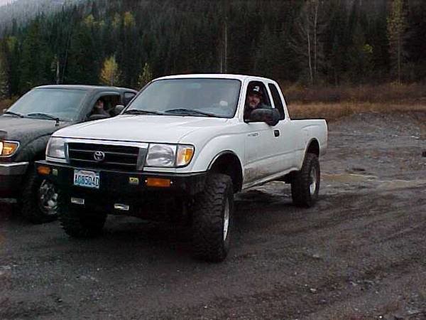

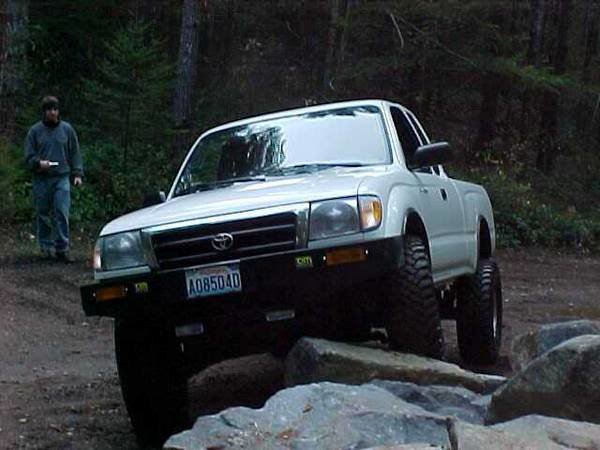

    The white '98 I posted a picture of had a spacer lift and replacement rear leaf springs. About 2.5" of lift from the spacer and leafs. The tires were 32x11.5 BFG KM1s mounted on these rims.
