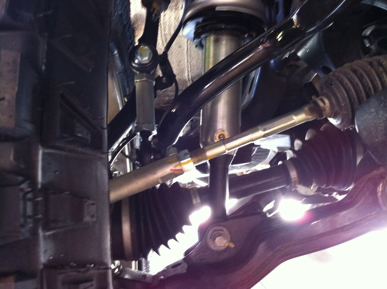

    Well, FOX IFP 2.0 cranked up 1", gave me a full 3" lift up front.
    Boris20[QUOTED][OP] likes this.

    Mine are a firm ride, but I tow with a lot of camping gear. Towed my Jeep from CA to Moab at 80mph with no problems. Love it.

    Here is a better shot of where mine was and you can see they have been cranked up about an inch.
    Boris20[OP] likes this.
