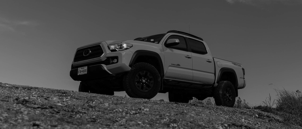

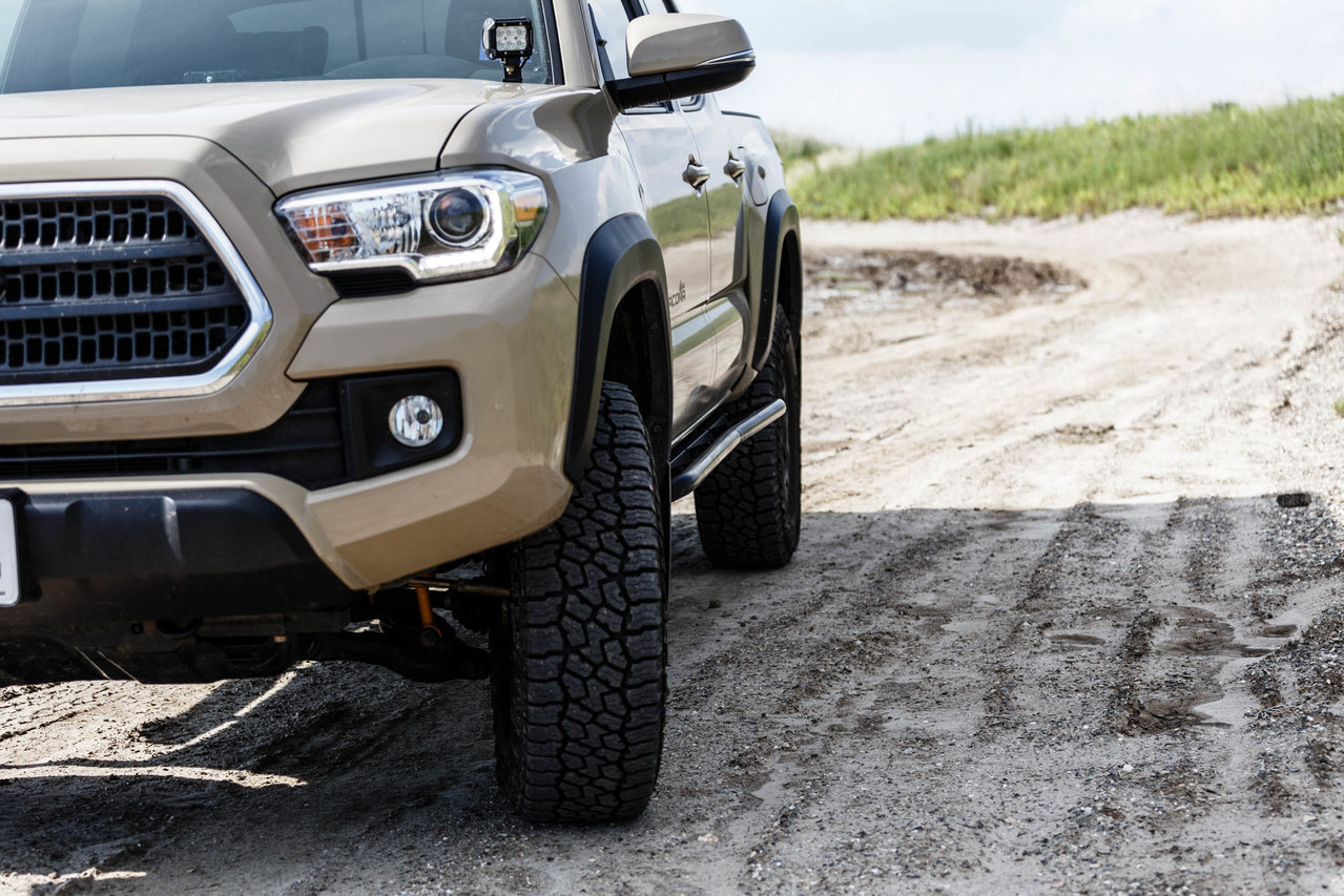

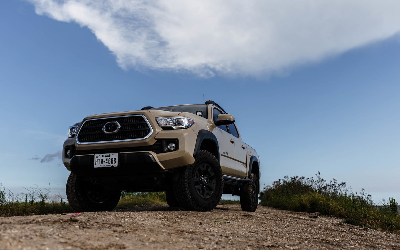

    @Boris20 Here you go OP. I have a QS 2017 TRD OR DCSB - I put on a 2" lift (OME 887 front + dakar light duty rear) + Soft ride Nitrochargers from @HeadStrong Off-Road (Marie).
    That was 2" lift, love it. Then I put on the Falken Wildpeak AT3W 265/75/r16 just like you mentioned. So essentially, here's your truck lifted.
    Also did LR UCA, ECGS bushing. ~$1700 for lift (including LR UCAs) + ECGS bushing.

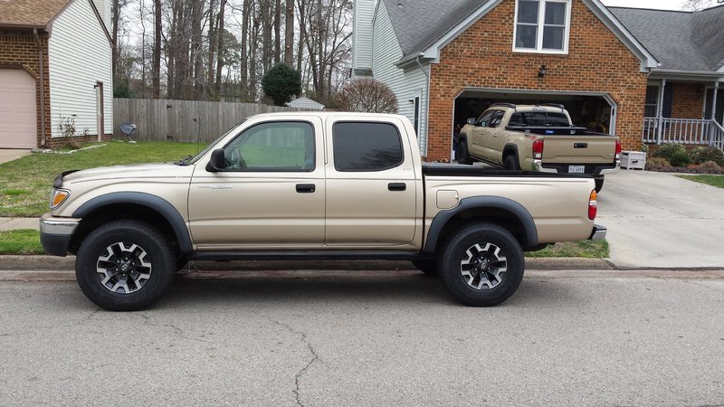

    I put 5100s on my 1st gen about 7 years ago, no issues and no leaks.1457986593949-1633363427.jpg 1457986665568-955241857.jpg
    That's why I put them on my 3rd gen, I tend to stick with what I like.
