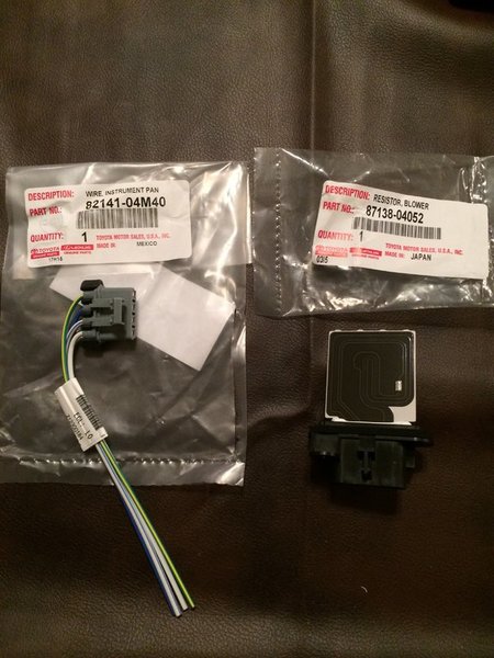

    Also check the connectors to see if you have a loose, burned female pin.
    This is what you need to fix your problems with the blower: A new resistor assembly and a connector plug, with part numbers on the package. See image below.
    Plug Number 82141-04M40
    Resistor Number 87138-04052
  7. Oct 13, 2016 at 7:09 PM

    Check the plug for the blower motor resistor first, it's in the passenger floorboard up against the firewall. Sometimes people will shove my floor mat up and that causes it to stop. I replaced the plug, repinned the terminal, and have a spare set for about $12.
    https://www.tacomaworld.com/threads/before-you-replace-the-blower-resistor.107093/

    Wish I had found this thread before buying a new climate control panel. Bought these two parts on Amazon for about $50 and installed them in an hour. It's a bit tricky to get to the screw that's farthest in there, but a smaller ratchet wrench will get it done. Works great now.
