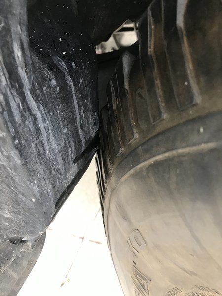

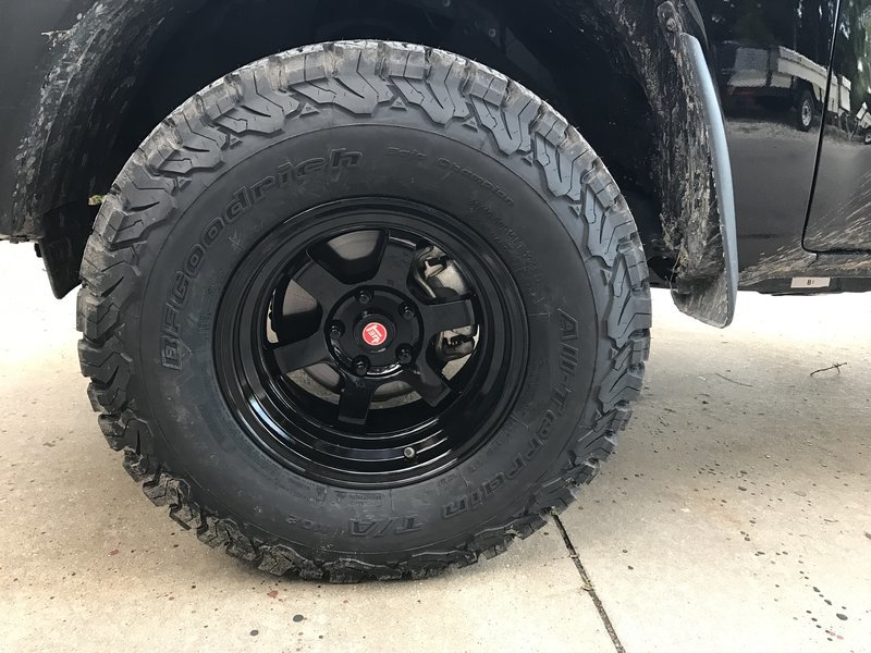

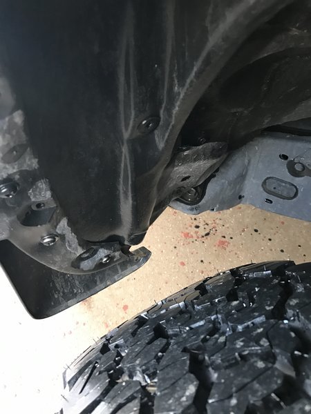

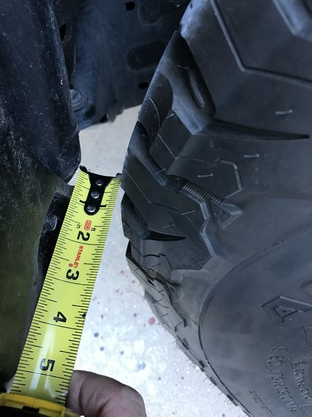

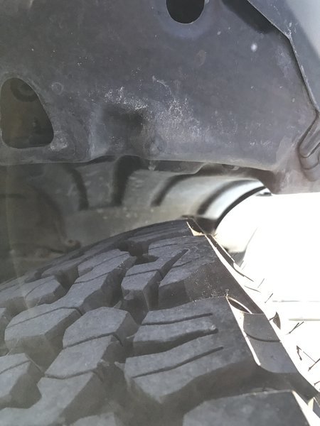

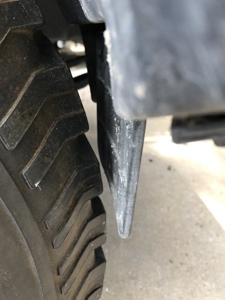

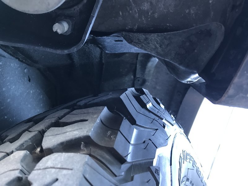

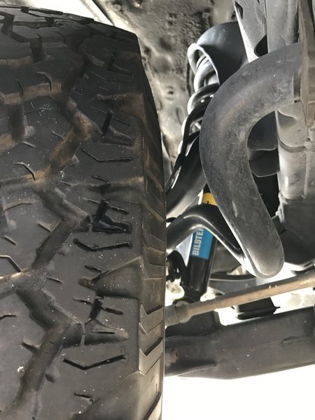

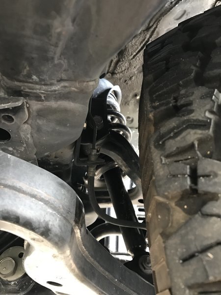

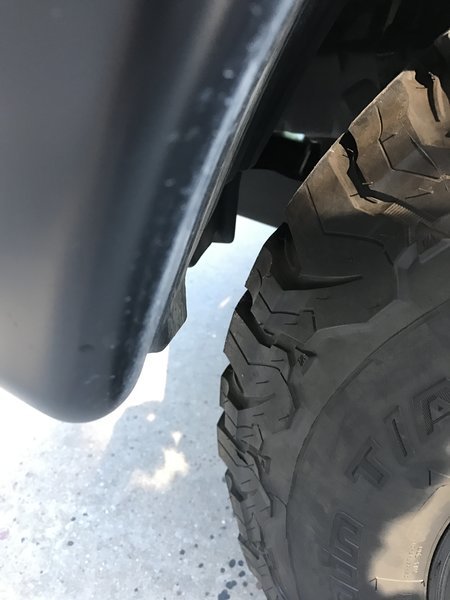

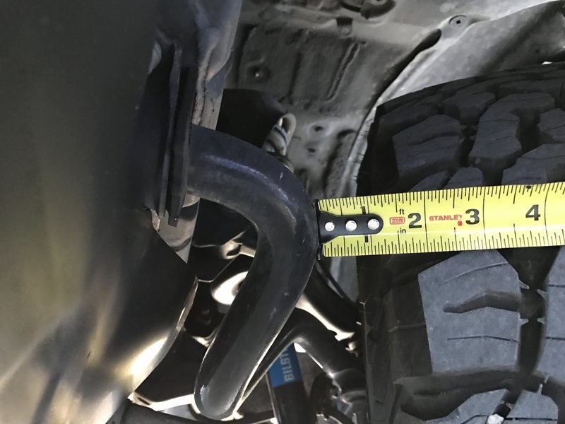

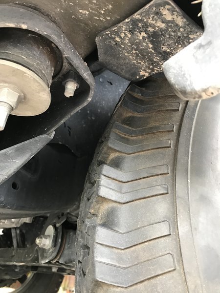

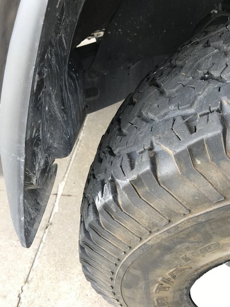

    The white wheel is a 33x10.5 on a 15x8 0 offset . Had 1 1/4" gap at full turns if you can see in pics. so no rub. Just little flap at front and the black box. That's was a test . Went with 31x10.5 same rim just painted. And molded the plastic at the black box with heat gun. Last 2 pics are finish product. The first 7 are test fit pics. 33 worked but I thought it was to much. Prefer a bigger gap in the wheel well around the tire.

    any florida people want the 33's in test pic's i have 5 with 1/2 the tread pics show whats left on tread 50 bucks each. they are 33x10.5x15 they come off my fj60.

    i don't really want to say . and then you have issues. thats your call. but you would have to cut plastics. and i didn't want to cut anything i still am only 30,000 miles. i don't mind unbolting stuff. and on an older truck i would say go for it. i would rather have wider tire. but heres some 31 pics still kinda tight. that tape is 1" wide. and the 32's are 1/2" wider on each side and a 1/2" taller top and bottom. plus with the 33" i didn't drive it just turned wheel from side to side and checked with tape.
