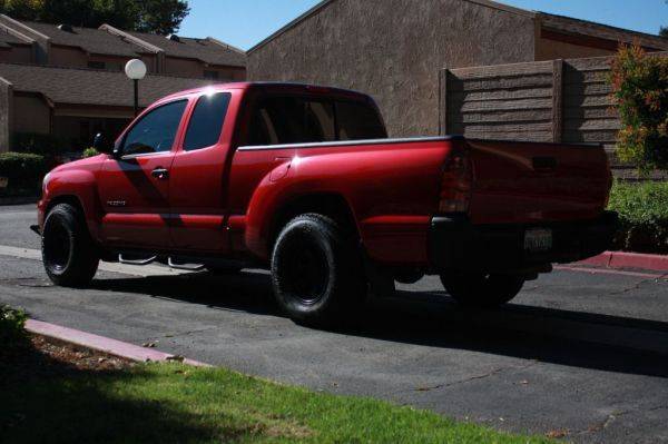

    Avid Offroad light bar (Black), Avid Step bar (Black), TRD skid plate (Black), BHLM w/yellow signals, Pioneer Avic-x930bt, OEM fogs w/ yellow H10, Magnaflow muffler, aFe drop in filter, Toyota Neoprene "Tacoma" seat covers, Shorty antenna, Tint, Removed secondary filter, LED interior lights, LED reverse, Bedlinered rear bumper, color match grill, Black emblems, Red rear signals, Bed mat, OEM bike mounts
    im running 15x8's with 3.75 backspacing. 30x9.5 tires. I needed to remove the black box and add 3mm spacers in front to clear calipers. they stick out a lil but im happy with it.

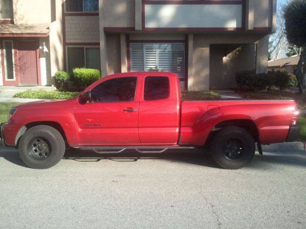

    Post a side view pic of the truck so we can see what you have going on there. Please.

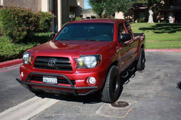

    Here you go ...

    Looks good. I see you have the Avid light bar on the front. Good looking truck.
    I just picked up some pro comp 15x8's. I should be getting the tires pretty soon. I'll post some pics on here once I get them all together.
