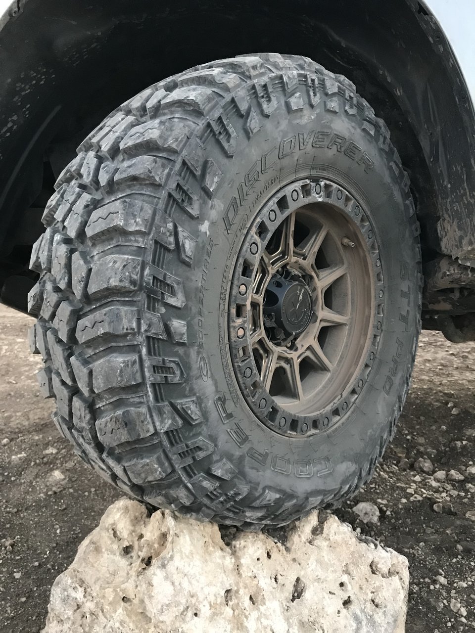

    I went 16” because I really fell in love with the beefy look of the STT Pros on a 16” wheel.

    looks awesome man, what wheels are these?

    What did you have to do to fit those tires?

    16x8 ATX ax202 matte bronze

    Just 5100’s at notch 4.
