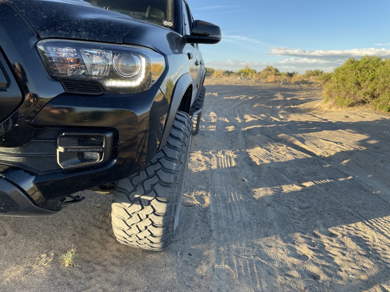

    One of the only companies I've seen that offer a 16" option is Ultra Motorsports with their 103X but looking at their site again it seems all the 6x139.7 bolt pattern options are gone now, not sure if that means out of stock or discontinued. Might be some resellers that still have some sets on hand. I'm running the 103X's but they're 17's with a -14 offset, their 16" was a -25 offset (P/N:103-6883MPBL25).

    Man, thanks for the info! Those look slick. If they’re -25s then I will cab mount chop mine and probably go with a 305. I appreciate it
