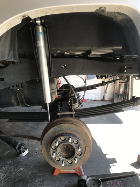

    I have never seen a leaf spring that needed a 16" shock, ever. Lots of wasted effort to make them fit. I'd stick to 12" tops.
    For comparison these are 16's and arn't even max'd out.
