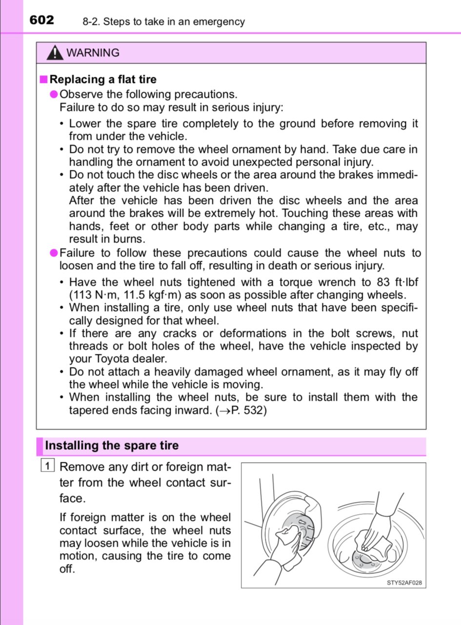

    What is the torque spec for the lug nuts on a 16 tacoma with alloy wheels?

    83 ftlbs

    Noted in the Owner Manual along with a bunch of good info.

    Where? Been going over the owners manual for the last half hour. It's not under wheels, tires, tire rotation, or the maintenance categories.
