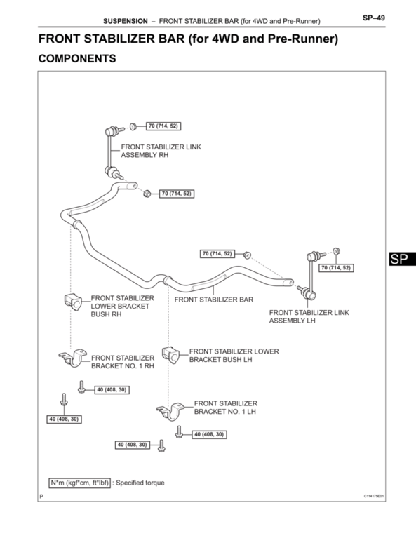

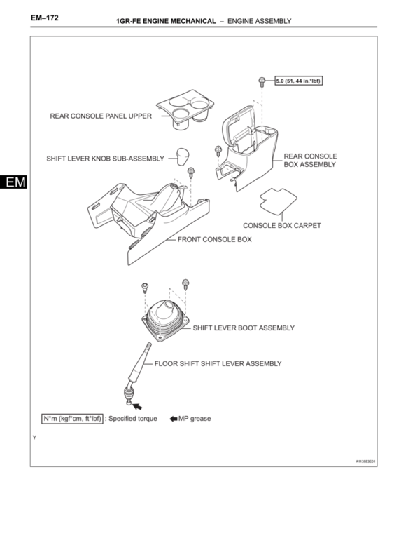

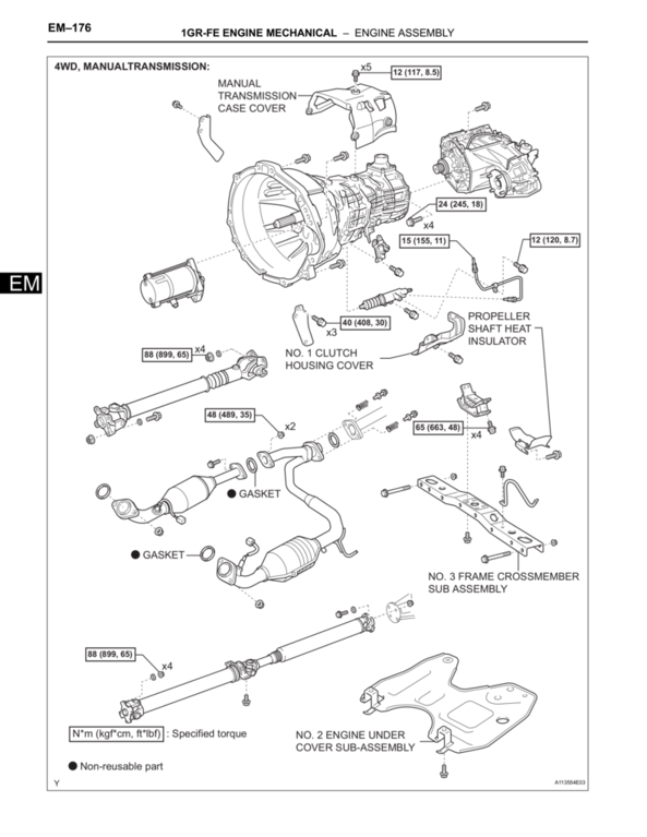

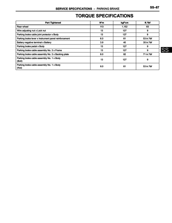

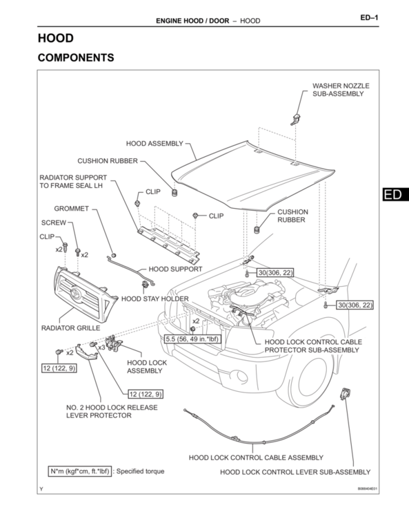

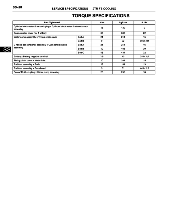

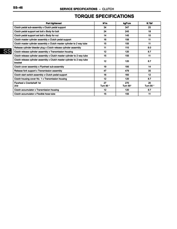

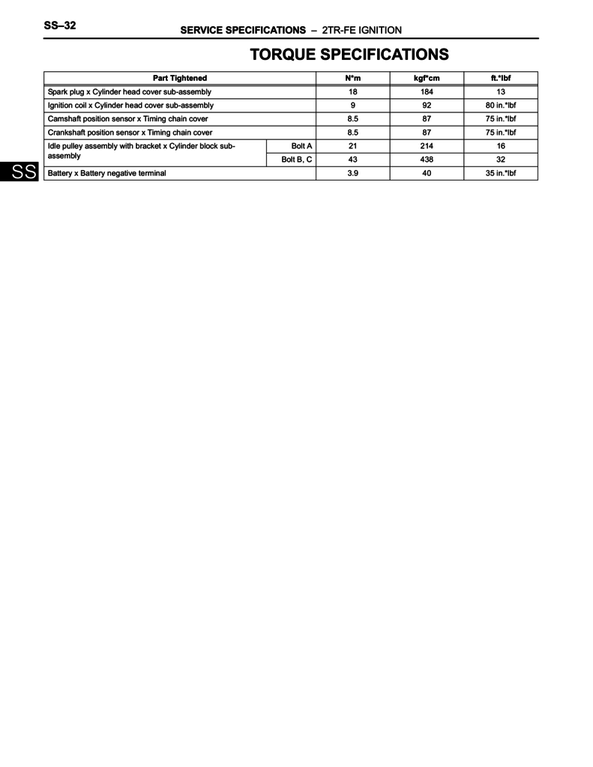

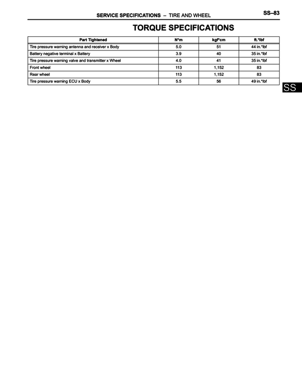

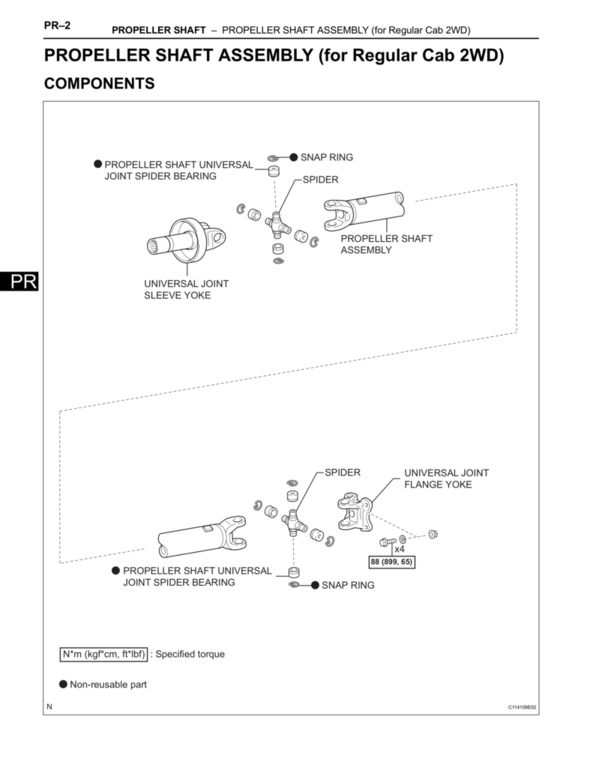

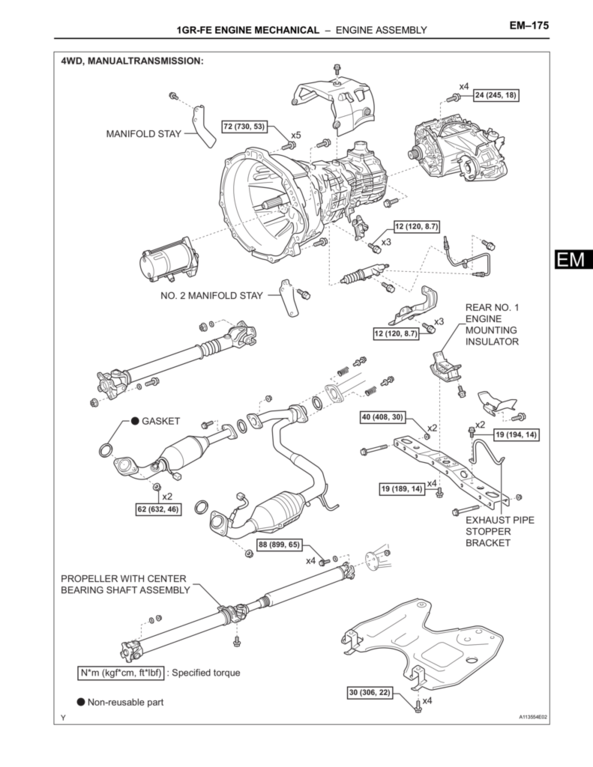

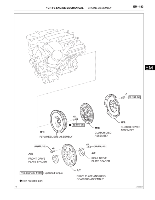

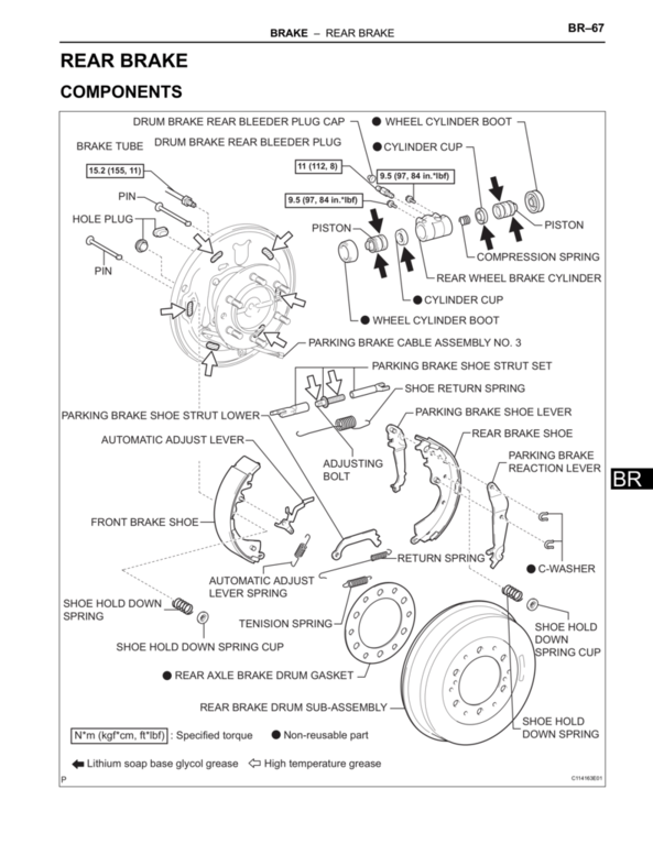

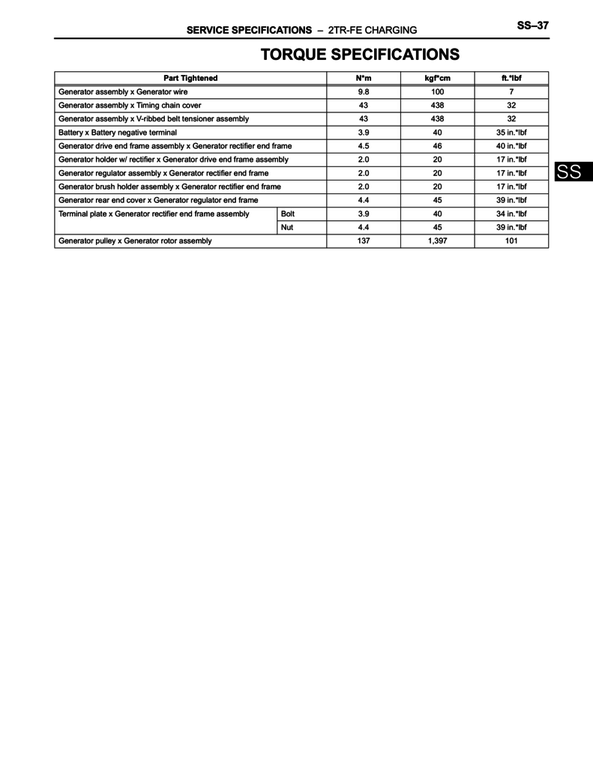

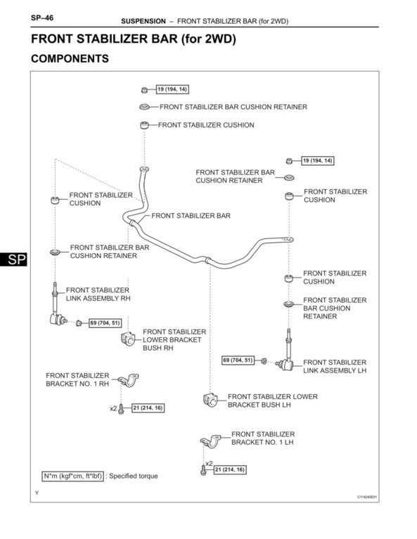

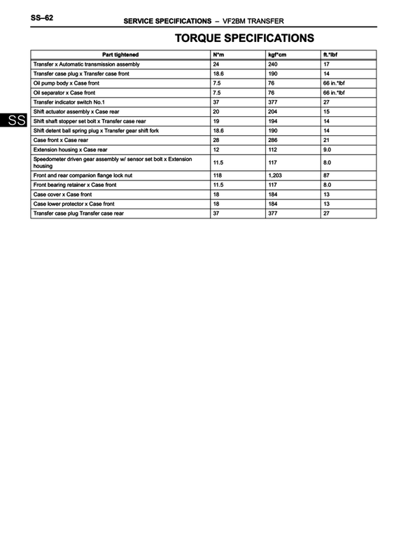

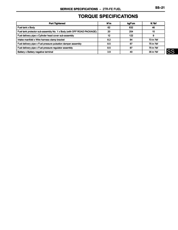

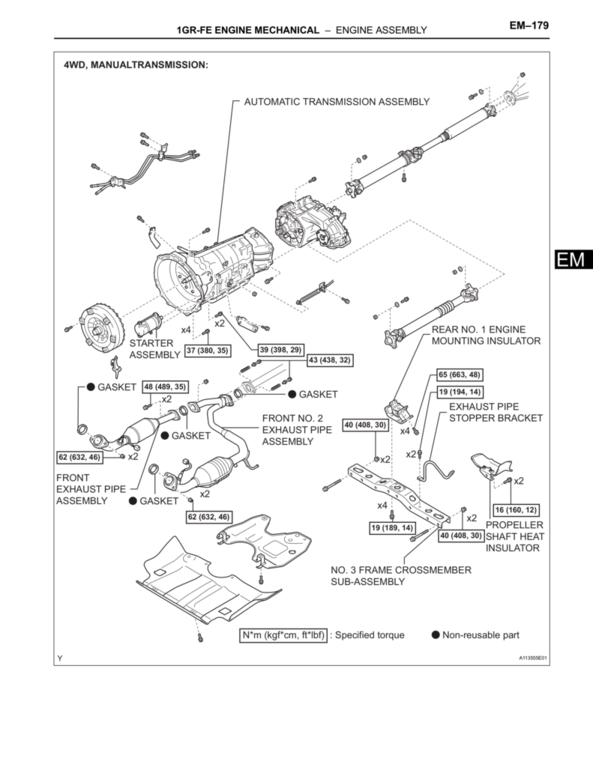

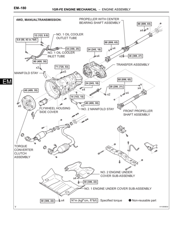

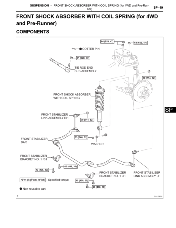

    I put together a collection of some of the most-common Torque Specs and Diagrams. These are all from the 2006 FSM.
    __________________________

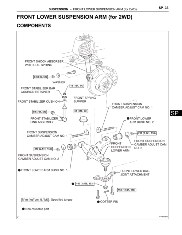

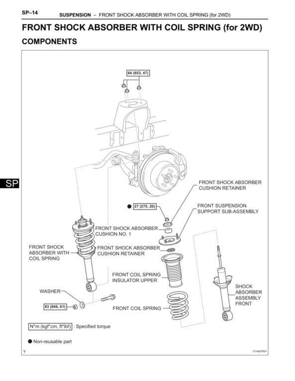

    FRONT SUSPENSION COMPONENTS
    2WD
    4WD & Pre-Runner

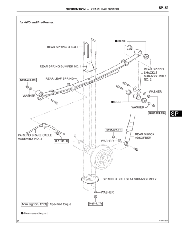

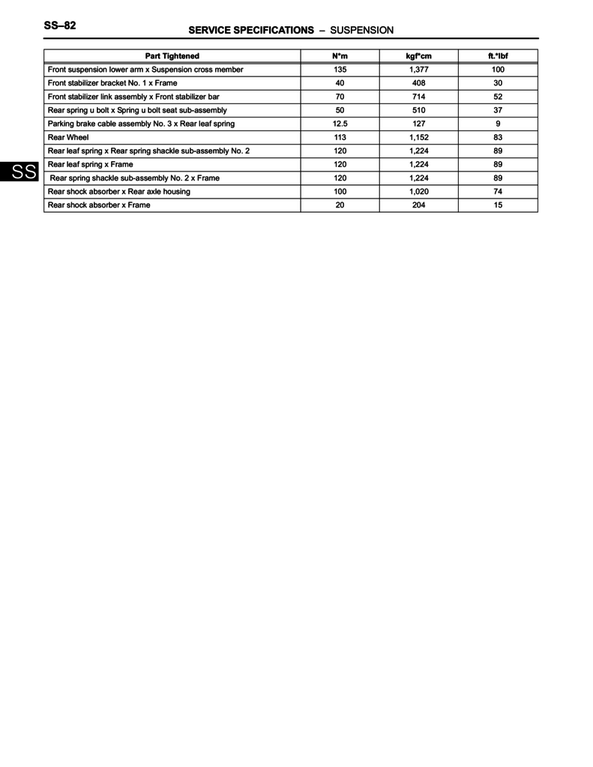

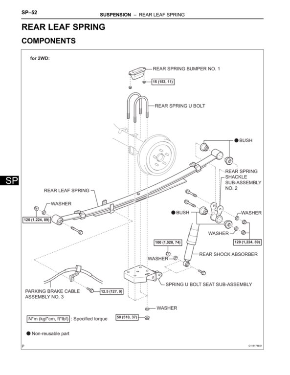

    REAR SUSPENSION COMPONENTS
    2WD
    4WD & Pre-Runner
    Rear Shocks (2WD/4WD/PRE-RUNNER)
    Suspension MASTER LIST

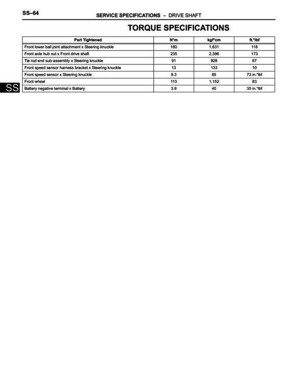

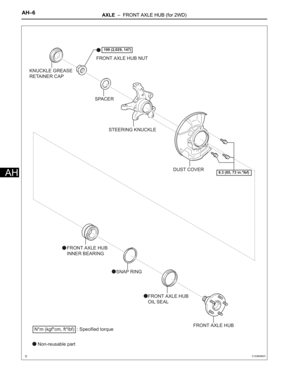

    FRONT AXLE COMPONENTS
    2wd
    4wd & Pre-Runner
    4wd ONLY

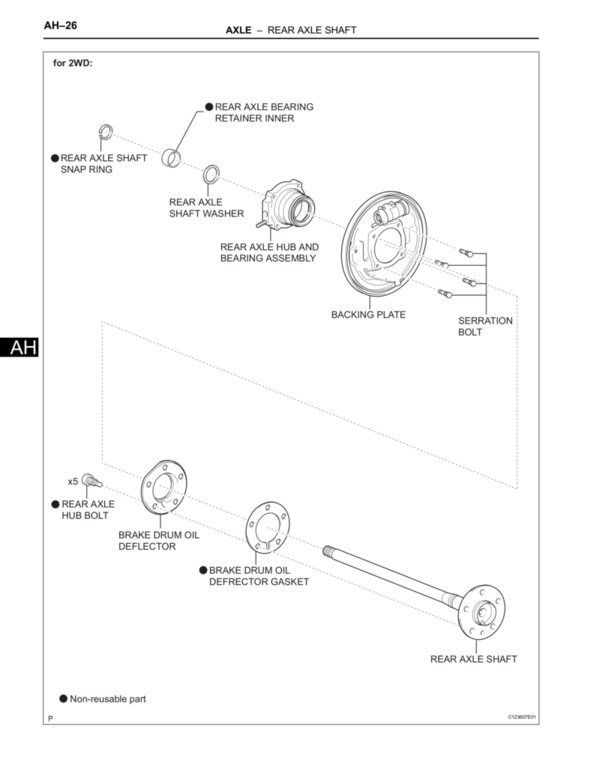

    REAR AXLE COMPONENTS
    Front & Rear Axle MASTER LIST
    4wd Only

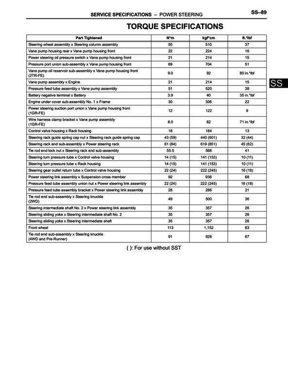

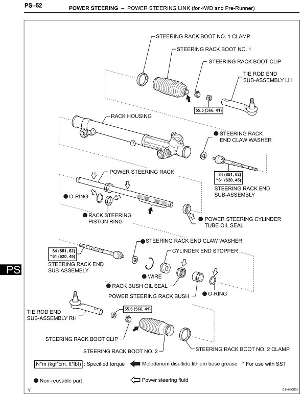

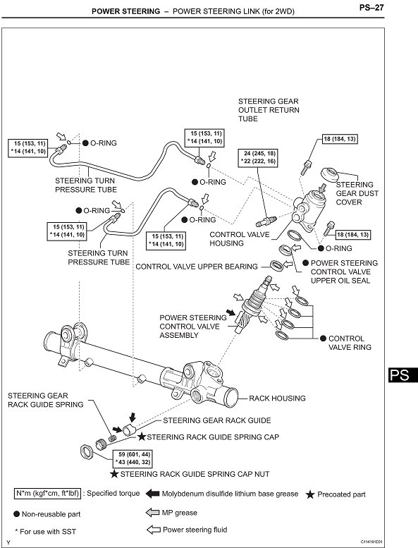

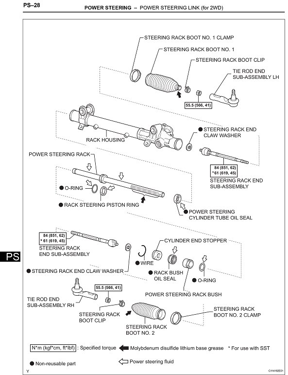

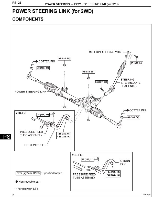

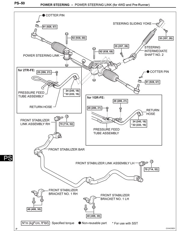

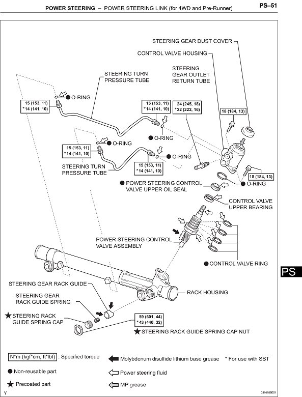

    POWER STEERING
    2WD
    4wd & Pre-Runner

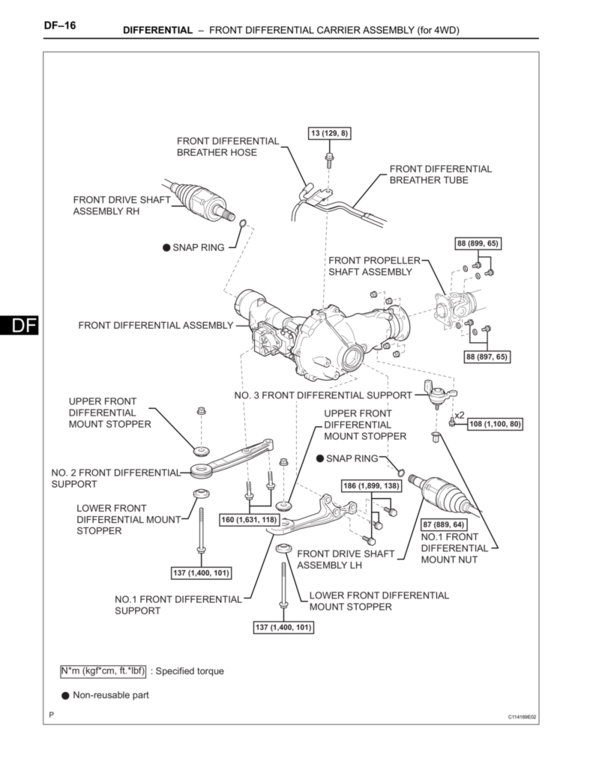

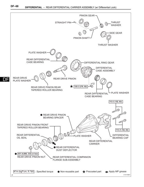

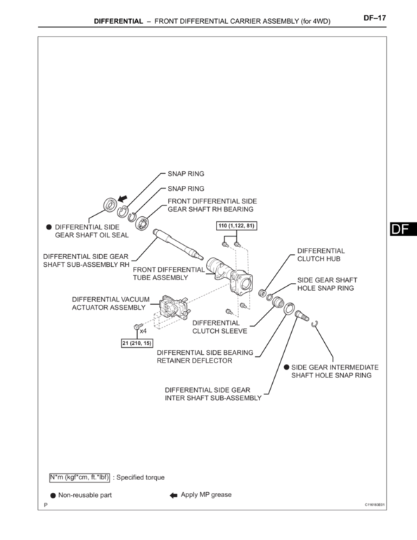

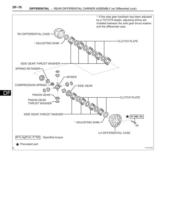

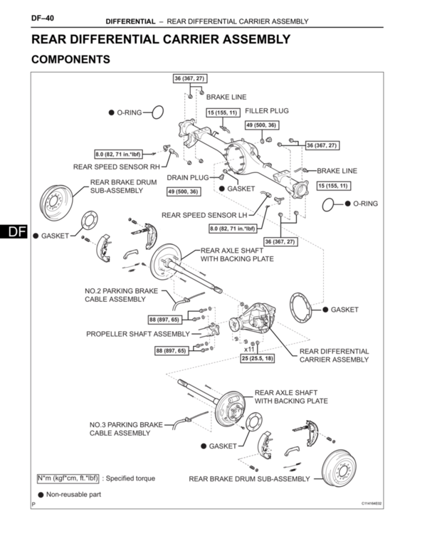

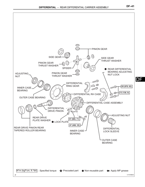

    DIFFERENTIAL
    Front Differential
    Rear Differential (non E-Locker)
    Rear Differential (E-Locker)
    Differential MASTER LIST

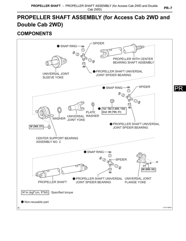

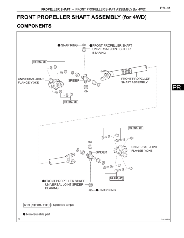

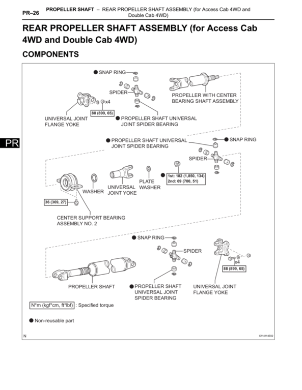

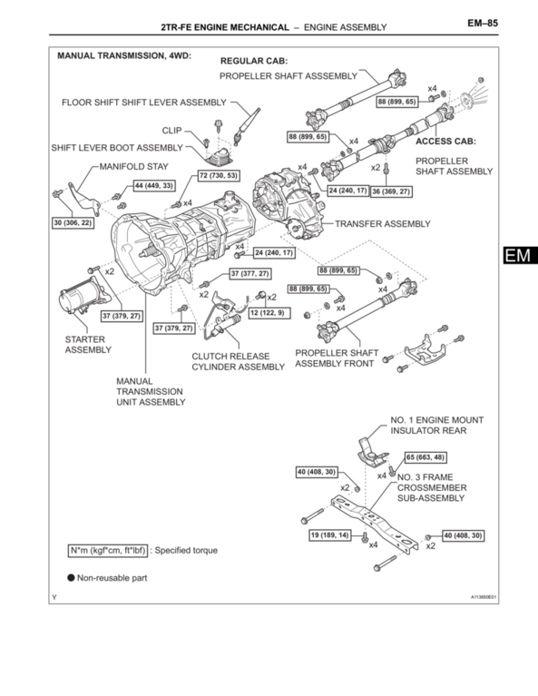

    DRIVELINE (Prop-Shaft)
    2wd Reg. Cab
    2wd Access Cab
    4wd Reg. Cab
    4wd Access Cab & Double Cab
    Front Driveline (4wd Only)
    Driveline MASTER LIST

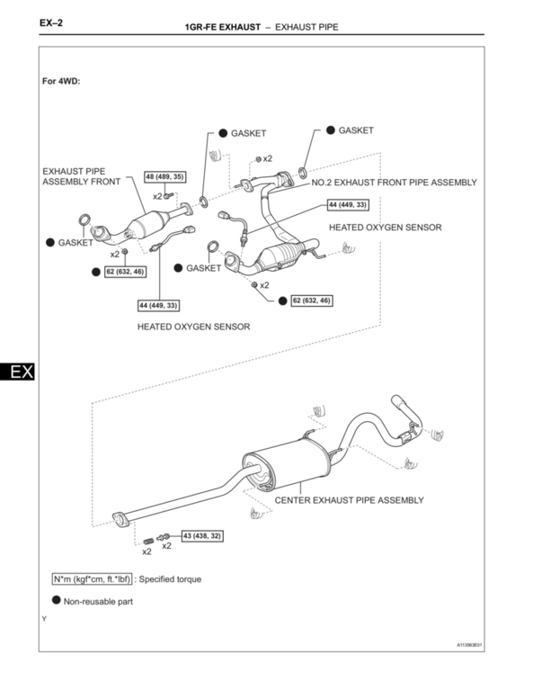

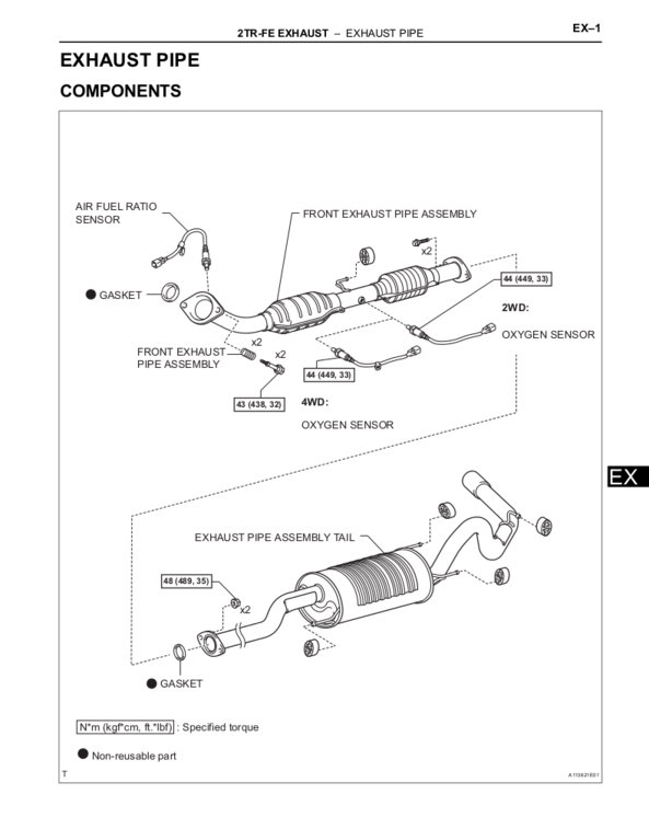

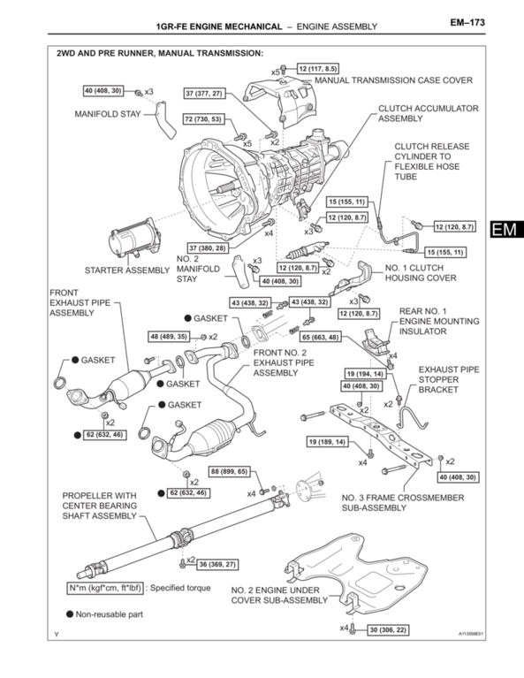

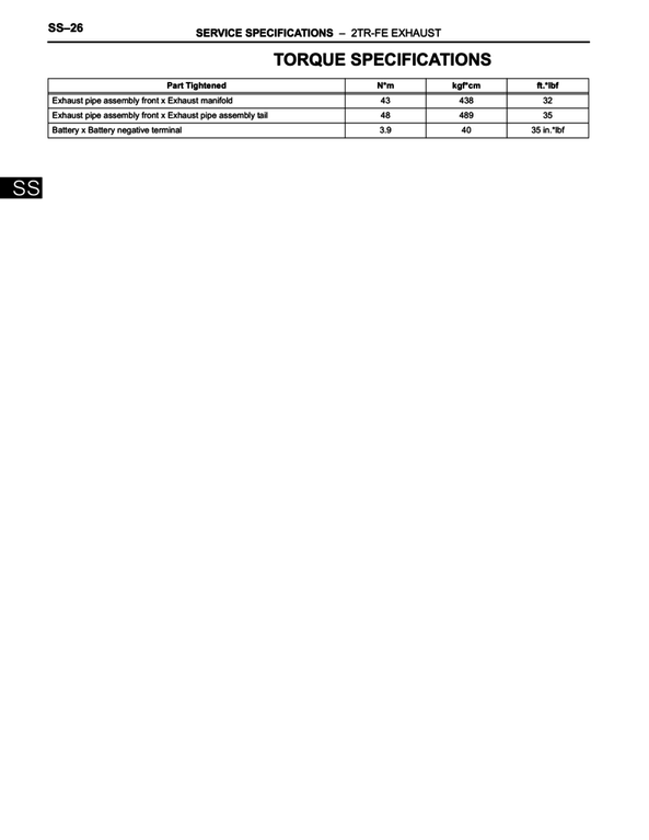

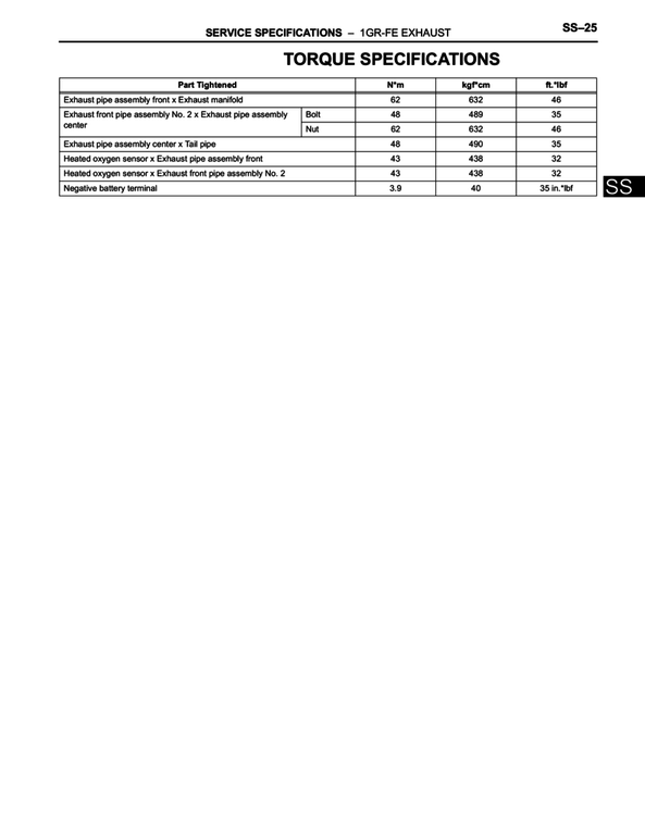

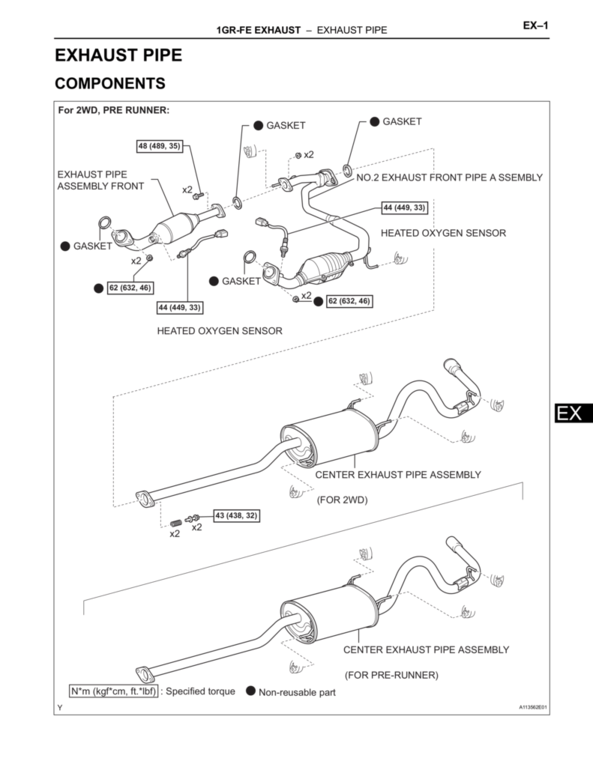

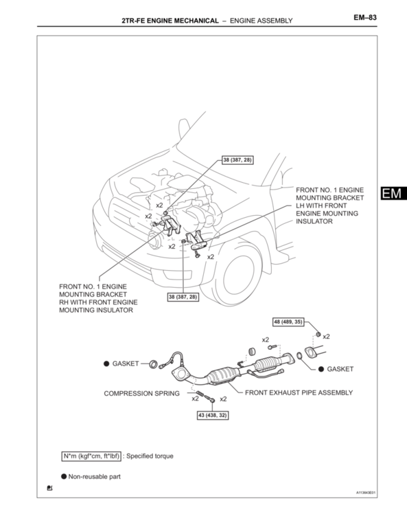

    EXHAUST
    2TR-FE
    2wd & Pre-Runner
    4wd
    Exhaust MASTER LIST
    4cyl
    V6

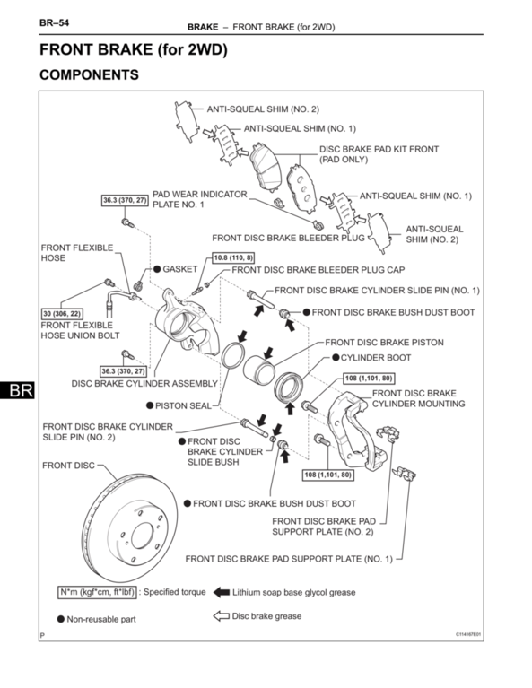

    BRAKES
    Front Brakes (2wd)
    Front Brakes (4wd & Pre-Runner)
    Rear Brakes
    Brakes MASTER LIST

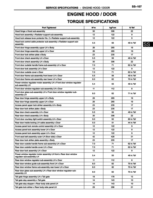

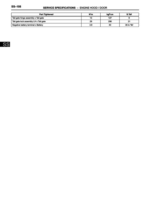

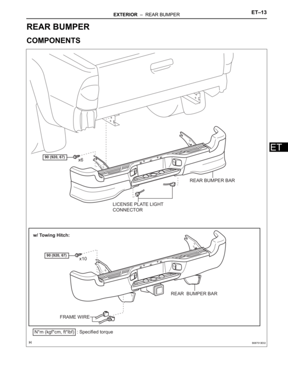

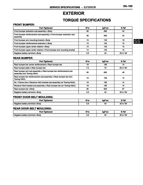

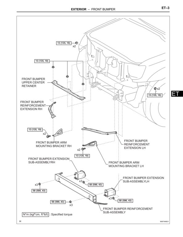

    EXTERIOR MISC.
    Exterior Misc. MASTER LIST

    TRANSFER CASE (4wd)

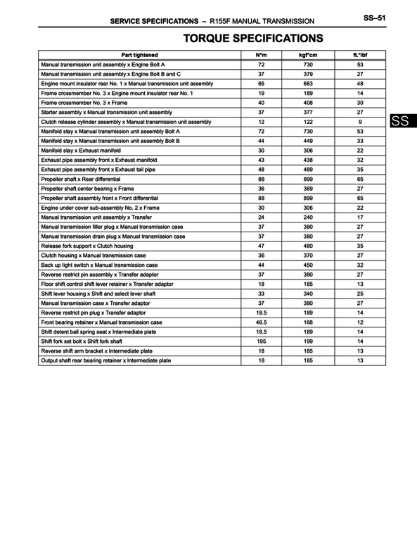

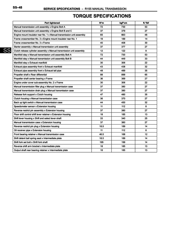

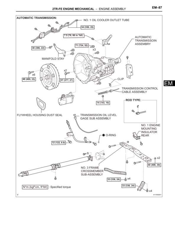

    Transmission (some Diagrams listed in the Engine section below)
    A340E
    A750E
    A750F
    R155
    R155F
    RA60
    RA60F

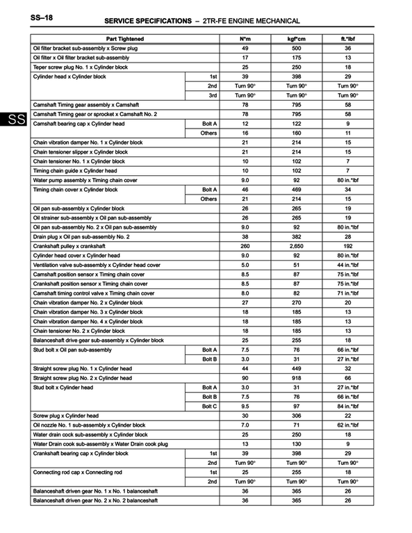

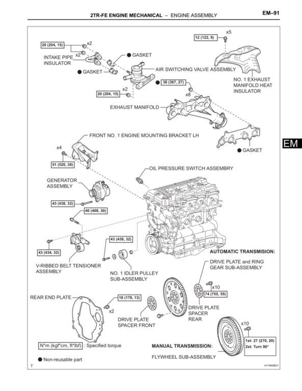

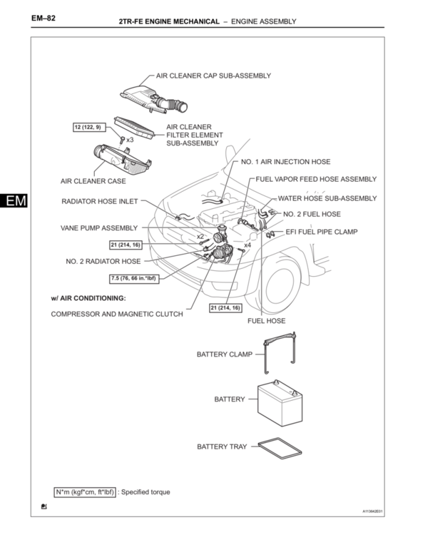

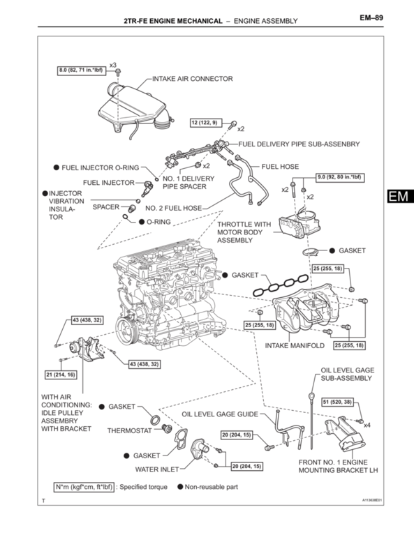

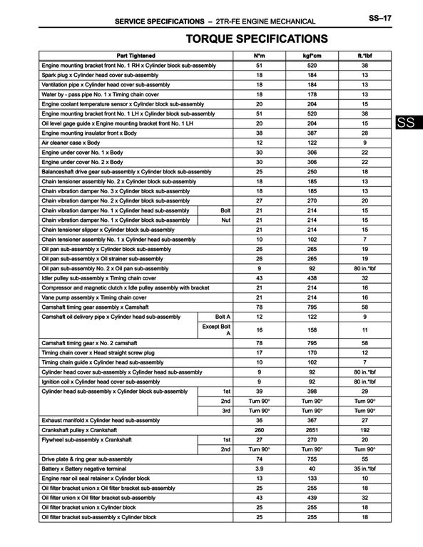

    2TR-FE Engine
    Main Assembly & Accys.
    Internal Assembly & Components
    2TR-FE MASTER LIST

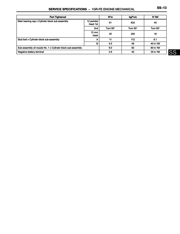

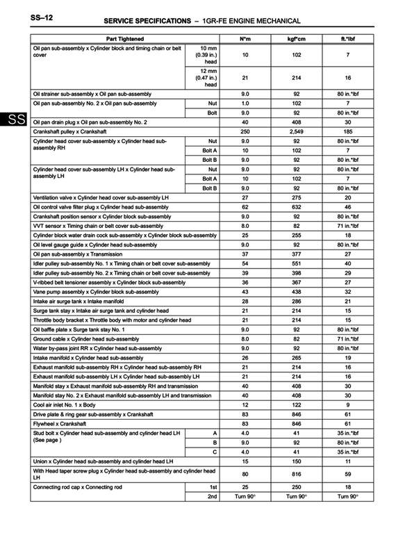

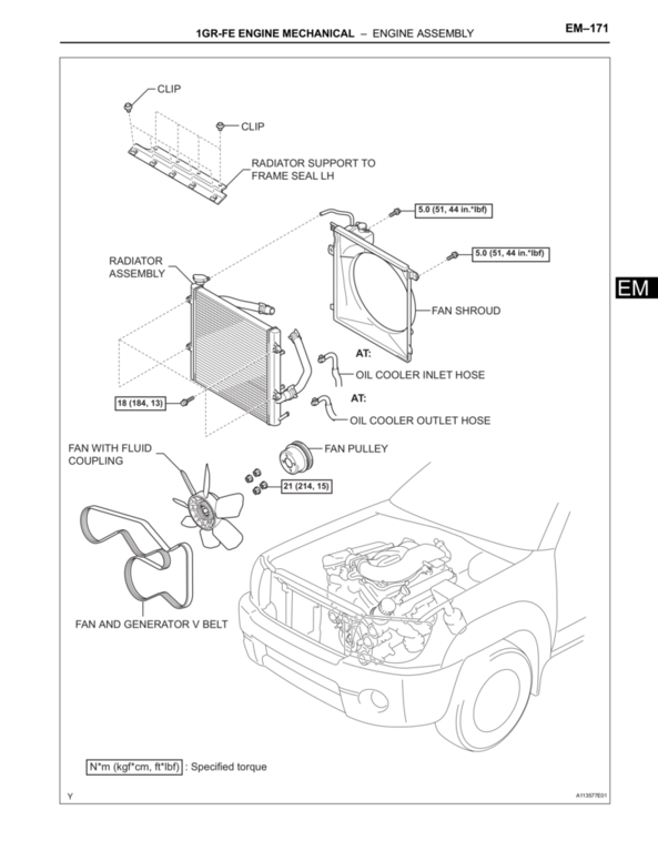

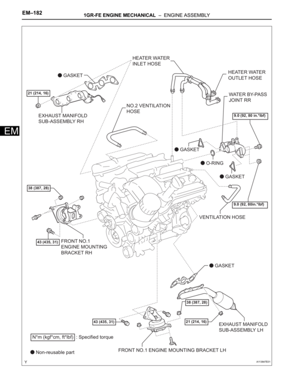

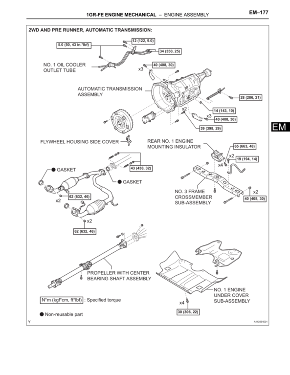

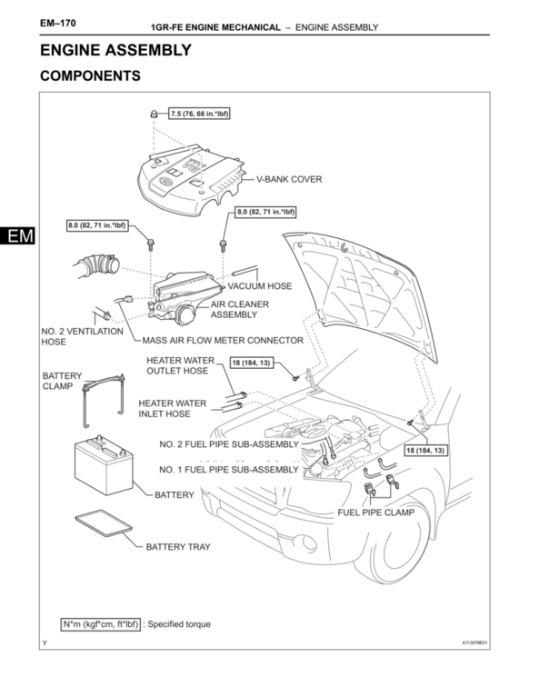

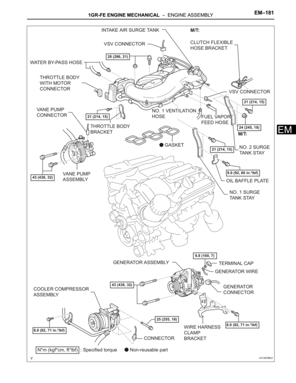

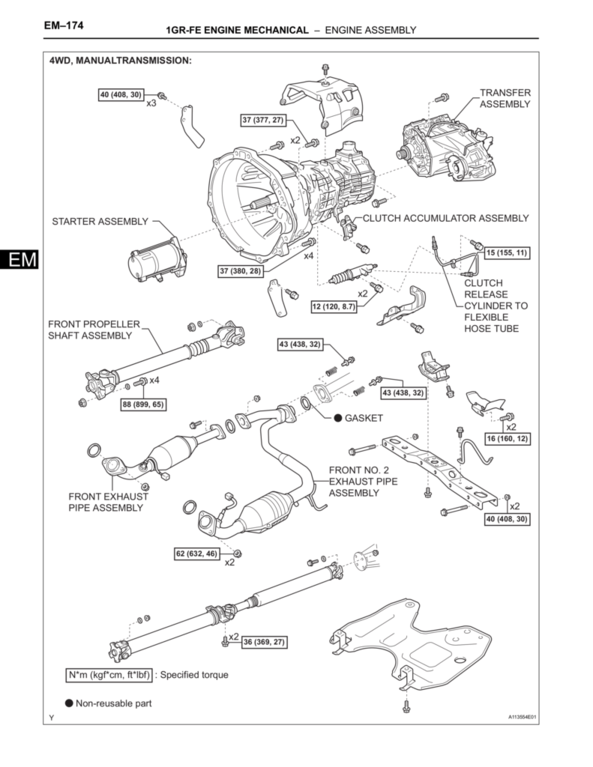

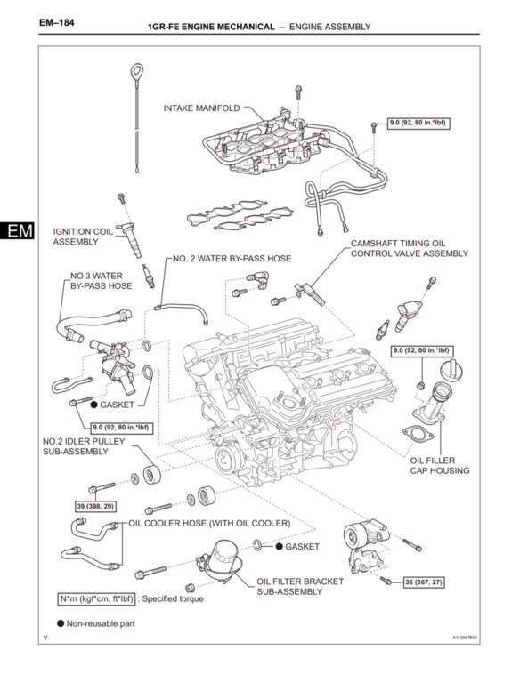

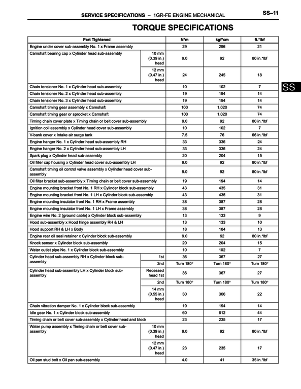

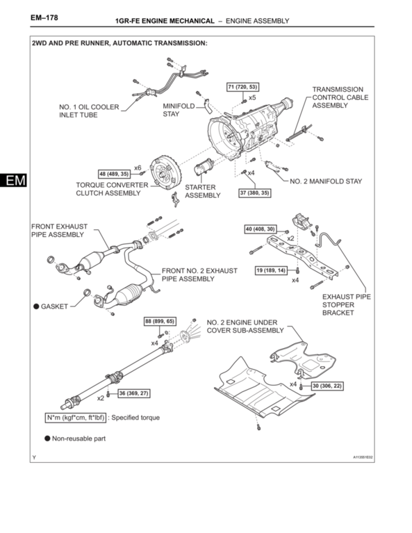

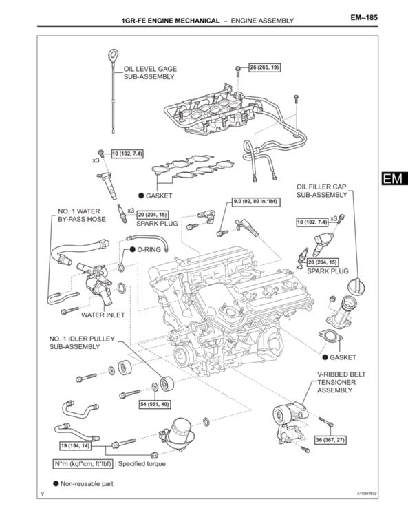

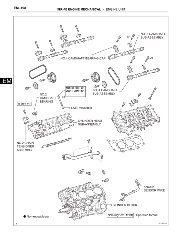

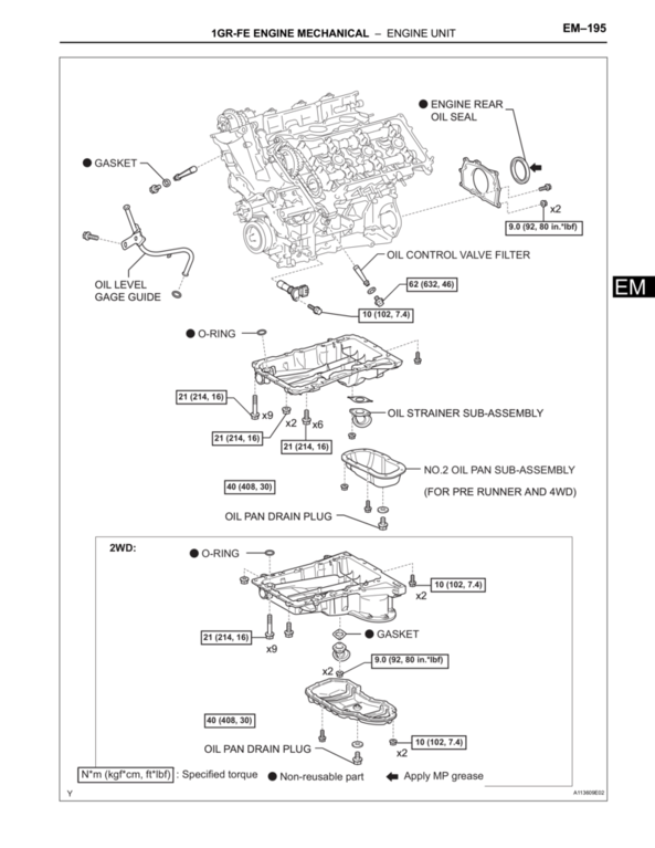

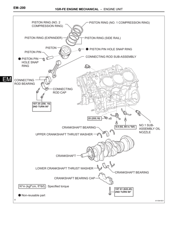

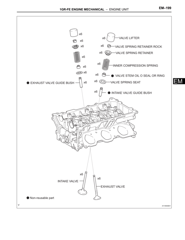

    1GR-FE Engine
    1GR-FE MASTER LIST

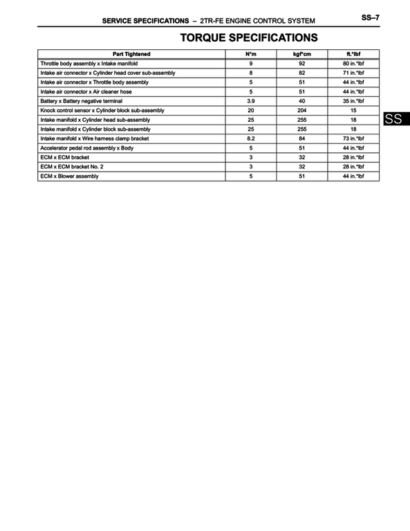

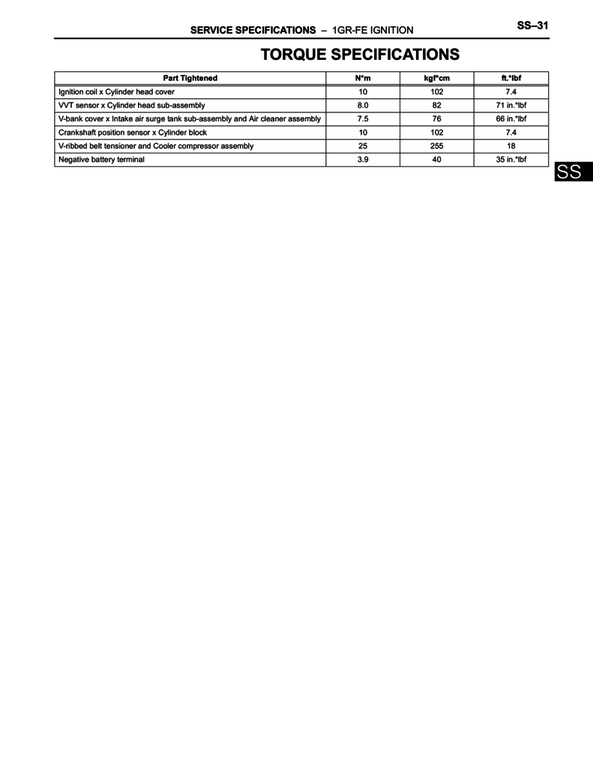

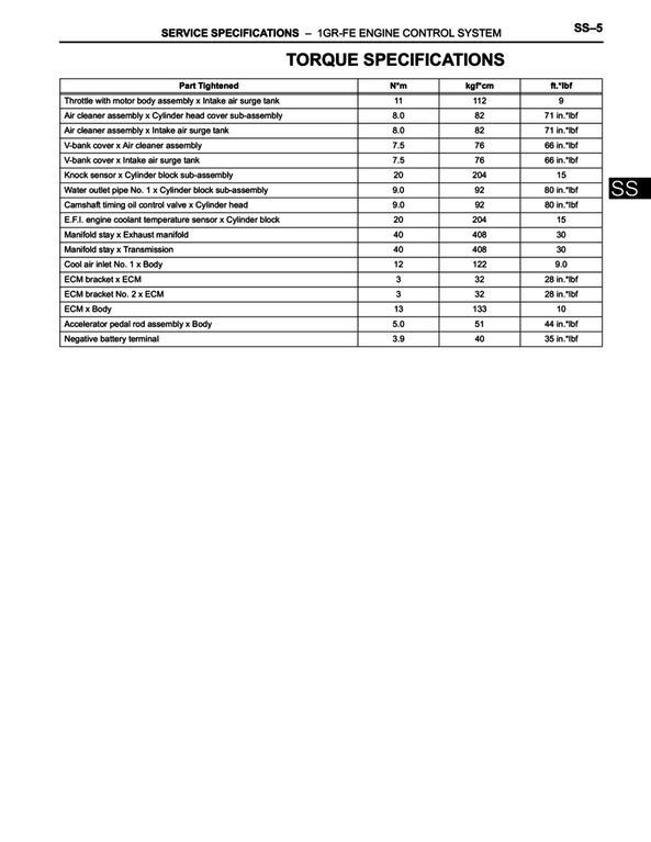

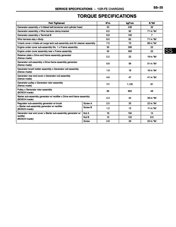

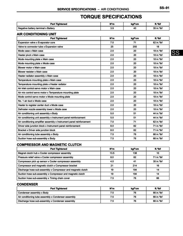

    ENGINE MISC.
    A/C System
    Charging System
    Cooling System
    Engine Control System
    Ignition System

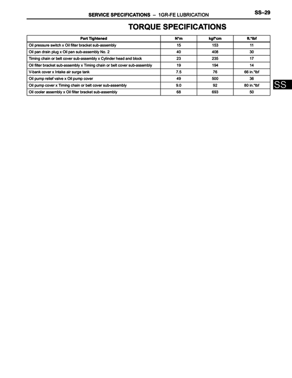

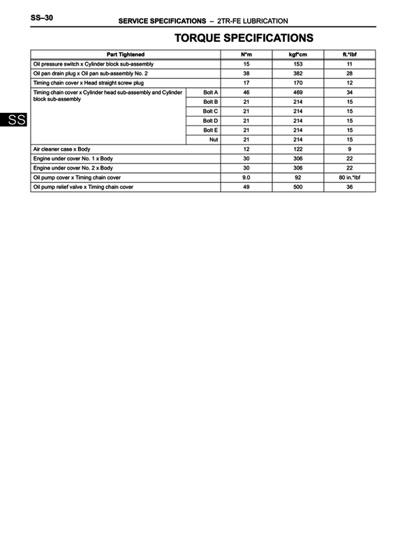

    Lubrication System

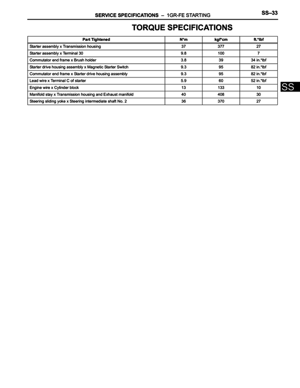

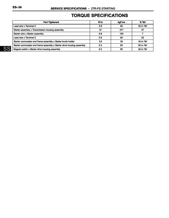

    Starting System

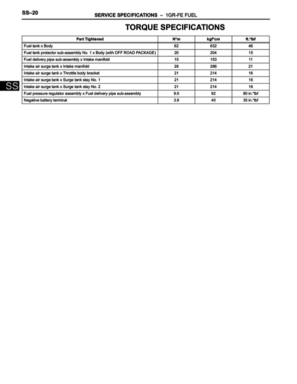

    MISC.
    Clutch
    2TR-FE Fuel
    1GR-FE Fuel
    Parking Brake

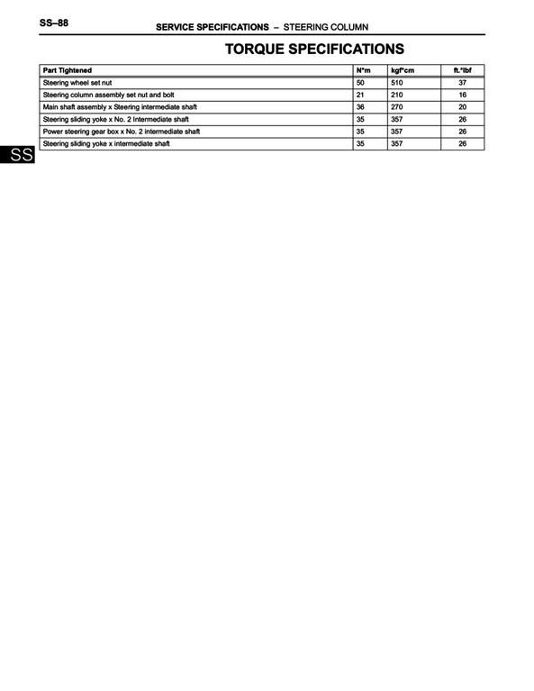

    Steering Column
    Tire & Wheel
