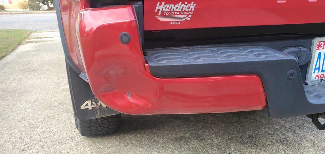

    got hit - rear right bumper cap broke off along with the end cap support behind it
    a lot of the clips are gone and bolts (i think)
    anyone able to tell me exactly how many clips / bolts ill need?
    i ordered the end cap + support already - just need to know how many bolts/clips ill need to get it all back together

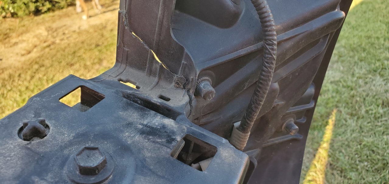

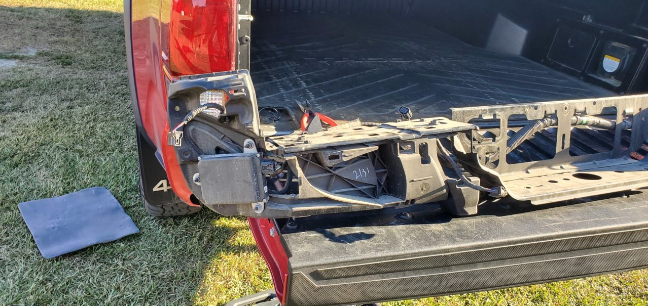

    Well that was an adventure. Took a year to finally get around to fixing the Christmas present I received last year but it's done. lol Got everything apart only to realize that the plastic end cap support was cracked as well. Ordered another one which won't be here until Friday so I gave the cracked support a liberal coat of JB Weld which seems to be holding up for the time being. No flashing lights on the dash for the parking sensors or BSM so *fingers crossed*. Btw for anyone looking for painted end caps at a good price, check out https://www.ebay.com/str/topickerautoparts.

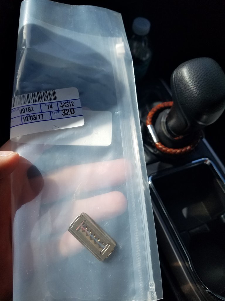

    Hey man, mind sharing part # for this metal clip? Have been looking everywhere but can't find it. Thanks in advance.

    I didn't even put mine back on. Got everything put back together and saw it sitting on the tailgate. doh :frusty: No issues without it though.
