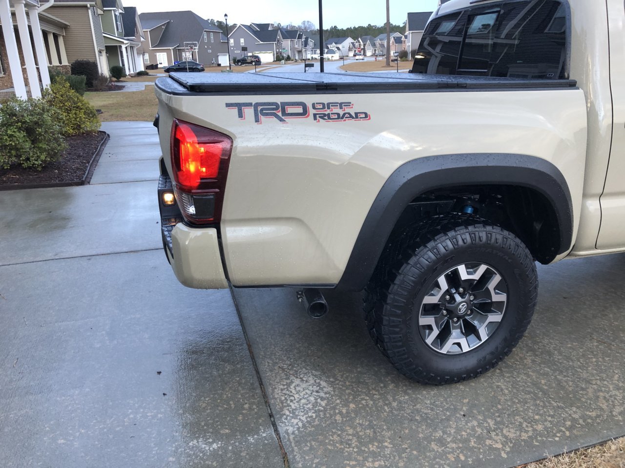

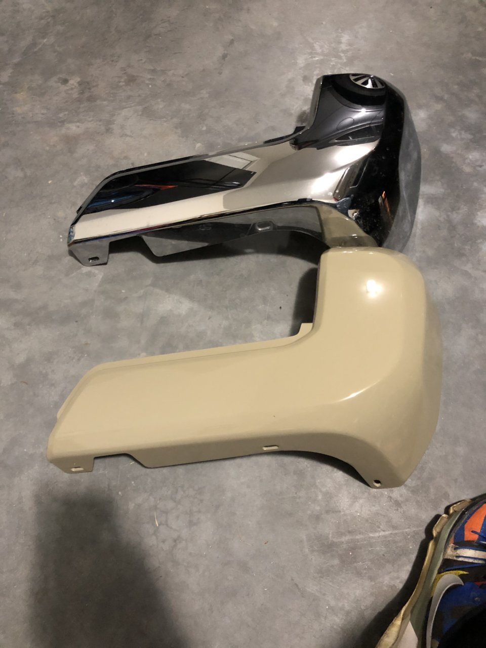

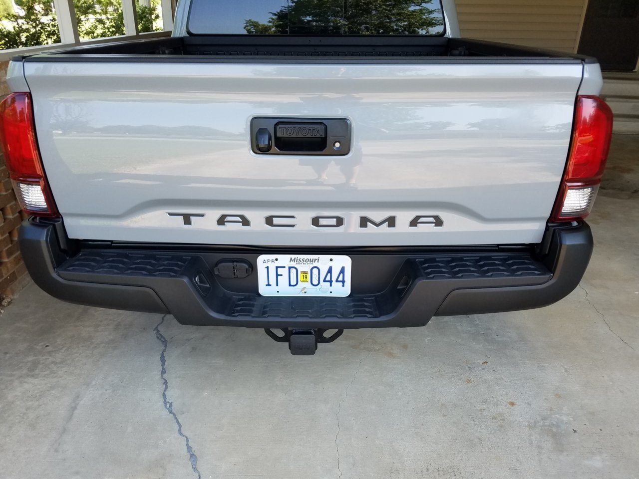

    Old thread, I know—but I swapped my chrome caps out for these ones from ebay and figured this would be a good place to show them and show thanks to @MetrickMetal for his SUPER HELPFUL writeup. It was easy, very little cursing required.
    I composited post #55 into a single image (can't upload a PDF here it seems) you can print if you're doing this and want to have this all handy without lots of checking your phone.

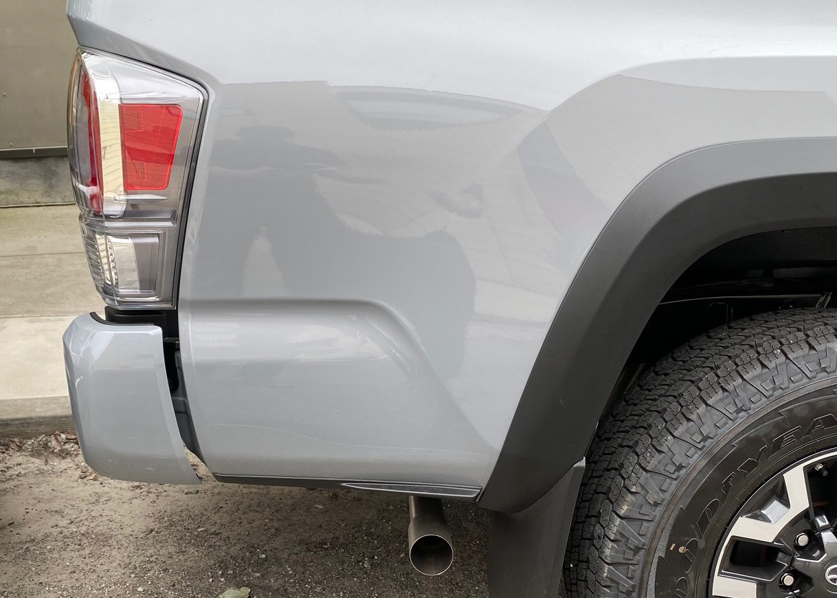

    Nice! A few days ago, I installed Quicksand bumper caps also purchased from eBay. The color match isn’t exact, but I’ve noticed color variation between bumper caps/fender flares and body panels on Tacomas from the factory. The chrome never sat well with me, so I’m pleased with the purchase and installation.
    https://www.ebay.com/itm/Painted-4V...ensor-Hole-For-Tacoma-2016-2020-/353197116692
    344751CB-B19A-4CD1-AB1C-FDCAB164EF2B.jpg DB5FF846-463C-4185-A149-A6F82D6780F0.jpg

    Thanks everyone. This thread was super helpful and allowed me to replace my busted up bumper cap for <$200 when the body shop quoted me $1400. A couple of observations:
    • The OEM Toyota part does have some texture on it. If you look closely at an original painted bumper cap on a Tacoma, you can see some of that texture is still visible. They just use a very heavy paint job to cover up most of it.
    • I bought the OEM part online for about $100 and some automotive paint on Amazon that's close to a perfect match. I'd recommend roughing up the plastic, spraying a layer of plastic adhesion promoter, 5-6 layers of the paint and 3 layers of clear coat. As mentioned above, that thickness seems to match the OEM paint job and doesn't have any impact on the blind spot monitor.
    • It is probably obvious to most, but if your existing cap is dented/busted up, you don't have to be quite as careful in removing it. You can pull hard on the top connection as well as the alligator clipped area. I don't think that you can break the alligator clip, and if you bend the teeth, you should be able to bend them back.
    • My car has the parking radar. You can take the existing cap of with the radar still connected to the wiring harness. There's plenty of play in the harness connecting it. Once the cap is off, you can unclip the radar unit from its wire connection (just a squeeze and a pull--although it may take you a bit to get the squeeze just right). It's not clear whether they've tweaked the design of the radar unit itself, but once it's unclipped from the harness, you can just push it out the hole in the cap. Push on the edge of the unit that would be closest to the license plate. There doesn't seem to be a two piece connector that you can take apart very easily. In fact, I broke one of the small tabs off my radar unit trying to take it apart (but it still works).
    • I didn't have to take the upper bumper step/cap off, but it was helpful to unclip it in the area next to the brake light as well as near the license plate. That provided just enough room to slide the new painted bumper cap back in after I had reinstalled/attached the parking sensor.
    • I didn't have any issues with the blind spot monitor. I didn't touch it at all (you don't need to unclip its harness, in fact on my truck the wiring for the BSM and the parking radar are zip tied together), and it works just fine.
    • It took a lot more effort than I thought to get the plastic bolt clips back into the holes. I didn't have to use a mallet, but I almost went for it. I did have to use a pliers to smash back down the expandable part of the bolts to get them to go back into the holes.
    • I used two-sided tape to get the alligator clip back on. It's not easy. I adhered it to the tip of my index finger and then fished around until I finally got it on the plastic protrusion. It's very tight getting your finger in there. It probably took me 10 tries, so be patient.

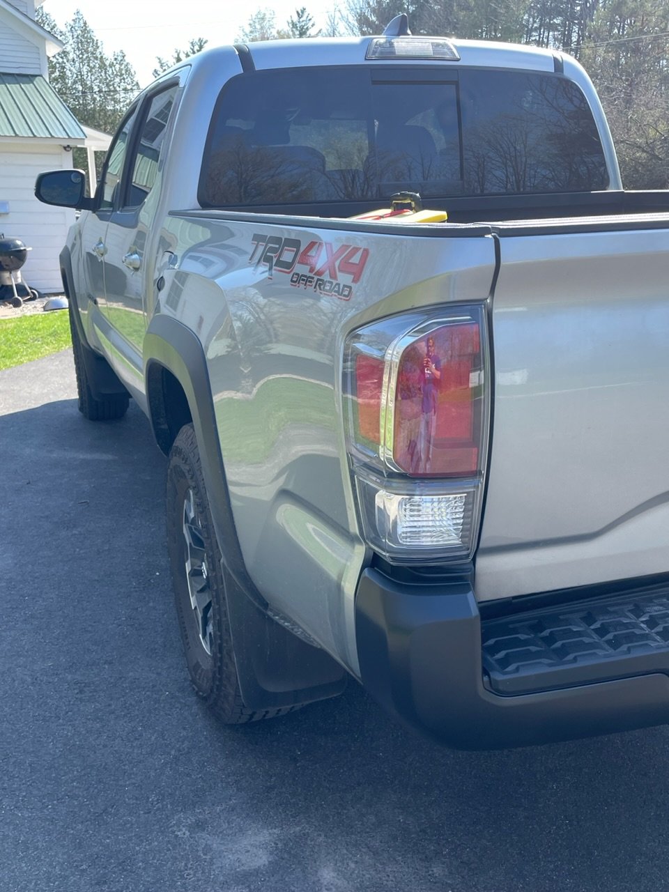

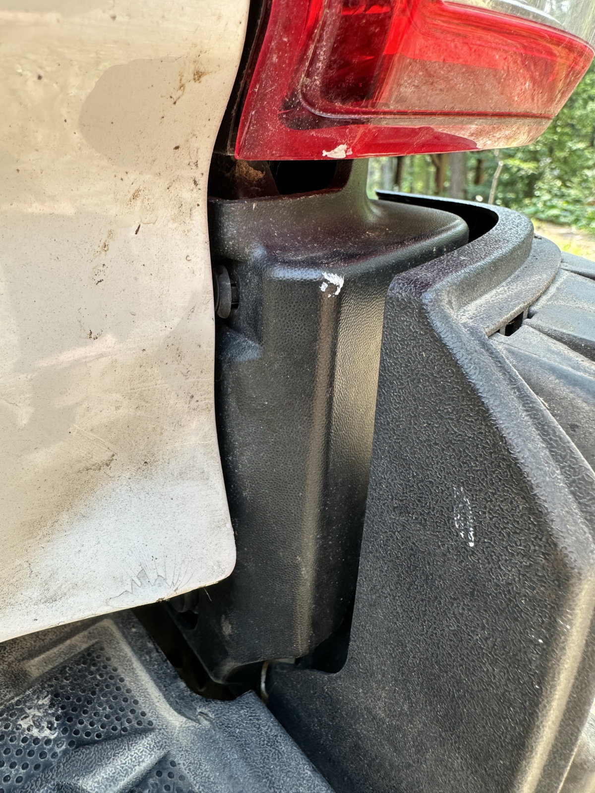

    There is a plastic part under the tail light and behind the bumper that I can't seem to find anywhere. Has anyone figured out how to replace it?
