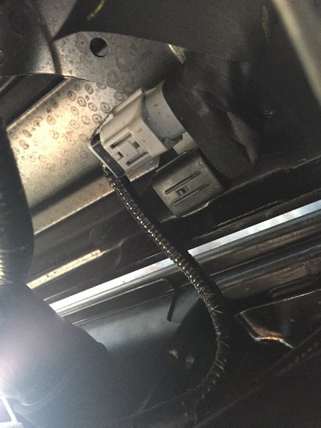

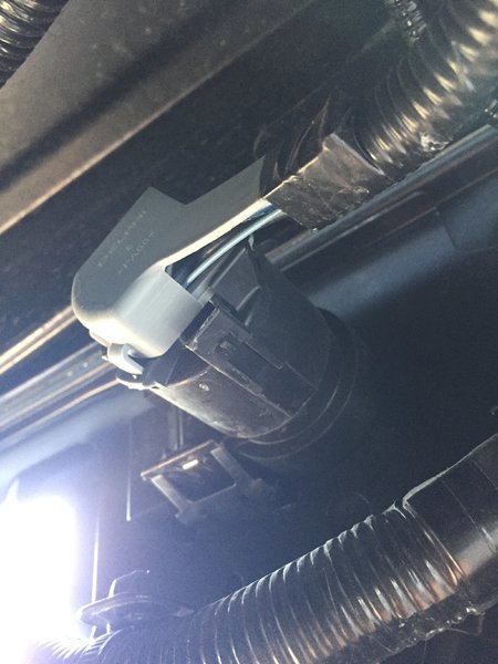

    On number 3. It says to disconnect the wiring connector from the socket. Is this the wiring connector???

    No, the trailer wiring if you have tow package. It plugs into the back of the 7 pin connector

    This thingy?

    Yes

    Yeah I managed to pop it out of its socket but I can't seem to disconnect it.

    Push the connector in like your plugging it in, when you have it as forward as possible press the release tab and then pull back to take it off. That should work

    So you're saying to press the steel tabs and pull it back instead of pressing forward?

    No. Push the connector in, then press the release tab and pull the connector off
