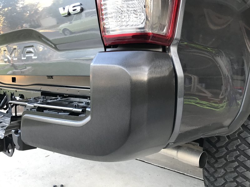

    MetrickMetal,
    Thanks for the write up. You saved me a lot of time and hassle.
    I was rear ended in a drive thru by some dumb ass lady on her cell phone. Needless to say she got out with it in her hand.
    Nothing happened but a few scratches on the chrome.
    I wrapped mine in Black Brushed Steel.

    wait how the hell.... ? that's awesome

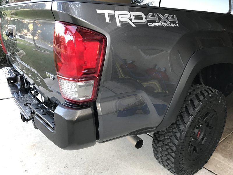

    LOL thanks. the hardest part was wrapping them. I wrap pretty good, but for some reason they were difficult to handle. I took mine off completely.

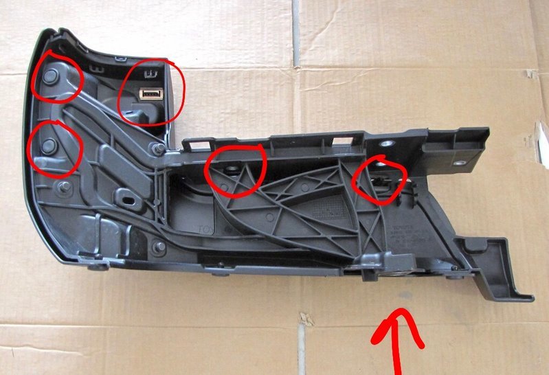

    Okay... what's the secret to getting the chrome end caps off? Everything else was relatively easy, but I could not get the alligator clip to release. There are also two chrome "fingers" along the top of each cap that seem to be holding-on. After two hours, I finally gave up. Any insight will be greatly appreciated.

    I used a cotter pin removal tool to slide under the clip and pry it free. Once it's released you can depress the other two chrome tabs w a flat blade screwdriver along w the two pop clips on the outer edge. Voila

    Thanks. How did you get the clip? I can't find it; I only know it's there from reading other posts.

    The clip is a rectangular metal piece that has teeth. It's circled in the top left hand corner. Use a pick or cotter pin removal tool and slide it under the metal between the black plastic and chrome tab. Pull upward, but pull slowly w pressure. Alternate sides as you pry it up. The other circles areas have pop retainers pins and tabs to depress and pop open. The arrow shows where two bolts hold the cap assembly to the rebar.
