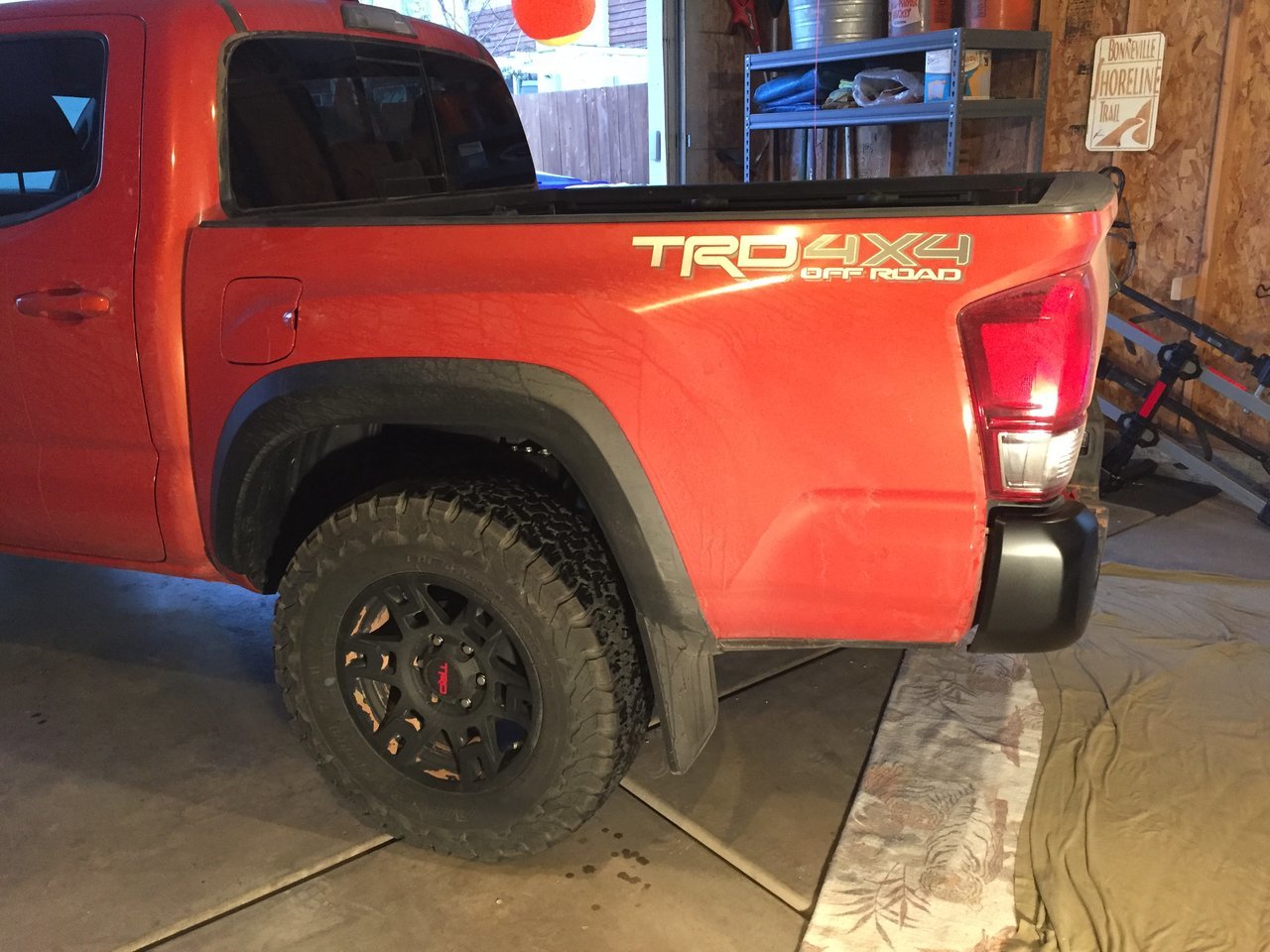

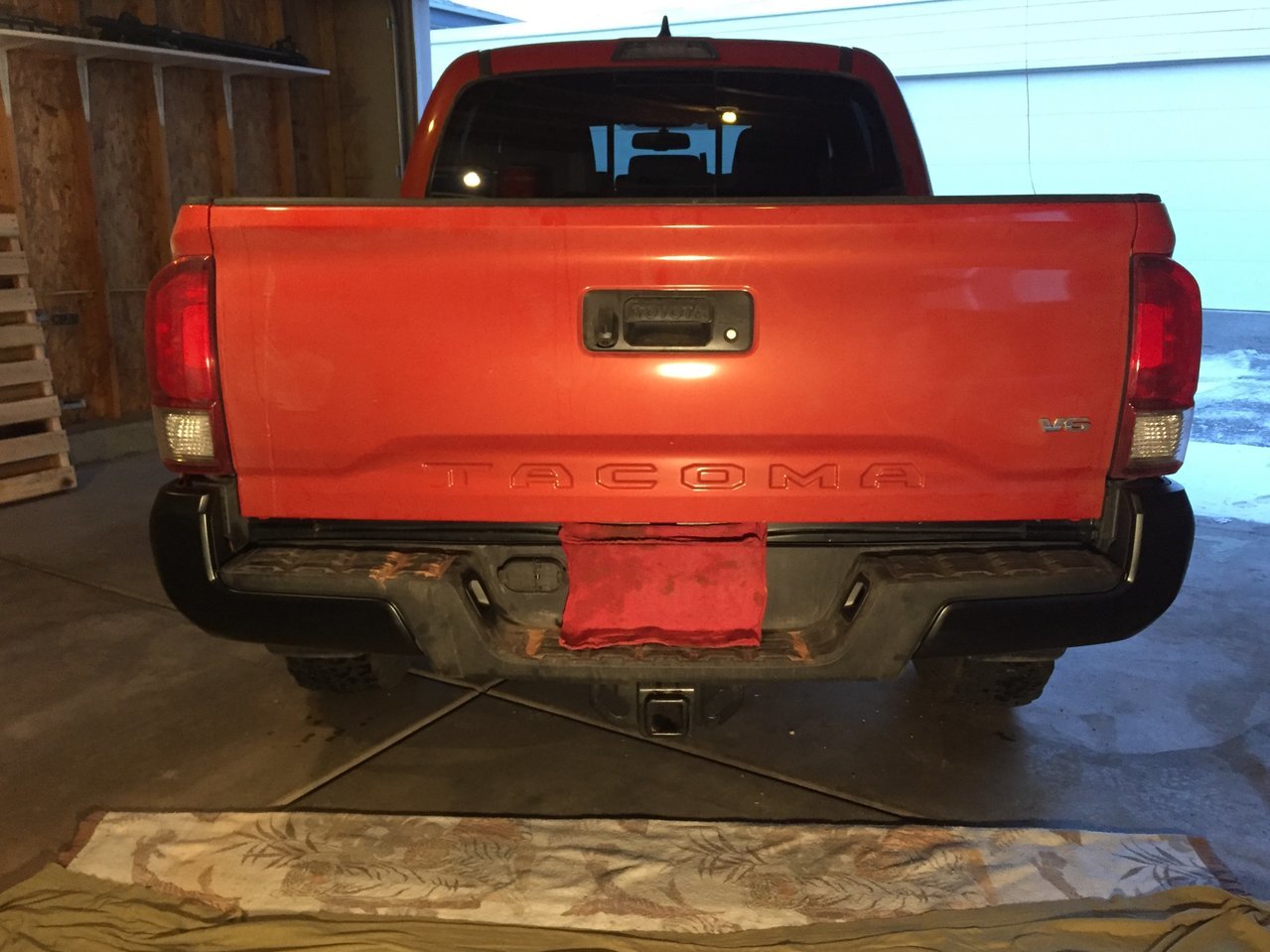

  19. Jan 14, 2018 at 12:52 PM
    #179
    OrangeJulius
    OrangeJulius Well-Known Member
    Aug 31, 2017
    #228722
    348
    2017 Orange TRD off-road WIP
    Anyone in the DFW get this done and want a case of beer to do mine?? Lol. For the life of me, I can't get my hand in there too remove the license plate lights. I don't have huge hands but I can't get in there with the tow hitch in the way.
    Got it done finally. Took some long long nose pliers to get the license plate lights out. Once I got past that it was fairly smooth sailing.
  20. Jan 14, 2018 at 3:19 PM
    #180
    boynoyce
    boynoyce .
    Feb 23, 2016
    #179183
    6,228
    16SR5AC4X4V6QS
    Don't remove the entire bumper, just the plastic end caps. It is relatively easy.
