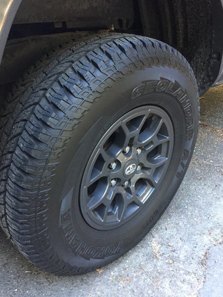

    I have the Geolanders in a 265/75/r16 and I'm pleased. It's my commuter as well as fun truck and I've great luck with them in sand and rock gardens. Can't report on thick mud. Well behaved and quiet on road. Also a snow rated tire which is great. Not too pricey either. Much better than stocks on the sr5 i got and still a good step up from that wrangler what comes on TRD's. I don't usually talk trash on TRD's but I don't think it's out of bounds to say those tires aren't that well recieved.

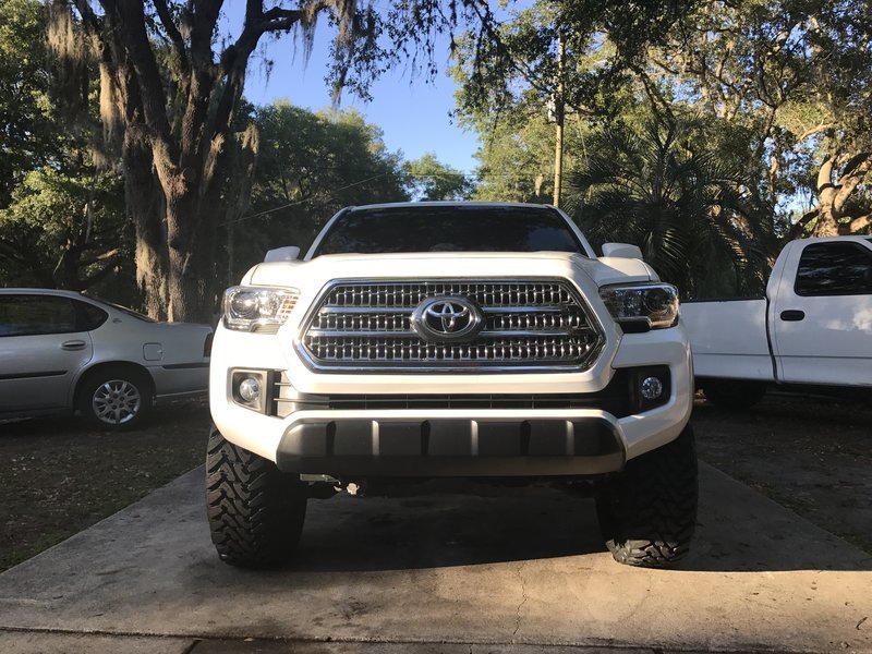

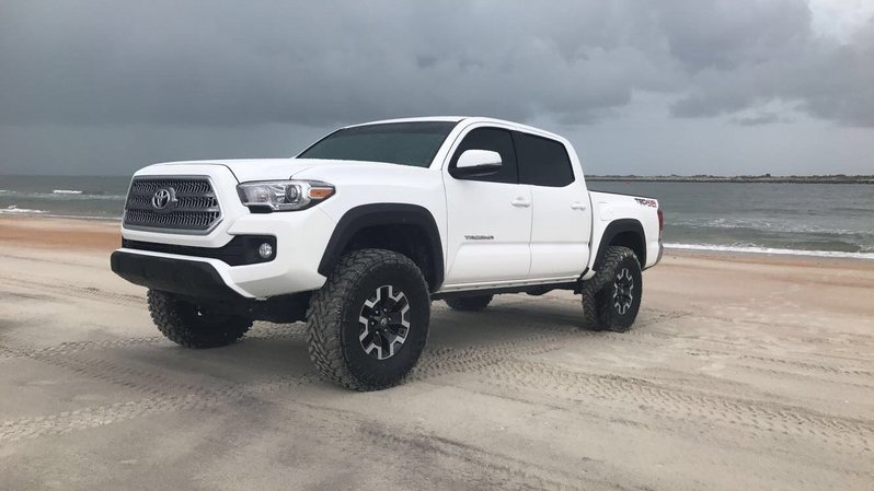

    IMG_0579.jpg IMG_0600.jpg I have a 16 TRD OR, I put a 2" leveling kit on and upgraded tires to 285-75-R16 Toyo mt/s. At first rubbed on upper control arms when turning and with the wheel straight was dangerously close to them. Put 1.25" wheel spacers on, solves everything but will rub slightly when weighed down on plastic liner.

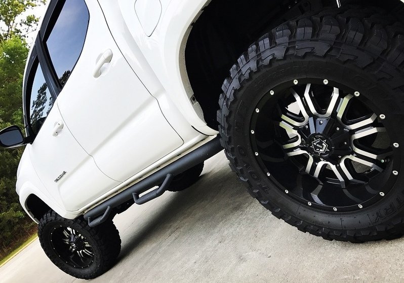

    I run 35x12.50x20's, -19 offset, with a 6" Rough Country lift ... I still have some rub in reverse mainly.

    So the wheel spacers didn't actually solve everything. Still need to re-mold or trim plastic.
