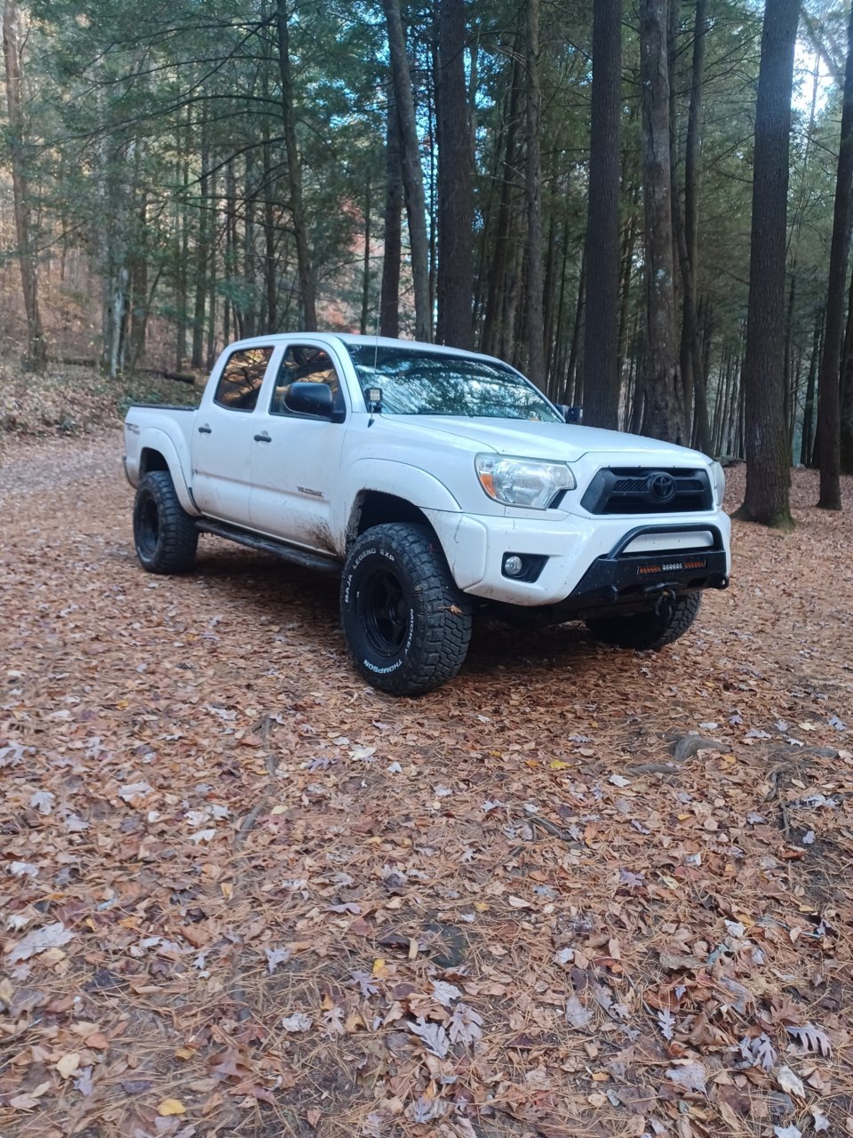

    These are 16 inch wheels from FN wheels. I knew I wanted to a 255 or 285 size tire and I looked at tons of them on a 16 vs 17 inch wheel and I completely prefer the look of the 16 inch wheel in every situation. The only reason I'd choose a 17 inch is if I wanted a 285 70 17 in a SL load range for a softer ride. You can't get a 285 or a 255 in a SL load on a 16 inch wheel. As of fitting any wheel that is hub centric to the toyota was designed to fit the toyota. Be that FN wheels, scs, or OEM wheels. Other brands I don't know about. But lots of people use 16 inch methods, black rhino, etc with no problems.
