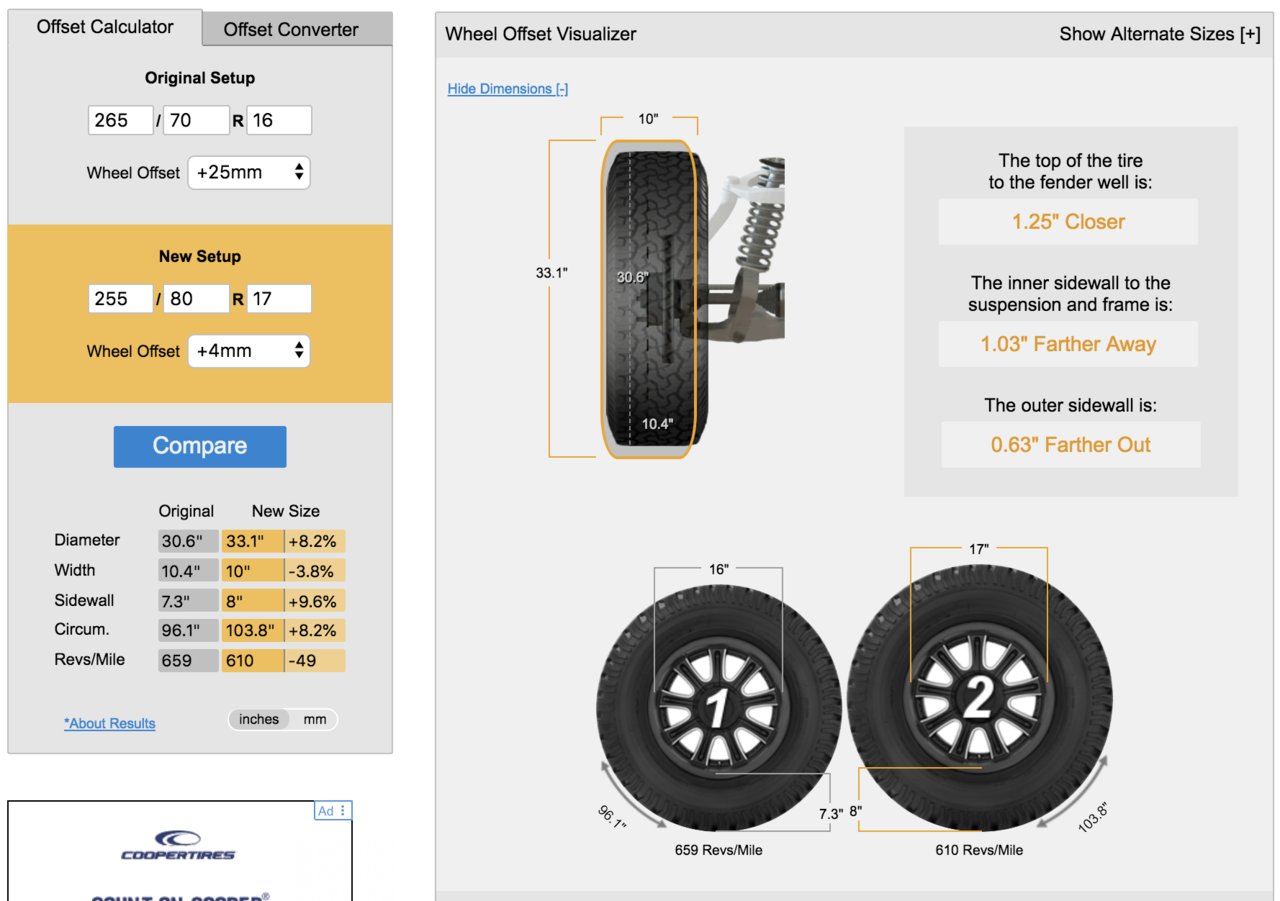

    Hello TW Community, I've been scouring the forum up and down and have been able to surmise that 255/85/16 likely work with no/little rubbing with OEM Off Road wheels and stock suspension on a 2018 DCLB Off Road.
    Curious if anyone has any experience going to a 17" TRD Pro SEMA wheels with a 255/80/17 while keeping stock suspension on their Off Road?
    Per the tiresize.com wheel offset calculator, things look promising, but I'm curious if the difference in the two different wheel offsets create issues?
    16" Off Road wheel offset +25mm
    17" TRD SEMA wheel offset +4mm
    My goal: With stock suspension on my OR DCLB install 17" TRD SEMA wheels with 255/80/17 Falken Wildpeak AT3W
    Thoughts? Experience? Link to confirmation of this somewhere already on TW or somwhere else on the internets?
    Thanks... J

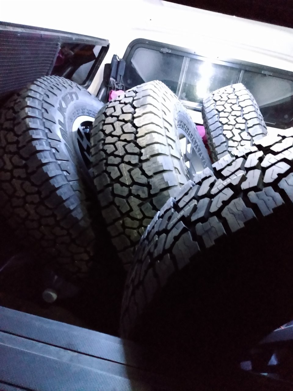

    Just bought sema 17s, and had fallen AT3s 255/80. mounted I drive a DCLB OR 18. Bolting up tommorow . Pep boys said they are not allowed to put them on the truck
