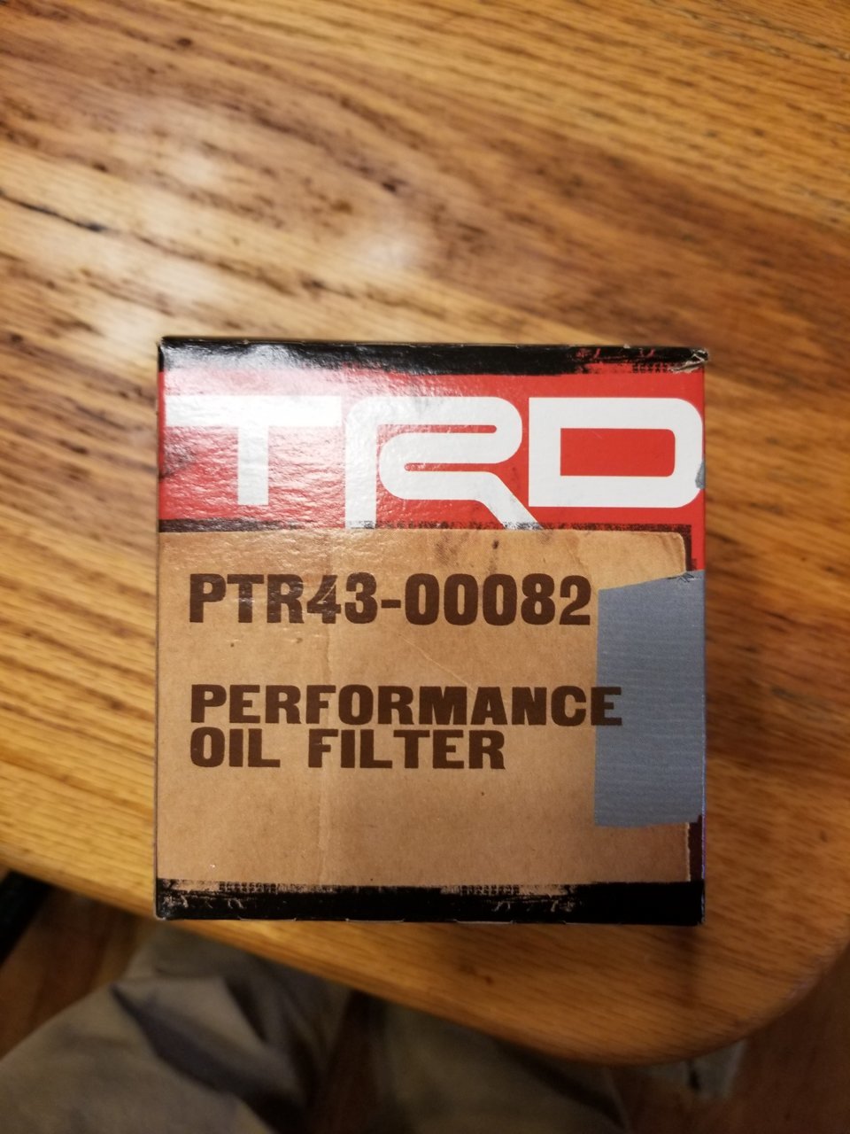

    Both will work.
    04152-YZZA1 is a OEM part.
    PTR43-00082 is a TRD part.

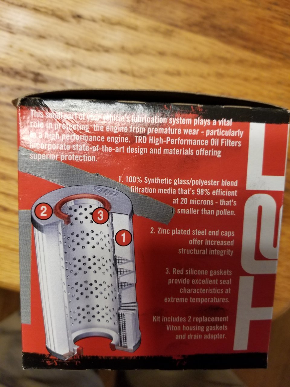

    The pro filter stops 98%
    The cheap stops 55% that should answer spend money now so you don't have to later

    The TRD filter is supposedly made by Champion and is basically the same as the Amsoil and Royal Purple filters; also made by Champion. I think it's 20 micron filtration. It's been a several years since I researched it, though.

    15475848884011183923587623521224.jpg 15475849467127852747709314277970.jpg 98% efficiency at 20 microns
