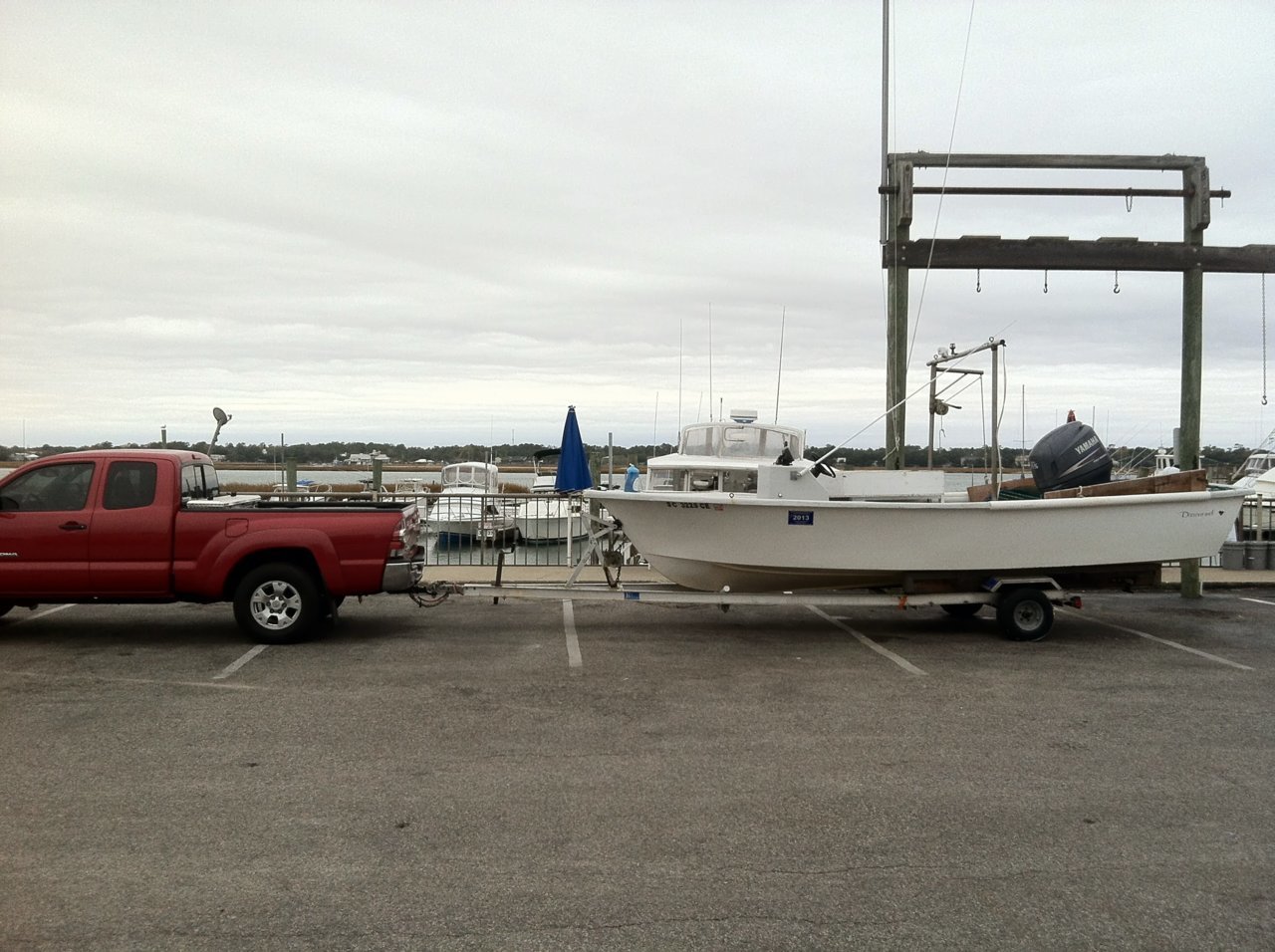

    Duplex Application 554.jpg Ease into it and you'll be fine. That's not much weight. My 4cyl would do fine pulling boats up the ramp. Easing into is key. Spinning out isn't beneficial so again just ease into it. I pulled this thing up loaded with a couple hundred pounds of ice and shrimp a bunch of times and never had a problem. If you're worried about it try backing in and pulling out when you know someone is around that can hook up to you and help out if need be. You should be fine though.
