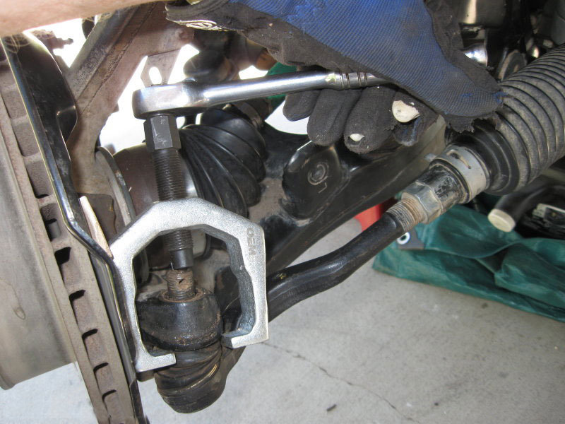

    One more question: The last time I removed a tie rod end I used one of the U-shaped removers that I bought at OReilly. I couldn't get the thing to seat correctly because of the brake shield so I took it back for a return (and then used another method). When you removed your tie rod ends, did you use the OTC tool or one of the cheaper ones from the local car parts store?
    OTC Tool:
    Some of the cheaper ones:
    That one ^^ didn't work. It got the ball joint separated but broke the ball joint stud.
    This one I could not fit well enough to get the pusher bolt centered over the ball joint bolt. ​

    Don't know what to tell you... I just changed my outers 2 weeks ago with a puller like the bottom pic. $12 At harbor freight... Didn't have a problem

    I've used that OTC tool for tie rods, upper, and lower bj and it is so much nicer than the classic square pitman pullers. I bought this kit off Amazon that had the same basic pullers as the otc kit

    Looks like it's got enough contact to pop it loose even though it's not centered

    Just push it hard onto the tie rod end, let the Brake shield bend a little. Then just bend it back when you've installed the new tie rod end

    The Pitman puller in the last pic will still work, doesn't have to be 100% centered over the bolt. Start tightening it down and as long as it's on there well enough not to slip off, it'll pop the ball joint out

    You might try that puller with the nut screwed partially on and the puller tip might seat inside the nut.

    the puller is used to put downward pressure on the taper of the stud, the impact from the hammer on the side of the joint is what frees it.
    In addition, leave the nut on the joint for 2 reasons... if you mar the threads so bad in a failed attempt to remove the joint you can retighten the nut and still drive until you can make a second attempt or take it somewhere. The second reason is that if the tapered joint assembly is attached to heavy bit, it will fall and could drop on your foot, toe, leg etc.
