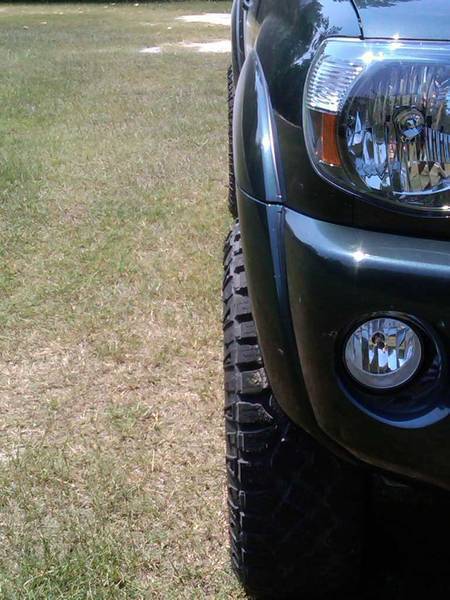

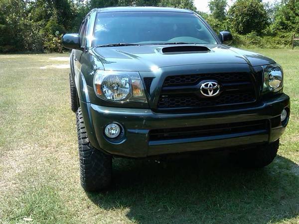

    I went with the 8 inch because I went with 265's--I read on here (or somewhere) that 9 inch wheels were too wide for 265's.
    Anyways, the 8's worked out really good and I like the stance, my tires are just outside the edge of my fenders:

    that looks really good! i like that look. so that's 17x8 with 4.5" BS?

    Yea.

    Are you on stock suspension, I will be installing some 17x8 Pro Comp steelies with a 4.5" backspace but had to get some 1.25" spacers to avoid rubbing.

    No, I've got 5100's set to 1.75 in front and TSB springs in rear. And I still got a slight rub on the right side when I'm fully locked to the left.
