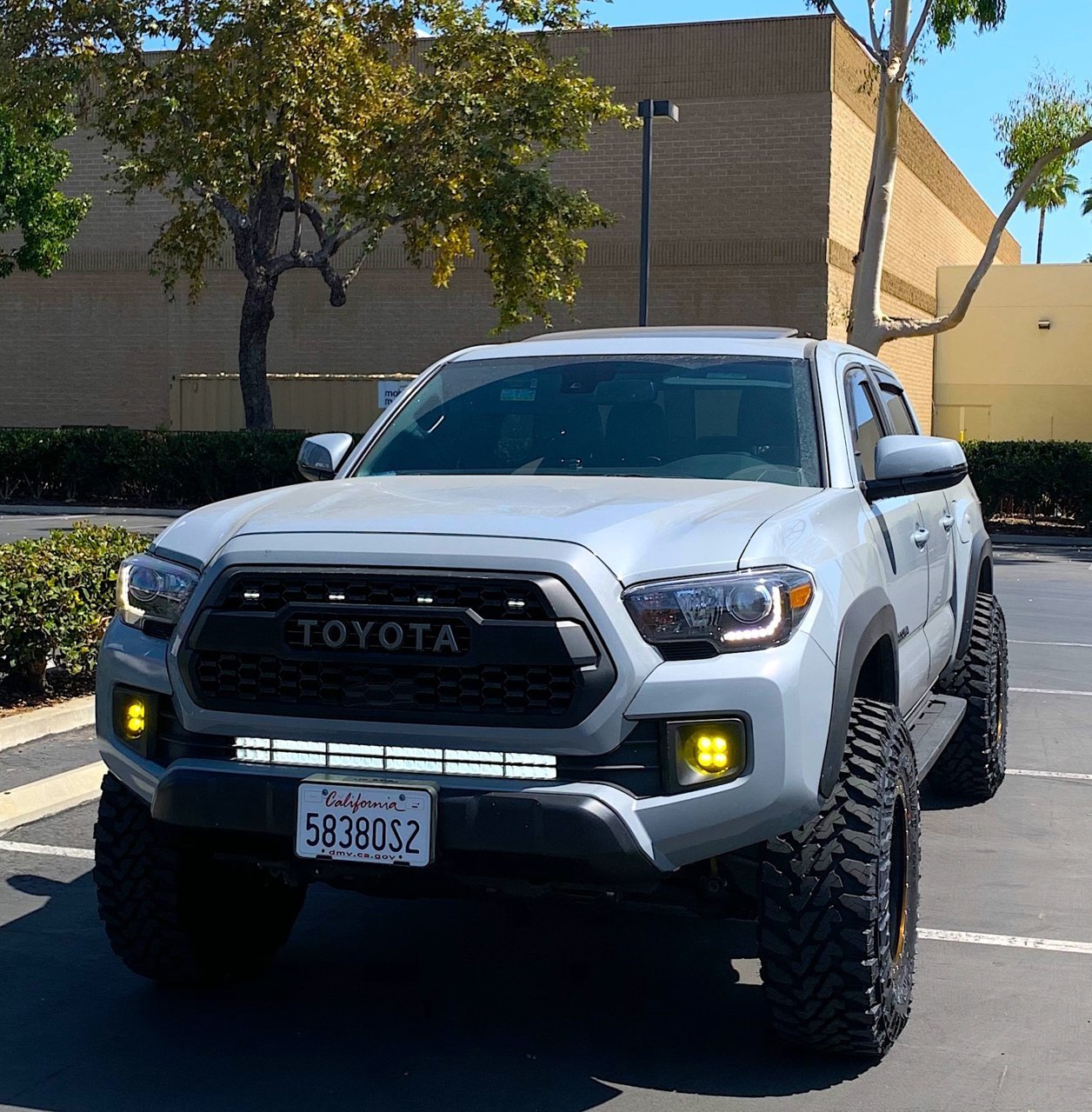

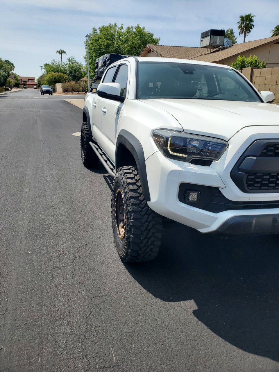

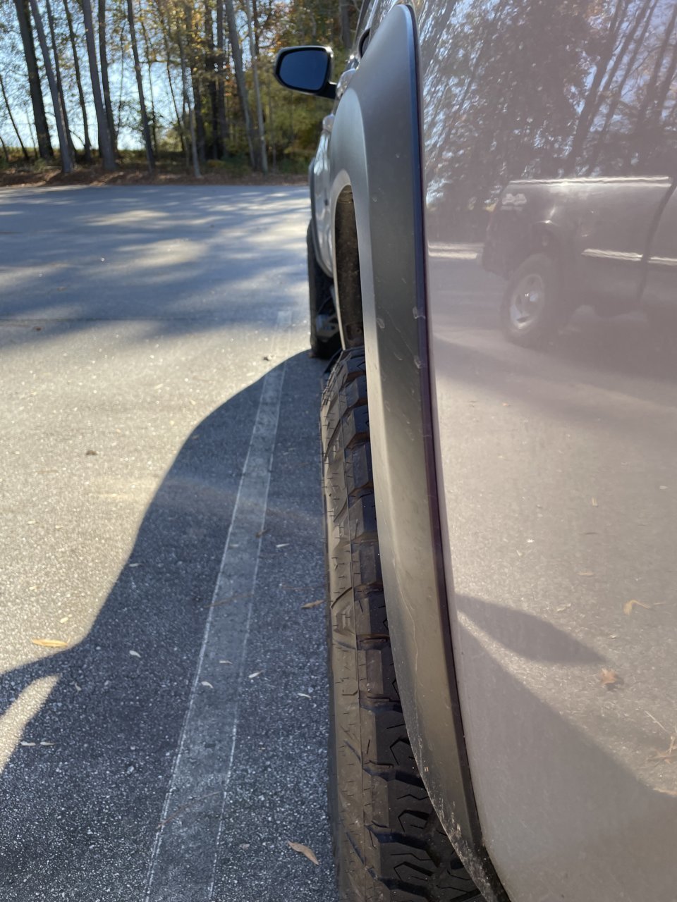

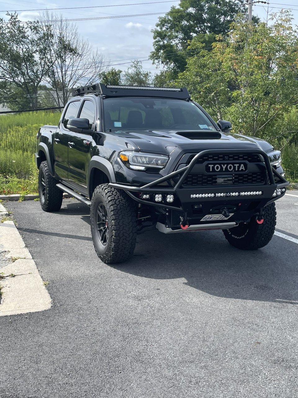

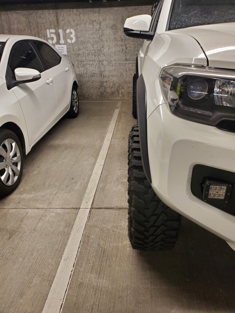

    Grey is -38 and white is -25, not sure of rims/tire specs tho lol

    not too sure, I believe you’re gonna have to chop and pinch inner fender but depending on negative offset and/or spacer you could get by. I’m trying to get a similar stance/setup to the white taco.

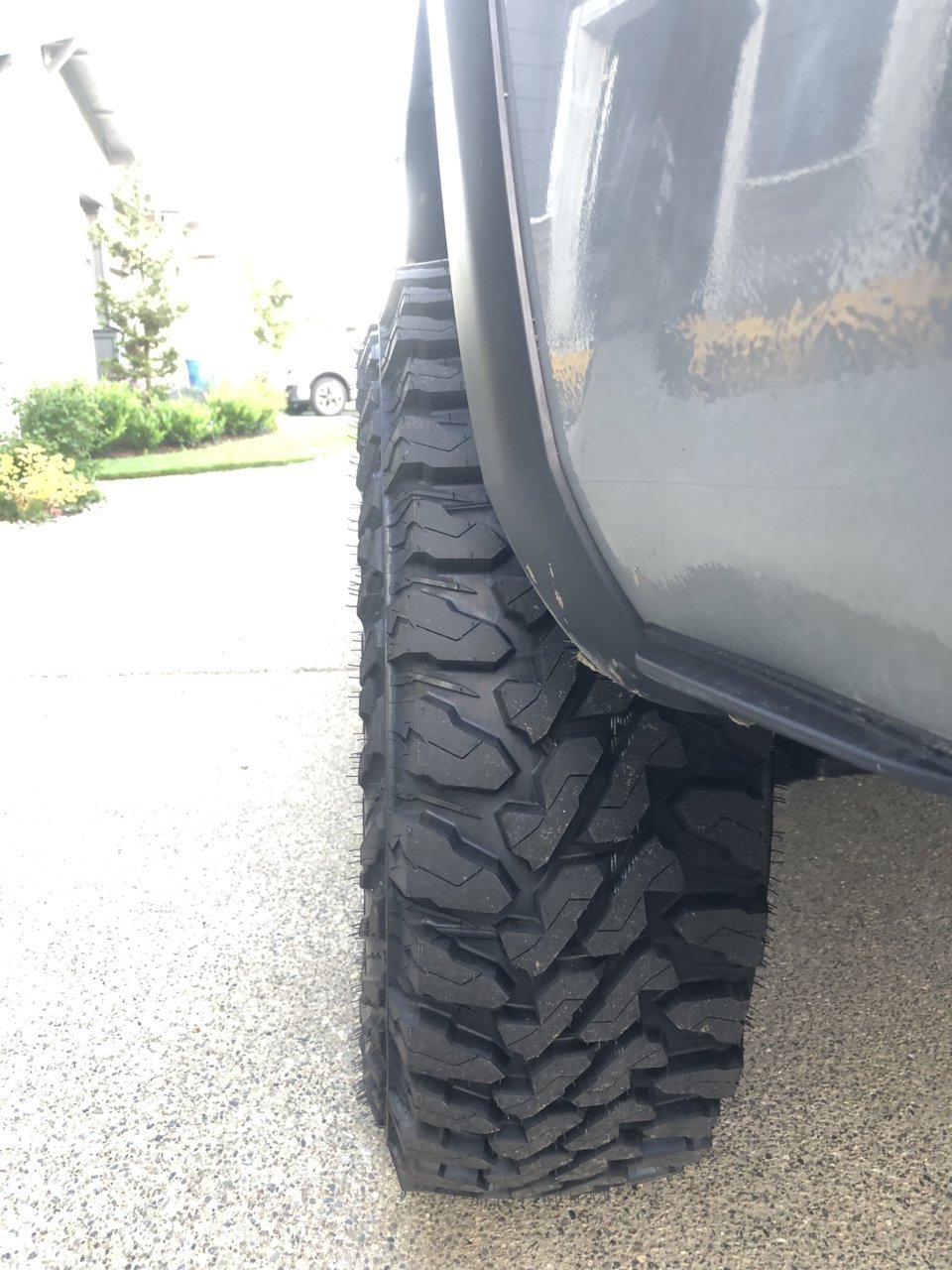

    This is 17x9 -12mm on 265. I know it's not 285, but it gives you an idea how much poke. You almost definitely are going to need a BMC. For reference, if you had the same size tires as me, you would poke out another 1/2" with -24mm

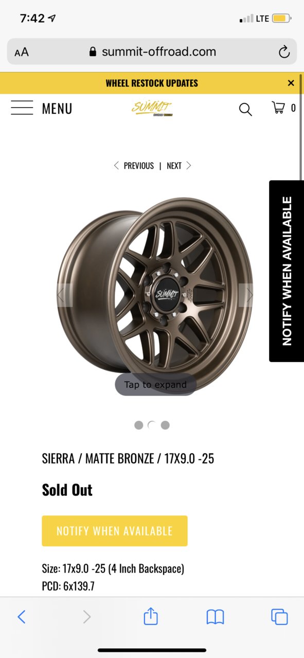

    how'd you get sierra's they been sold out for awhile, waiting patiently for a set myself for months now
