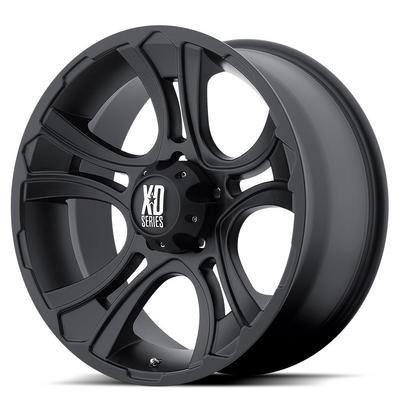

    Aloha everyone, I was wondering anyone has any information if I can run these xd 801 cranks which is a 17x9" wheel with 265/70/R17 BFG ko2 tire without rubbing? or should I buy the stock 265/65/R17 ko2 tire for a 2016 Tacoma double cab 4x4? The offset is 0, and backspace is 5 if that matters. lol any info would be greatly appreciated. mahalos for ur time. aloha.

    The dimensions sound like theyll fit

    I think on 2nd gen if you have backspace above 4.5 you risk rubbing the spindle. Not sure about 3rd gen.

    I'm not sure about the 3rd gens but 2nd gens -12mm offset with a 4.5" backspacing was the ideal wheel.

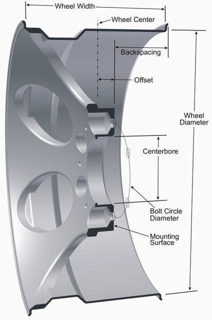

    I am ordering the revolvers, when you say backspacing is that an extra spacer or what are you referring to? When I searched for mine the offset was the only option for the wheels.

    (Width/2)+offset = backspacing

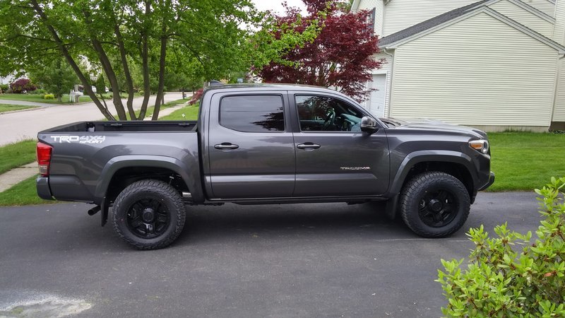

    I have on Gear Alloy Manifold 17x9 with a -12 offset on my TRD Sport 4x4. I wrapped them with Falken Wildpeak AT3 265/65/17 tires. Kept the same stock size on the tires since I was only allocated a certain amount of money by my CFO (the wife :)). I have no rubbing whatsoever and love the look of them as well. Tacoma with new wheels and tires 2.jpg Hope this helps with your decision.
