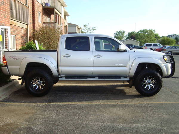

    I have the 17x9 XD Addicts :D

    LEO858, do you know what backspacing and offset your wheels are?
    mgage10, where did you get the awesome "TOYOTA" GRILL?
    Both of you, do your wheels clean fairly easily?

    Ok great! Did you have any issues with caliper clearance? The America's tire guys keep telling me that I need 4.5 BS with offset between -6 and 20 mm.
  8. Jan 6, 2011 at 7:09 AM
    TexasTacoma37
    TexasTacoma37 Well-Known Member
    Sep 3, 2009
    #22227
    31,174
    He's telling you what?? Backspacing and offset are not independent of one another.
    4.5" backspacing is what it is. Offset will be calculated using the backspacing and rim width.
    For a 9" wheel, 4.5" backspacing is -12 offset
    For a 8" wide wheel, 4.5" backspacing is 0 offset.

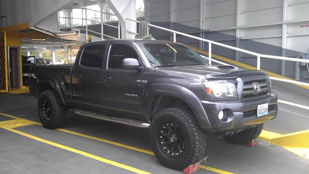

    What's the specs on your rims & tires? And what kind of lift do you have on your truck? Thanks!

    Pretty damn SIIICK

    275/70/r18 Duratracs
    Pro Comp 3" Suspension Lift
    Light Racing Upper Control Arms
    XD Addicts 18x9 with I believe a 4.5 Backspace, -12 Offset.
    Hope this helps.

    Thank you! Your truck looks really nice. Love the rims. Any rubbing issues? Did you have to chop/trim?
