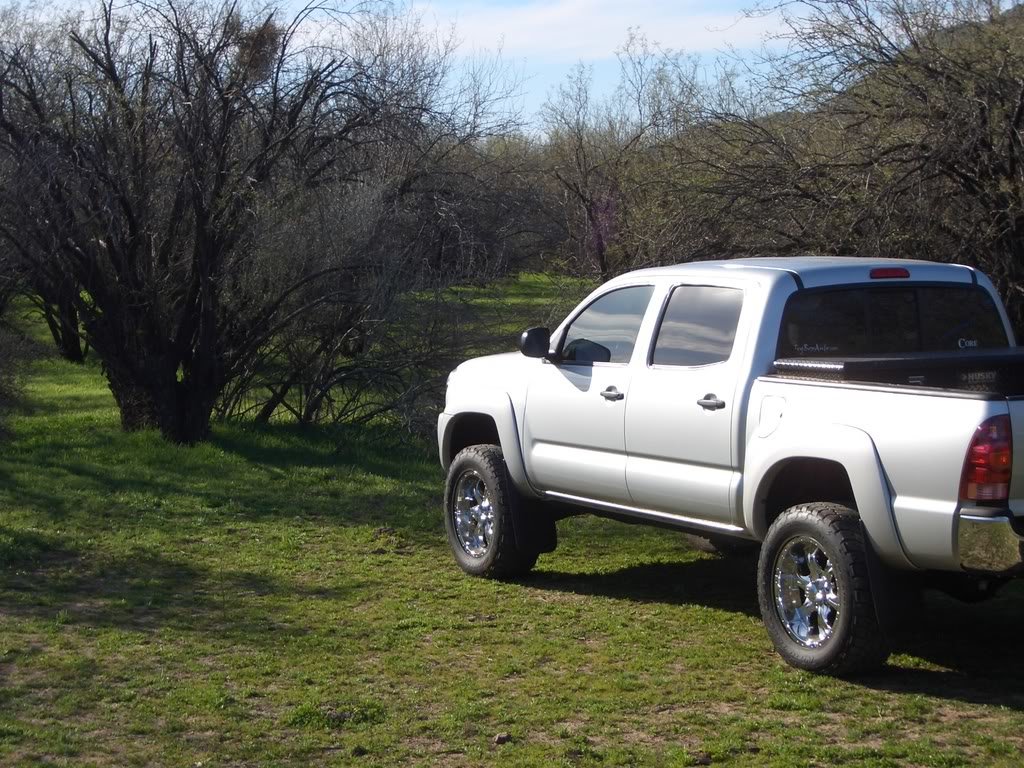

    I know...I think there tough lookin...there's a guy in my apt. complex that has em

    285x65x18 No rubbing at all. I have trimmed my inner fenders though
