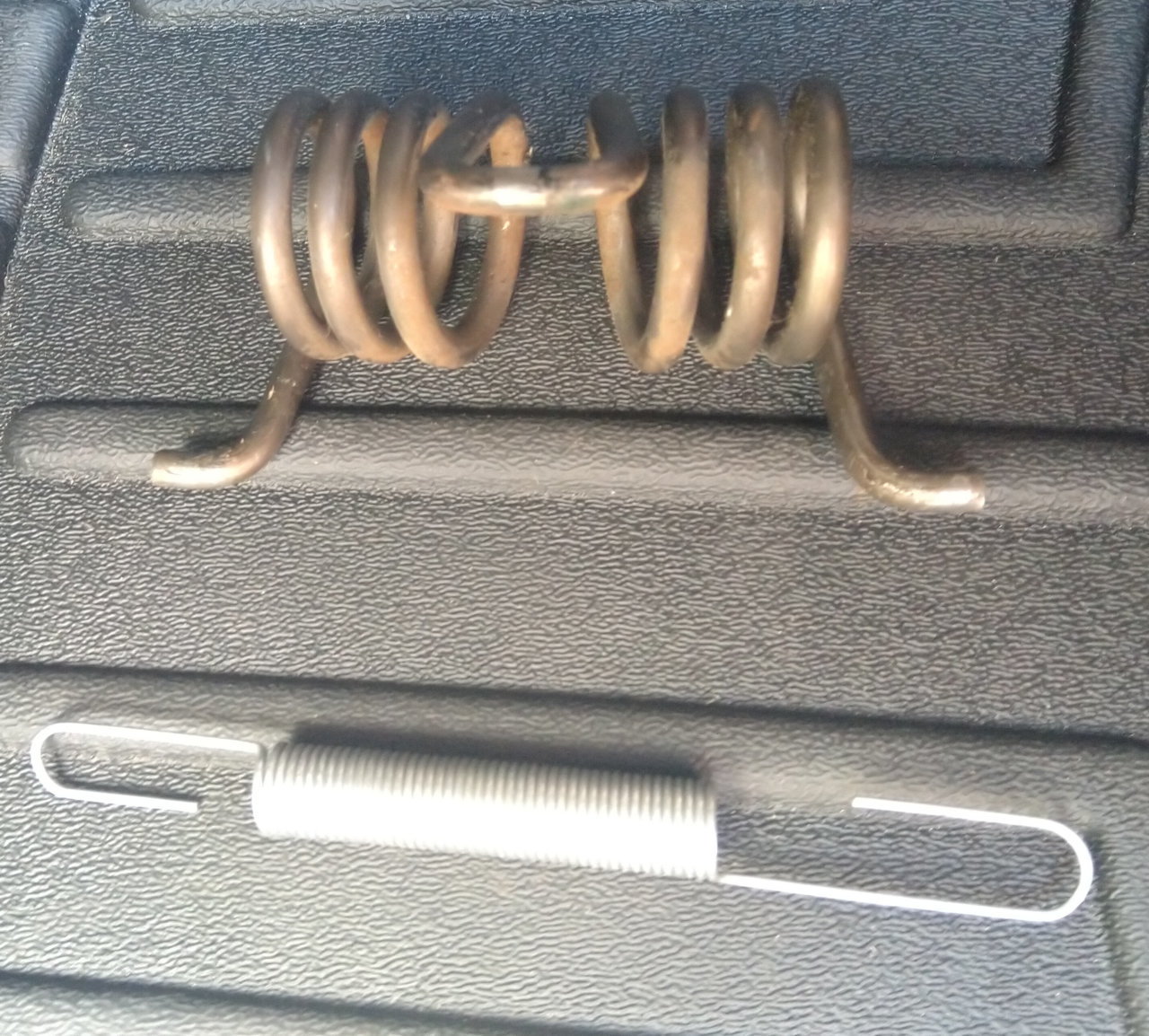

    You might try doing the linear clutch spring mod. That torsion spring on the v6 clutch pedal is more trouble than it's worth in my experience. You can replace it with a $2 #70 spring from Ace Hardware, or the $4 Toyota spring (90507-14030). Pedal feels better after the change and there are no plastic bushings to get worn down. It's a relatively quick job, you can remove the torsion spring without removing the pedal assembly, you just have to be a little flexible..
    Here's a thread on the mod: https://www.tacomaworld.com/threads/clutch-squeak-linear-spring-swap-tw-how-to.159429/

    Agree on the linear spring, a guy I know just did this on his V6 4WD Tacoma. He put in a new clutch and was having issues, turned out to be the pedal.
    It's interesting on the 5 lug Tacomas they used the linear spring set up. The tab for the linear spring is present on all Tacomas, (on the body structure
    under the dash) so the conversion is fairly easy.
