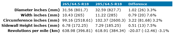

    Okay the guy I'm ordering from only has the 5" backspacing in stock. Would this be good or bad? Anyone here running this?

    You'll have to run 265/65/18's with that backspacing. Either that or get 1/2" wheel spacers to run the 285's.
    With the 5" backspacing and the 285's, you'll rub on the UCA.

    Well I definitely don't want to have to buy a spacer after spending so much on wheels/tires. Aren't the 265's about a half inch smaller in diameter?

    Oh crap... that's a lot bigger difference than I thought. Not sure if I want to go with a tire that much smaller. I guess I'll have to try to wait and see if he can get the 4.5" backspacing :(

    its overall 1" but the sidewall difference is 1/2". I really liked my 265/75/16 with my old OME 3" lift
