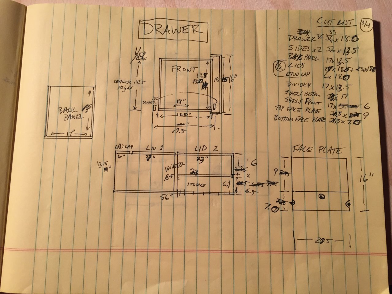

    Would love to see the "blue prints" or a parts list for the drawer.

    I did a build thread on it, but that didn’t include a cut list.
    https://www.tacomaworld.com/threads...-diy-camping-drawers-pic-heavy-thread.554249/
    This is the cut list I sent my local lumber yard and for $70 of labor I got back something like 23 perfectly cut boards. Being a cabinet if it’s not EXACTLY 90 degree cuts you’re screwed. So here’s my cut list to fit a short bed truck, accounting for a tonneau cover and 56” sliders with locking handles sticking out.
    Truck Bed Drawer— all 1/2 inch furniture grade plywood
    Outer Box-
    Top & bottom. 58x20.5 x2
    Sides. 58x15 x2
    Back. 19.5x15 x1
    Drawer-
    Bottom. 33.25x18 x1
    Sides. 56x13.5 x2
    Back & divider 17x13.5 x2
    Shelf bottom. 22.75x17 x1
    Shelf front. 17x6. x1
    Top face plate. 20.5x9 x1
    Bot face plate. 20.5x7 x1
    Drawer Lids-1/2”
    Lid 1. 27x18 x1
    Lid 2. 23x18 x1
    End Cap. 6x18 x1
    Cubby bottom 6x17
    Cubby side 6x17
    Stove Pocket-
    Cutting board 22.75x16.5 x1
    Sides. 22.75x5 x2
    Stove board 22.75x14 x1
  8. Oct 15, 2018 at 7:42 AM
    Papadave418
    Papadave418 [OP] Well-Known Member
    Jul 17, 2017
    #224251
    1,938
    Shopping List I Used, plus a ton of 1 1/4” nail gun nails and 1/2” wood screws

    THANKS Dave! I owe you big time. If you ever want to take a MTB trip IMBA Gold rated Park City, UT, give me a holler. We have over 400 miles of trails and most are stunning. I'll be your tour guide.
    I do have another question though. Do you wish you would have done anything different with your drawer system?
    I've got an access cab so I have a 6' bed. I'm just going to make the box longer and use maybe 66" slides instead of 56".

    Hmmmm my only issue with my drawer is weight. The drawer slides are like 80lbs alone. But they are the backbone for smooth operation, but weighty. I looked at 80/20 but it would have doubled the cost easily, and it felt daunting to plan and figure out every T nut and corner brace needed...on my yellow sheet of binder paper. Hahaha

    Yeah just add 10” to the length and you’re good. I’m making another one for my friends DCSB with a back flip cover I think. It has a roll up compartment underneath so we just subtracted 10” off the length.
