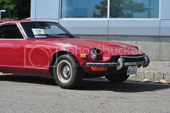

    I picked this one up shortly after getting back state side for $5k in 2012. It’s a numbers matching ‘73 240z that was in okay shape. Had been shoddily re-painted, but ran and drove alright.
    I wish I still had early pictures, but lost them due to a hard drive failure. For a few years I drove it stock, made minor fixes and a few small upgrades. New alternator, rebuilt carbs, hoses, belts, fuel pump, and a couple electrical upgrades.

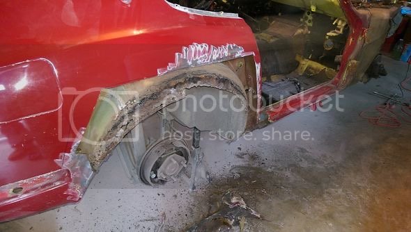

    Then I decided to take it apart to start the body work. Then I bought a house and moved.

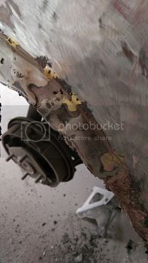

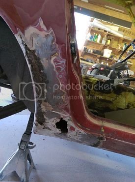

    The rust repairs were not great....

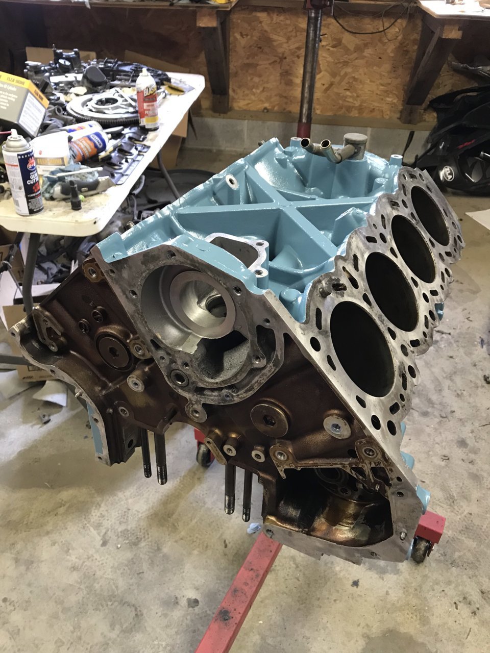

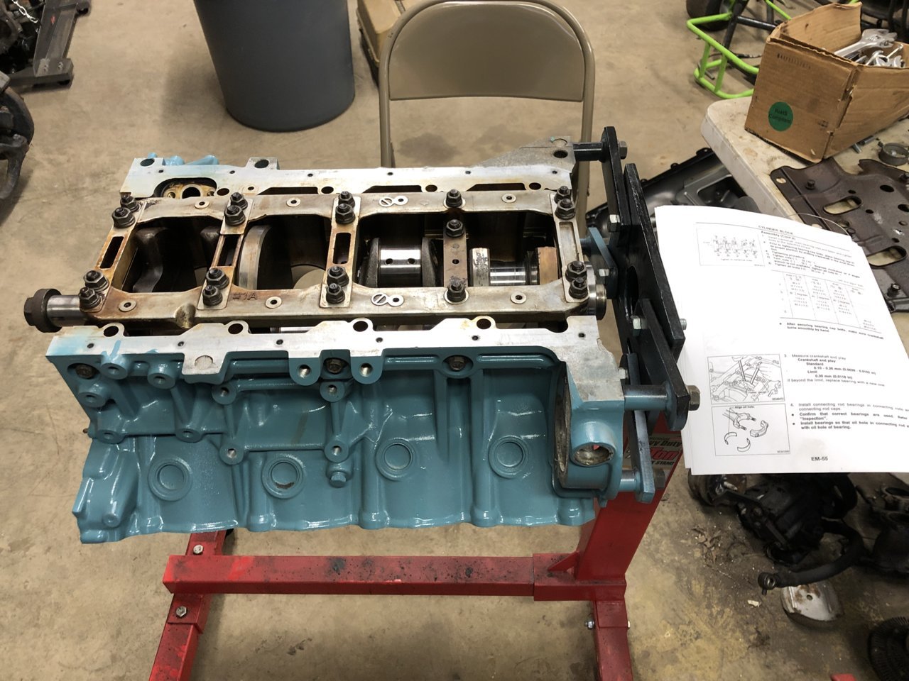

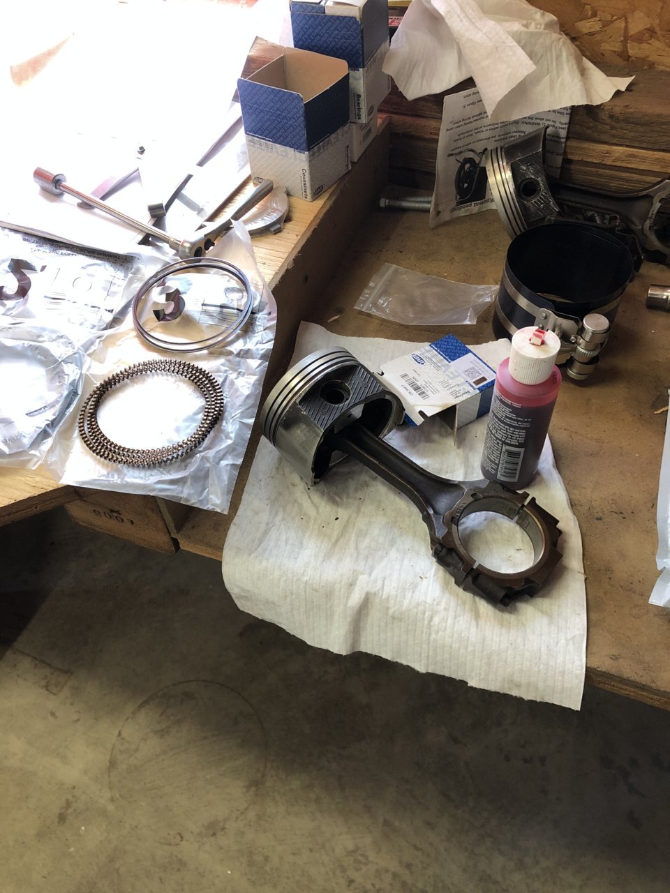

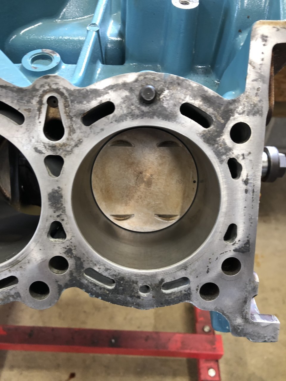

    4.5L Nissan V8, aluminum block and heads, DOHC, VVT, forged internals, six bolt mains w/girdle, 350ish hp, for $300!
    Yes it comes stock with studs in the bottom end.
    It’s getting a factory refresh with chain tensioner update, custom exhaust, BMW ITBs, and possibly re-ground cams.

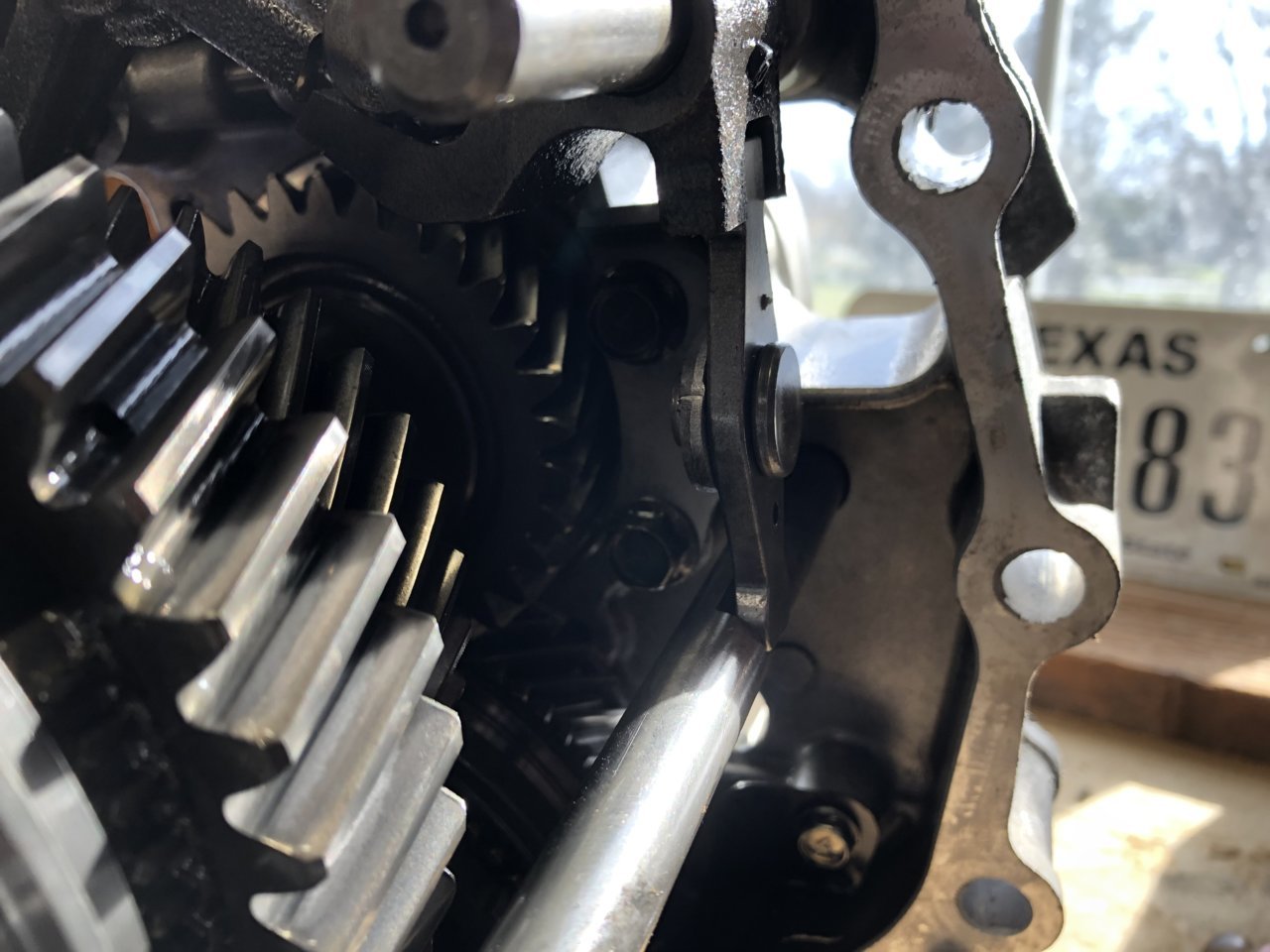

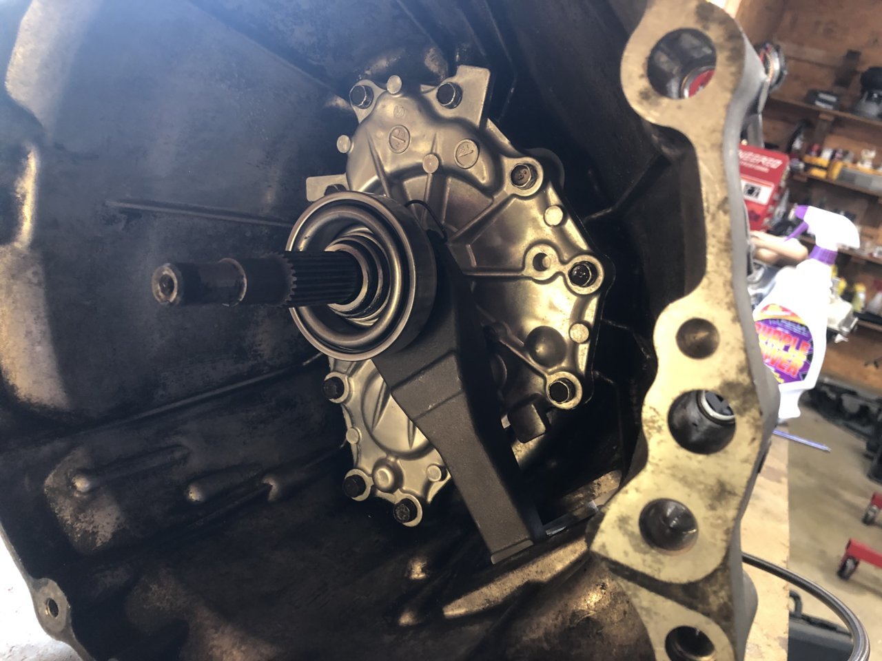

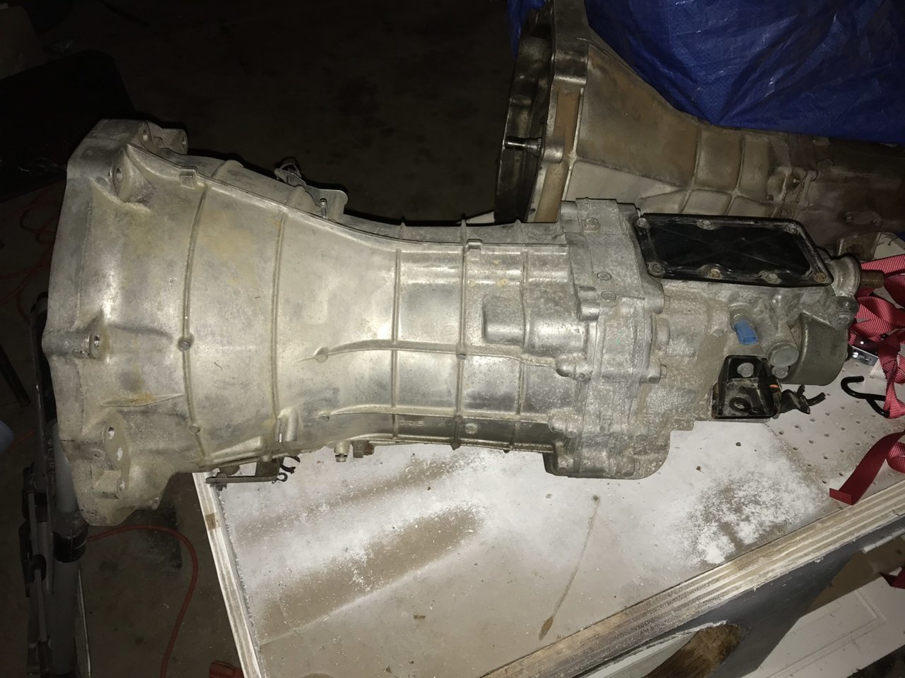

    I managed to find a six speed out of a G37. Same trans as CD009, but with a concentric slave. I was told that 5th and 6th were shot, but couldn’t pass it up for $300. Turns out that there was a broken lever in the trans, so I fixed it for $50 worth of parts and seals.

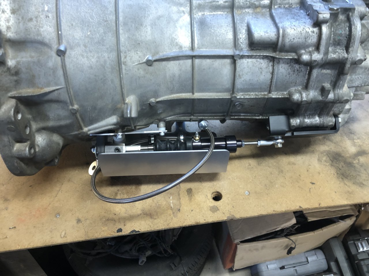

    One of the only downfalls of this trans is the Concentric Slave cylinder. I picked up a kit from Z1 Performance that will delete this and move to an external slave. I’m also using their clutch and flywheel, which will all mate up to the engine thanks to an adapter from Collins.

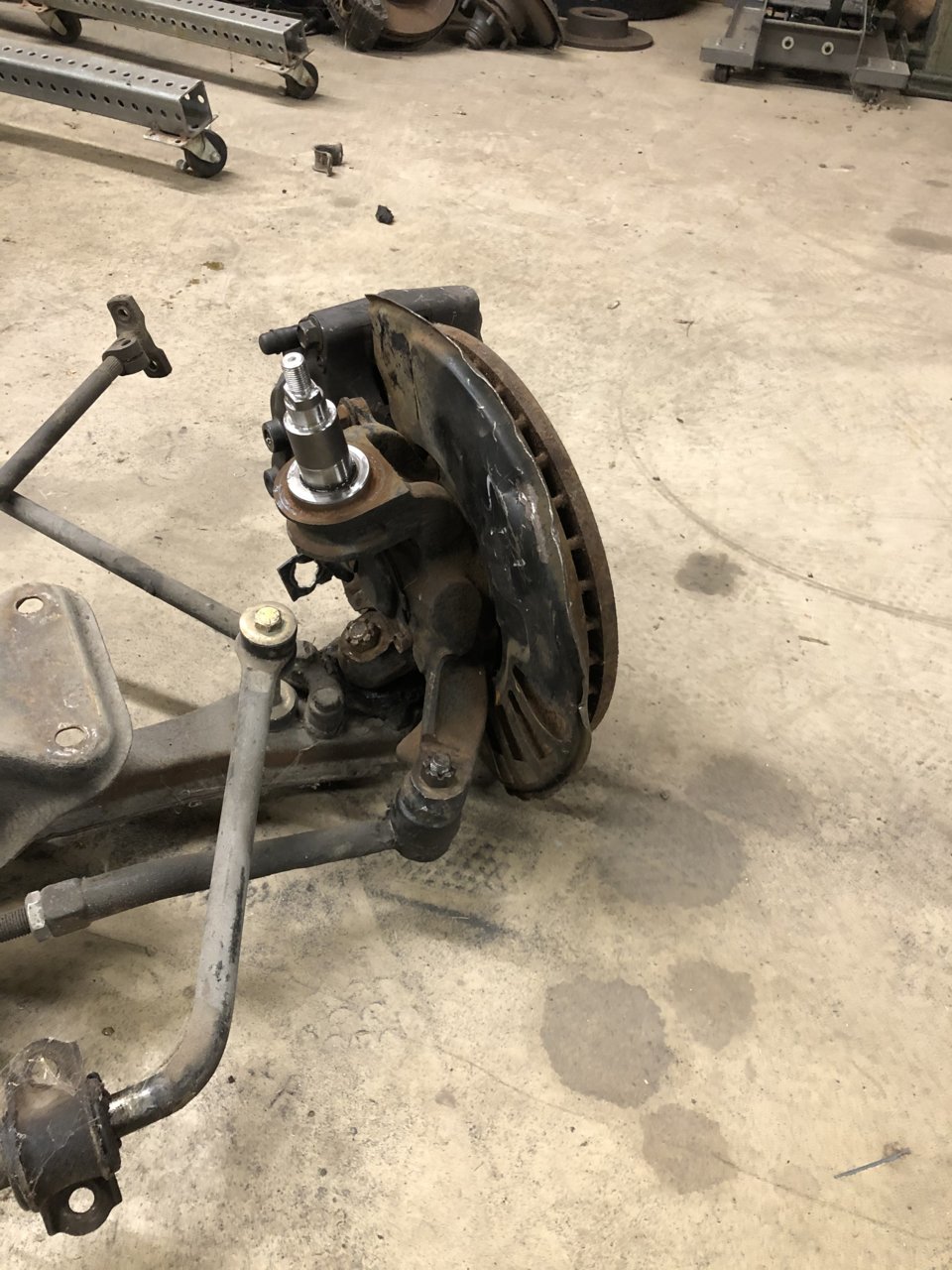

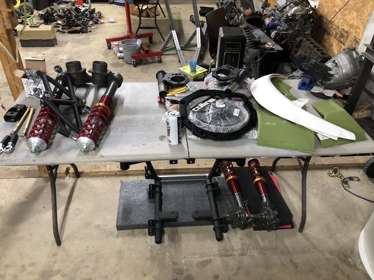

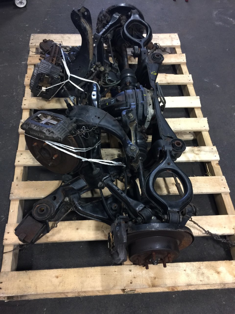

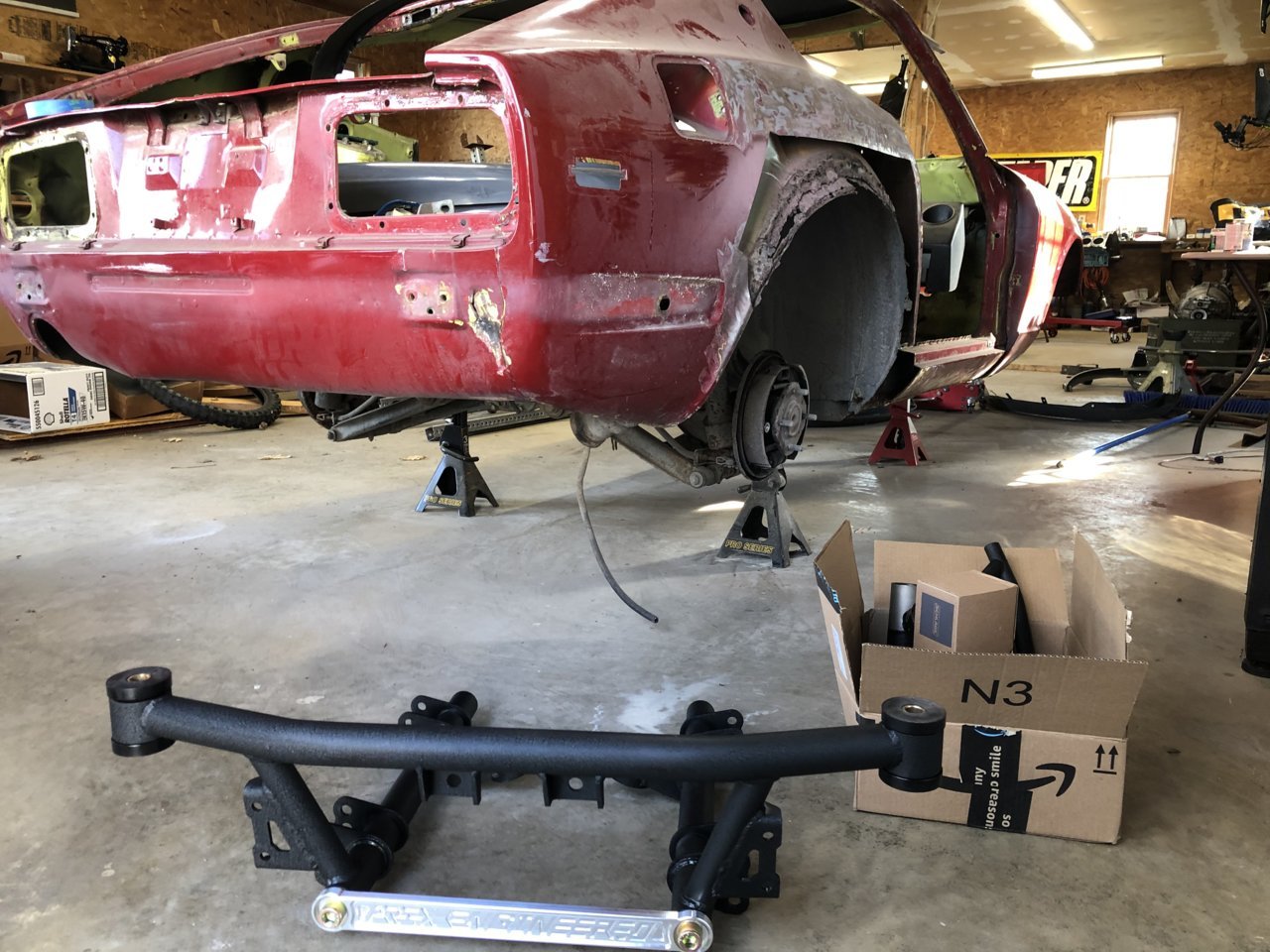

    This engine and trans combo would shread a stock 240z diff, so I needed a solution for the rear end. The rear end of the Z is not great, but luckily a company called Apex Engineered makes a subframe that allows you to bolt on modern diffs, CV axles, and adjustable LCAs. The uprights I am getting from TechnoToyTuning, who did my coil overs, will allow me to bolt up R32/Z32 rear hubs and brakes, including the stock e-brake.

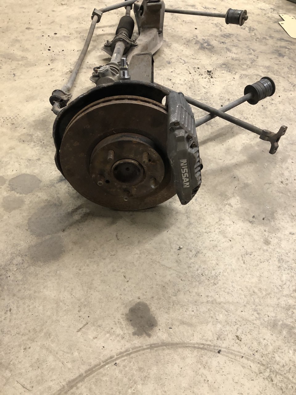

    To source all the parts for the swap I turned to EBay, and got a set pulled from an R32 GTST. This gives me big brakes, a 5-lug swap, CV upgrade, and an LSD.
    I also discovered that the front knuckles from an R32/Z32 are direct bolt on to stock 240z front LCAs and tie rods. Need to get tubes welded to these to convert to McPherson after taking a few measurements. Hoping this will work so I can swap the front with FACTORY parts.
    I’ll be rebuilding and painting the calipers. Also plan on new bearings, rotors, and refreshing without.

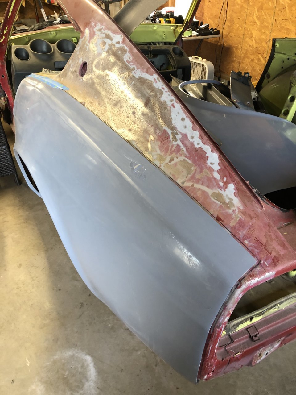

    Lastly is the body. I honestly considered restoring this car, but it’s MY car, and who cares what the purists think.
    Luckily a new company has popped up making panels for this car. Previously there weren’t very many good options. The stock sheet metal I got can be seen above, they’re green. The rest will be some things from a company called Ztrix. They make excellent FG parts for the Z.

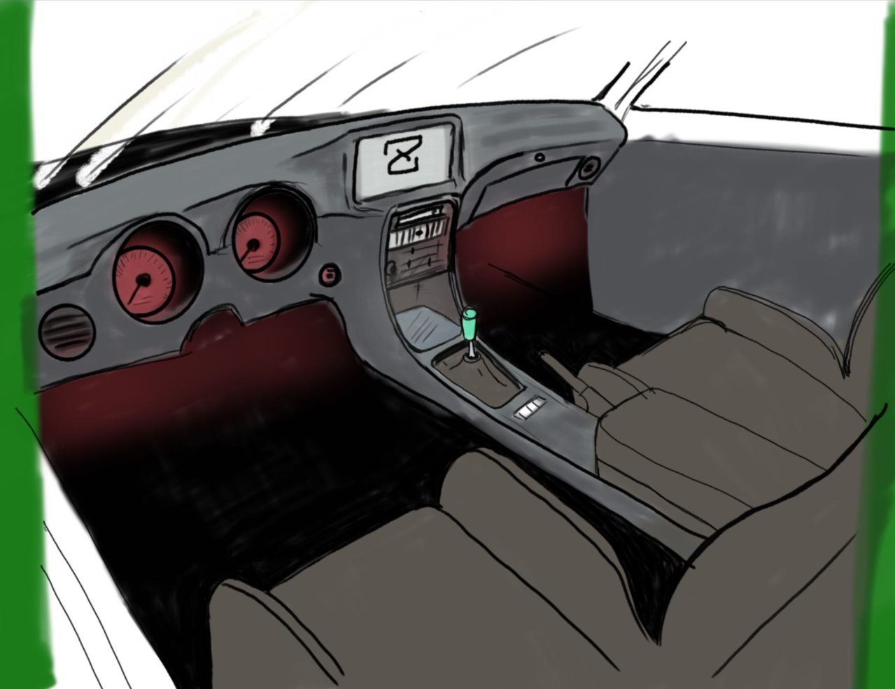

    This is their subtle wide body, adds a couple inches to the width without changing the lines too much. I have a few other ideas for the styling, need to sketch them up and find out a way to make them a reality.
    I plan to keep the interior simple. Maybe modernize a bit.

    Is your engine painted a Nissan color? At first I thought it was Detroit Diesel green, then Chrysler or Pontiac -- and after comparing -- you win -- what is it? :annoyed::):)

    It’s actually a Pontiac color, easy to find on the self at most auto stores. Closest you can get to the original Datsun color without paying $30 per can. Used engine enamel primer and then the blue color. I have the original engine too, and it’s pretty close. Will look good with the valve covers painted wrinkle black.
    I also got my Z1 Performance CSC delete installed. Will need to be adjusted on the car.
    This gets rid of the major weak point of the JK41b, and makes it as good, if not better than, the venerated CD009. For the price I got this trans for it was a steal! This kit is really nicely made, and the instructions are well written.
