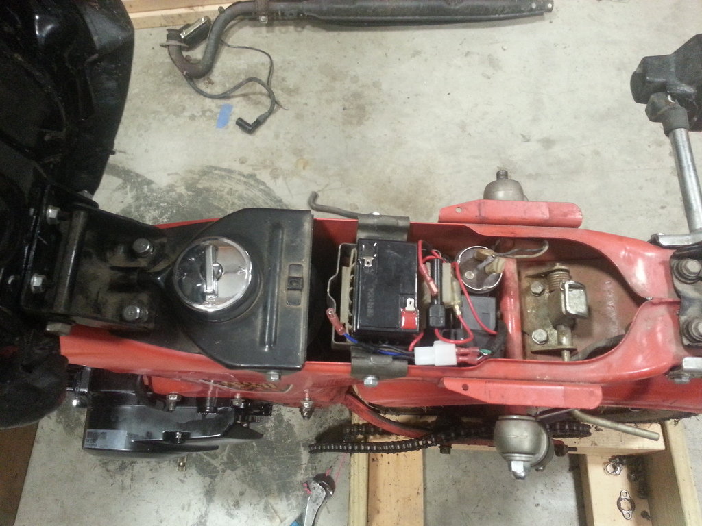

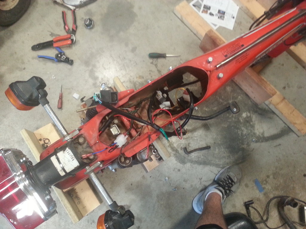

    The red 1980 bike had 807 miles when I did the engine swap. I took it from the original 70cc 3-speed auto-clutch to a 125cc full manual 4-speed. I installed a new wiring harness in order to maintain the 6 volt system so that I wouldn't have to buy a new battery and light bulbs. The increase in torque is awesome! Eventually, I want to get a new exhaust because the original one is all rusted out and sounds like trash. New suspension would be nice too.

    Here are various photos of the process of the swap. Not too much to show...

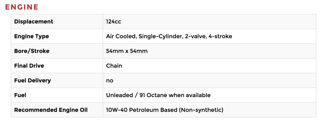

    Engine Specs:

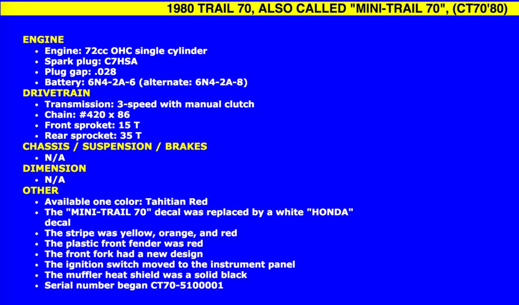

    General information about stock bike:

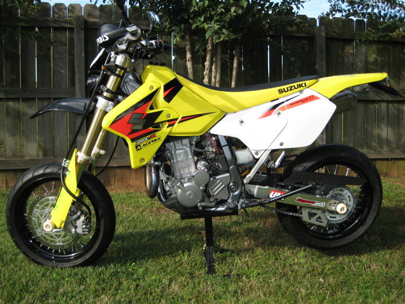

    Currently sporting these:
  18. Sep 11, 2016 at 10:03 PM
    #18
    MatthewMay1
    MatthewMay1 [OP] I'm an amateur professional.
    Nov 21, 2011
    #67486
    11,092
    Matthew
    Lone Star Republic
    Supercharged '01 TRD
    Nice! I'm usually not a huge DRZ fan, but that one looks really good!
  19. Sep 11, 2016 at 10:20 PM
    #19
    t4daddy
    t4daddy Well-Known Member
    Jun 16, 2010
    #39041
    7,435
    North Alabama
    2008 PreRunner Double Cab
    Actually, me neither. But I fell ass backwards in to what was a very good deal. I then went ape-shit crazy and tore down a perfect engine (7,000 miles) and dropped in a big bore 440cc (Cylinder Works) kit, Hot Cams stage II cam set, Yoshi Ti TRC full exhaust, brand spanking new Mikuni 39mm flat slide carburetor, had the head freshened up with new valves/springs and lord knows what else. Anyways, the dyno claims 46-47 bhp. It's a blast to ride around town and embarrass Harley's on!!!
