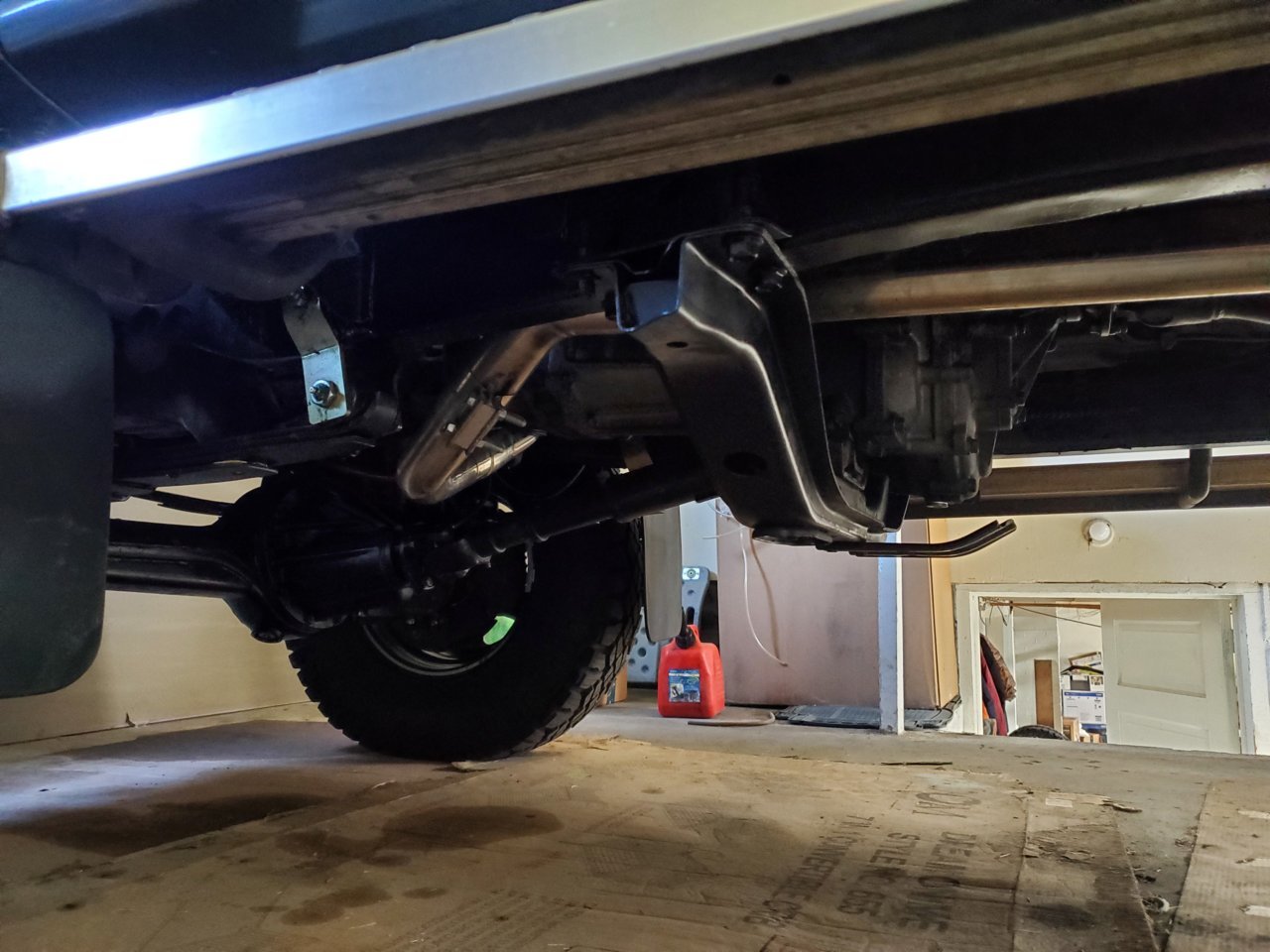

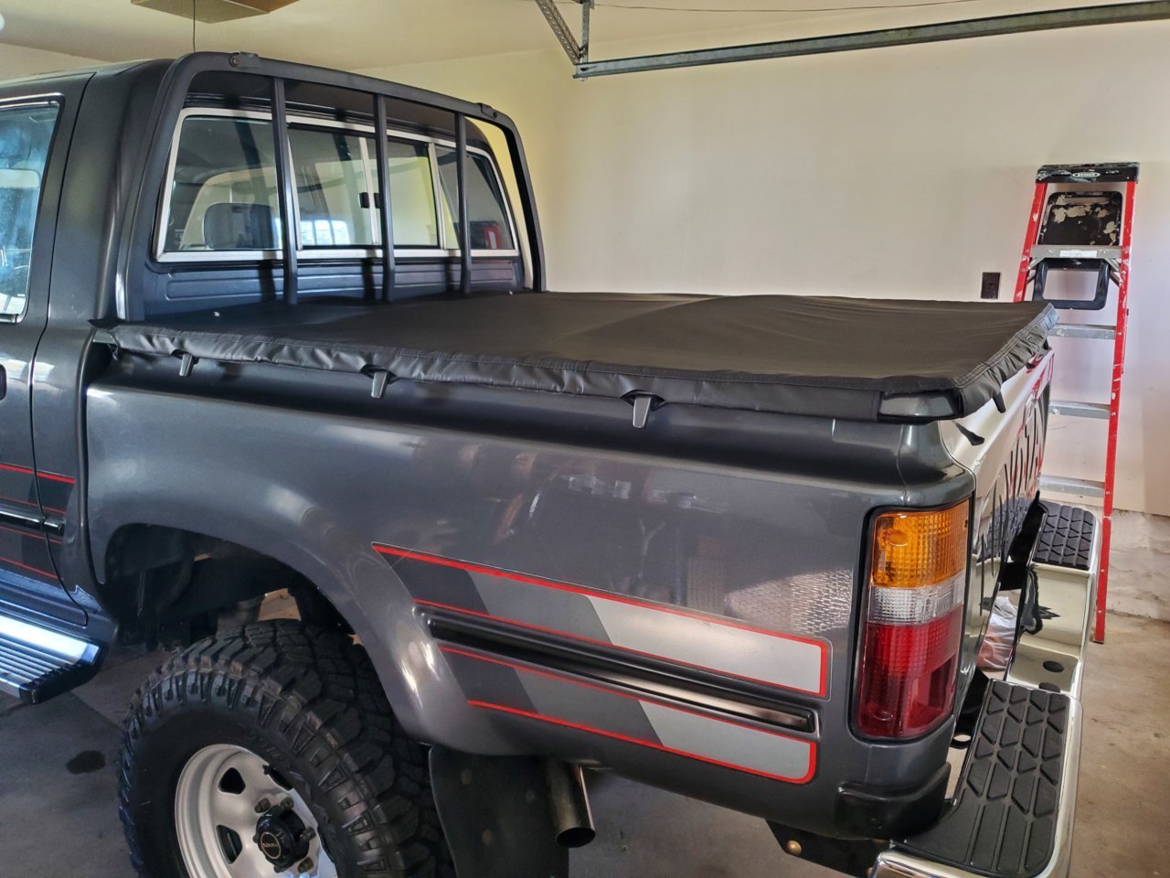

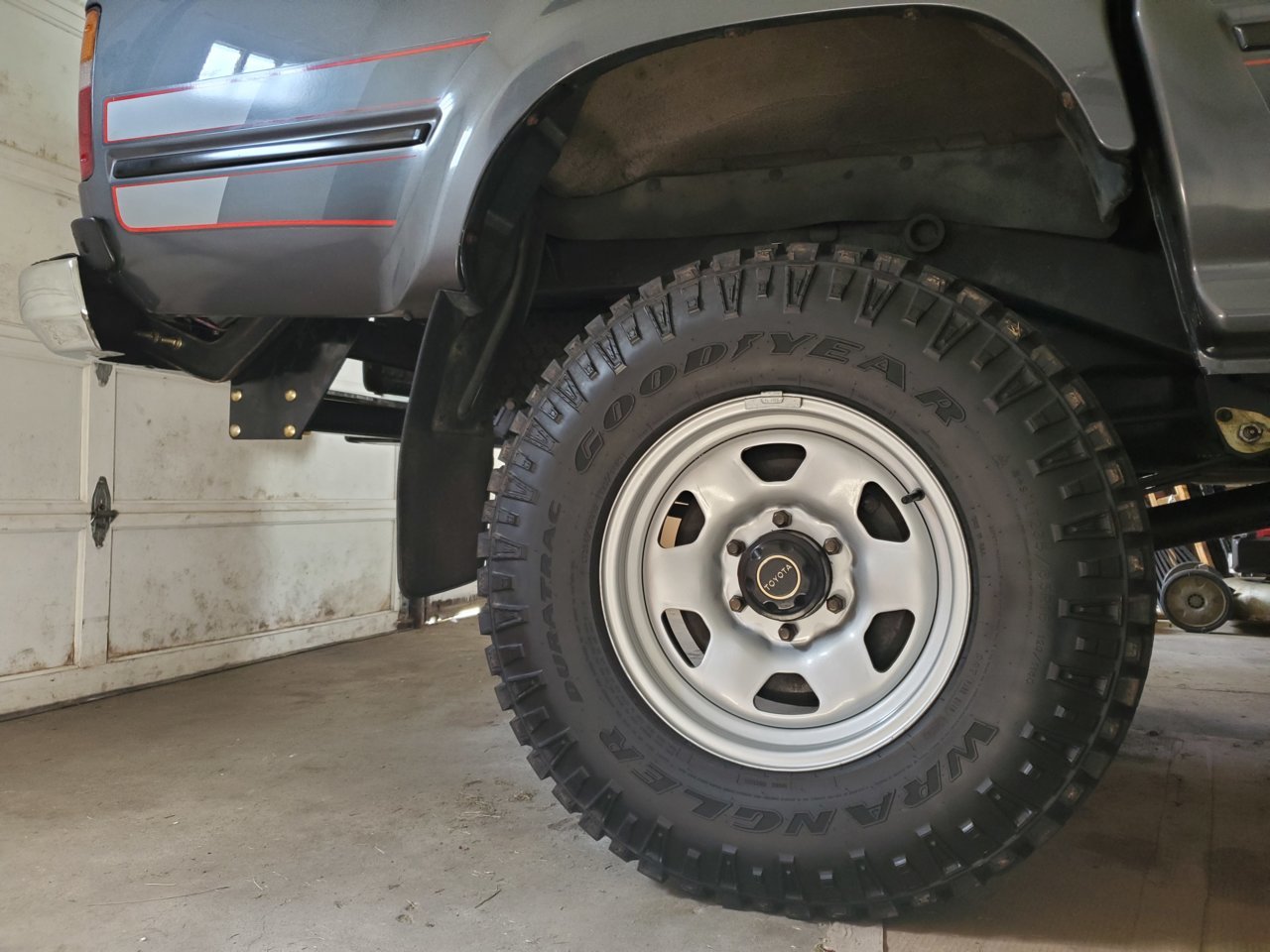

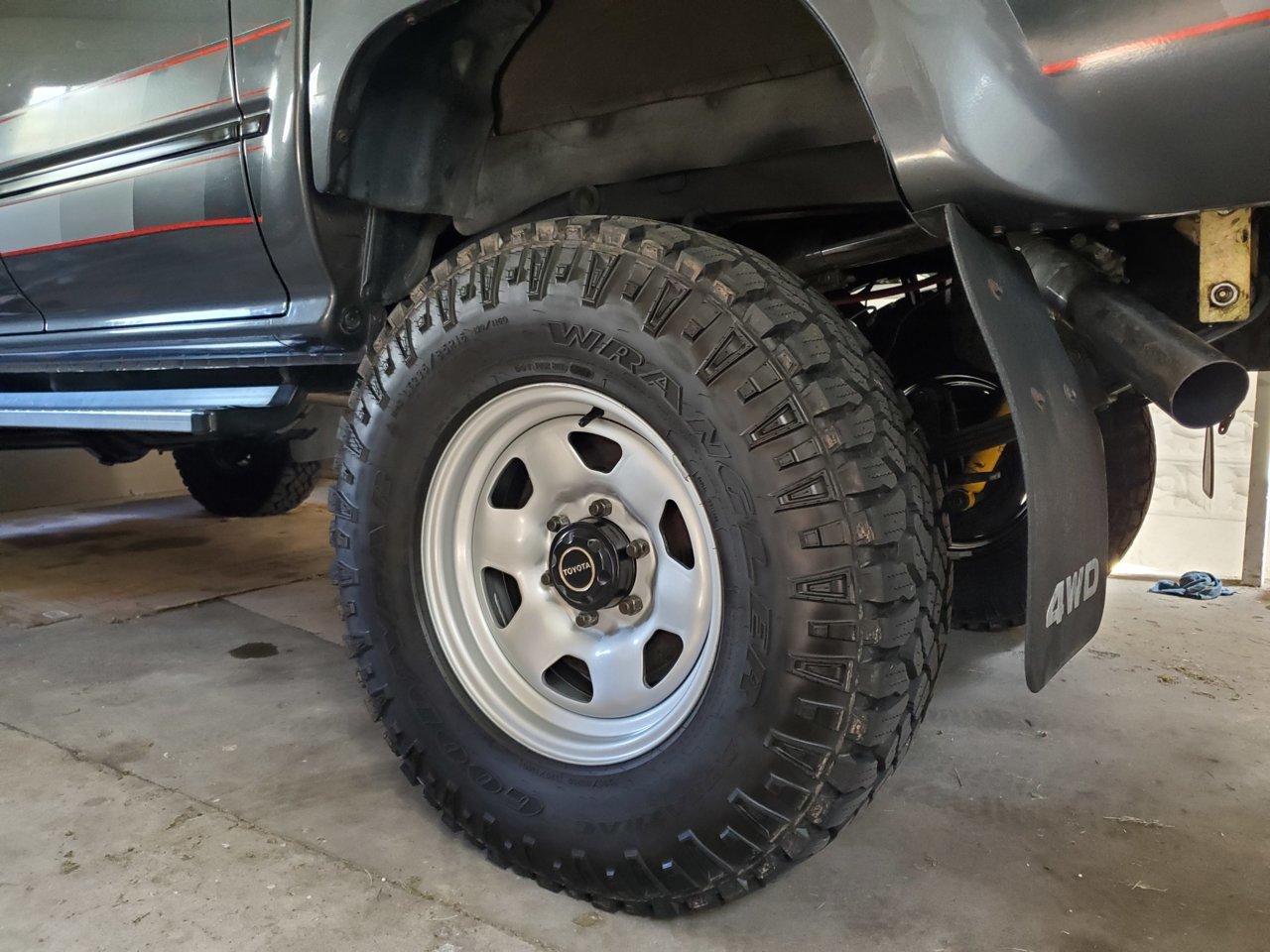

    Here is the new 2.5 inch mandrel bent 304 stainless exhaust. It was put together for a diy kit on eBay. I connected it with clamps from summit racing. The turbo is now the only muffler. I routed it under the transmission and changed the exit to the same spot on the USA spec trucks. It gives a little more clearance compared to the stock setup. I was worried about clearance issues with the front-drive shaft and rear leaf springs but there isn't any contact when under flex to the bump stops.
    New tires 235/85r16 and 16-inch steel Toyota rims. A tow hitch (same part as USA spec Toyota pickup.) Also removed the rollbar and replaced it with a tonneau cover from the UK.
    20200921_112413.jpg 20200921_112304.jpg 20200921_112426.jpg 20200921_112354.jpg 20200921_112242.jpg20200921_112445.jpg

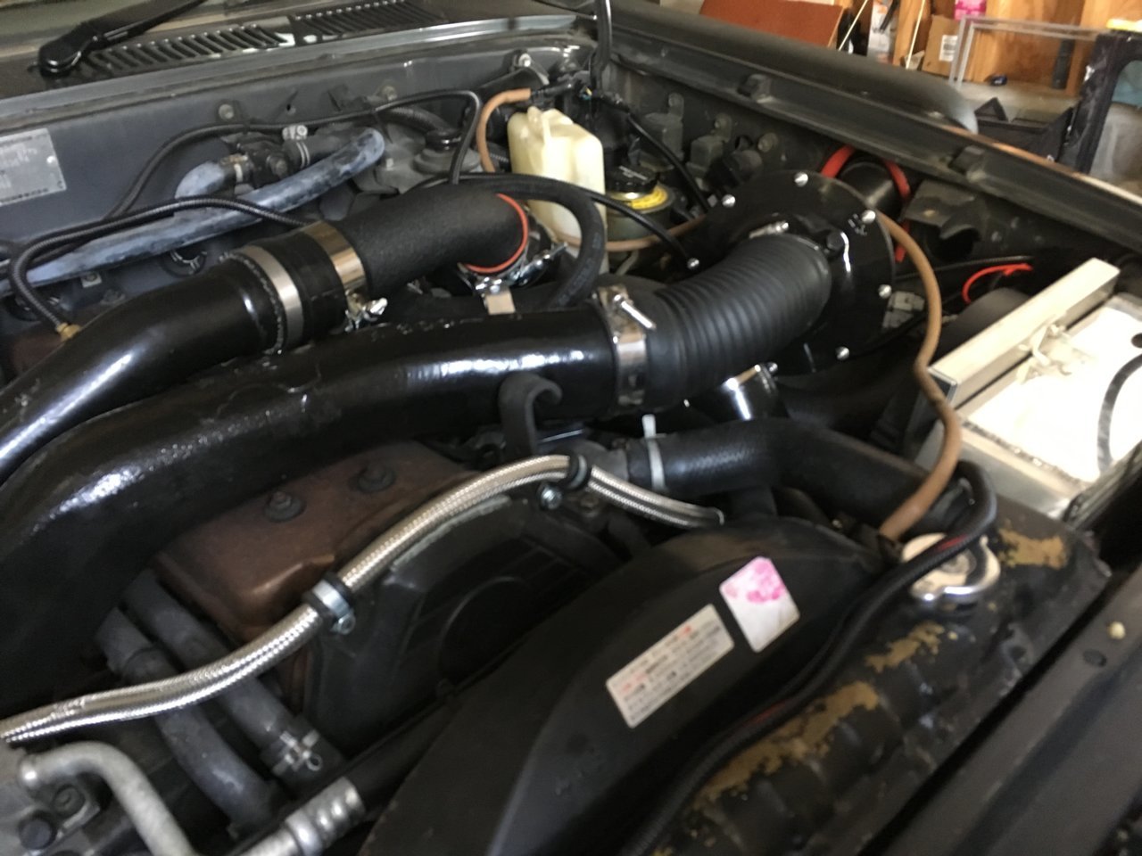

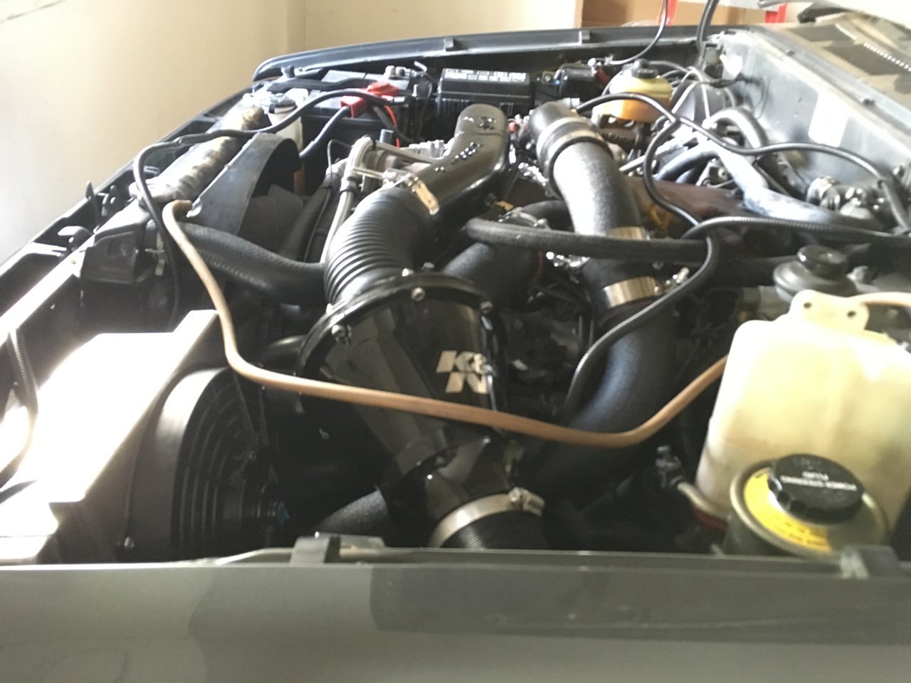

  6. Dec 27, 2020 at 3:07 AM
    #46
    HighLux4x4
    HighLux4x4 [OP] Well-Known Member
    Jul 27, 2017
    #225136

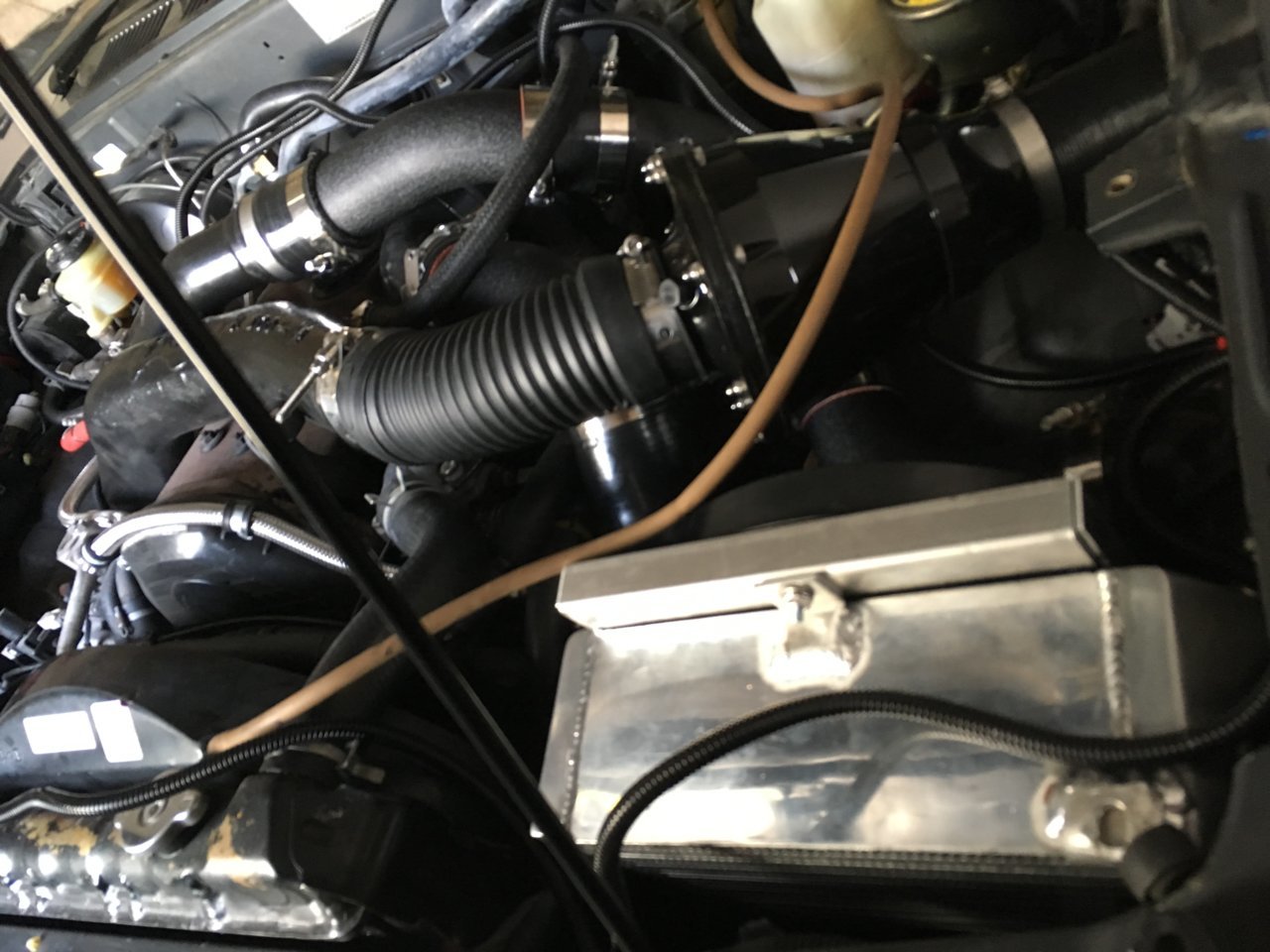

    45
    Added an air to air intercooler. There is no possibility for a front mount without removing a/c. It was a really tight fit without a body lift. The cooler is an aftermarket sw20 with puller fan. The post turbo intake is 2.5”. If i would have went with smaller diameter intake or a 1inch body lift It could have retained the factory air filter. A k&n Apollo fit well and it was a perfect fit to the snorkel.
    I’ve saw other builds use this intercooler as a top mount but they needed a pretty large body lift and a hood scoop. I copied the piping and mounting from to a2w setups others posted.
    The radiator overflow tank is temporary until I can pick up a better fitting aftermarket one.442D0BCA-BE7A-42E3-89AE-5AB9B53BC117.jpg 809DE8B4-EEB8-4A6B-8268-0255384AECB8.jpg 83831320-53C5-4A8E-BAB2-9FA39D967733.jpg

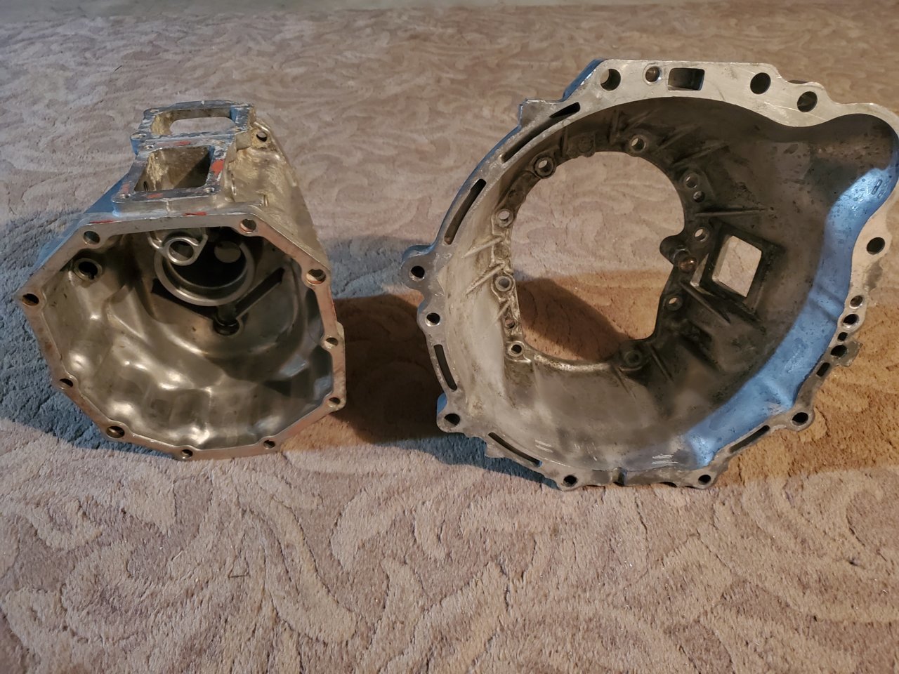

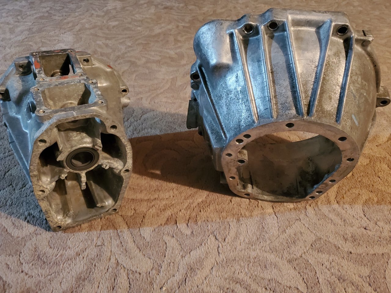

    20210129_181630.jpg 20210129_181600.jpgR151 tail housing and L-engine to R-series bell housing. Tail came from 1986 Turbo pickup and the bell out of a manual 2l-te hilux surf from a wrecker in Canada.
    I should be able to pickup R150 locally for next to nothing. I plan to switch out the tail with the R151 and maintain the same 4.5" forward shift to gear driven transfercase in the current G52 Transmission. I want to switch over to 23 spline and dual transfer cases. First step is cleaning up the housings.
    I think with intercooling my transmission is living on borrowed time.
    Per Marlin Crawler,
    Re: transmission strength question
    The W-series is about 20% stronger than the G-series: Larger and wider bearings, larger and wider gears. In comparison, the R-series is at least twice as strong as a W-series, probably more.

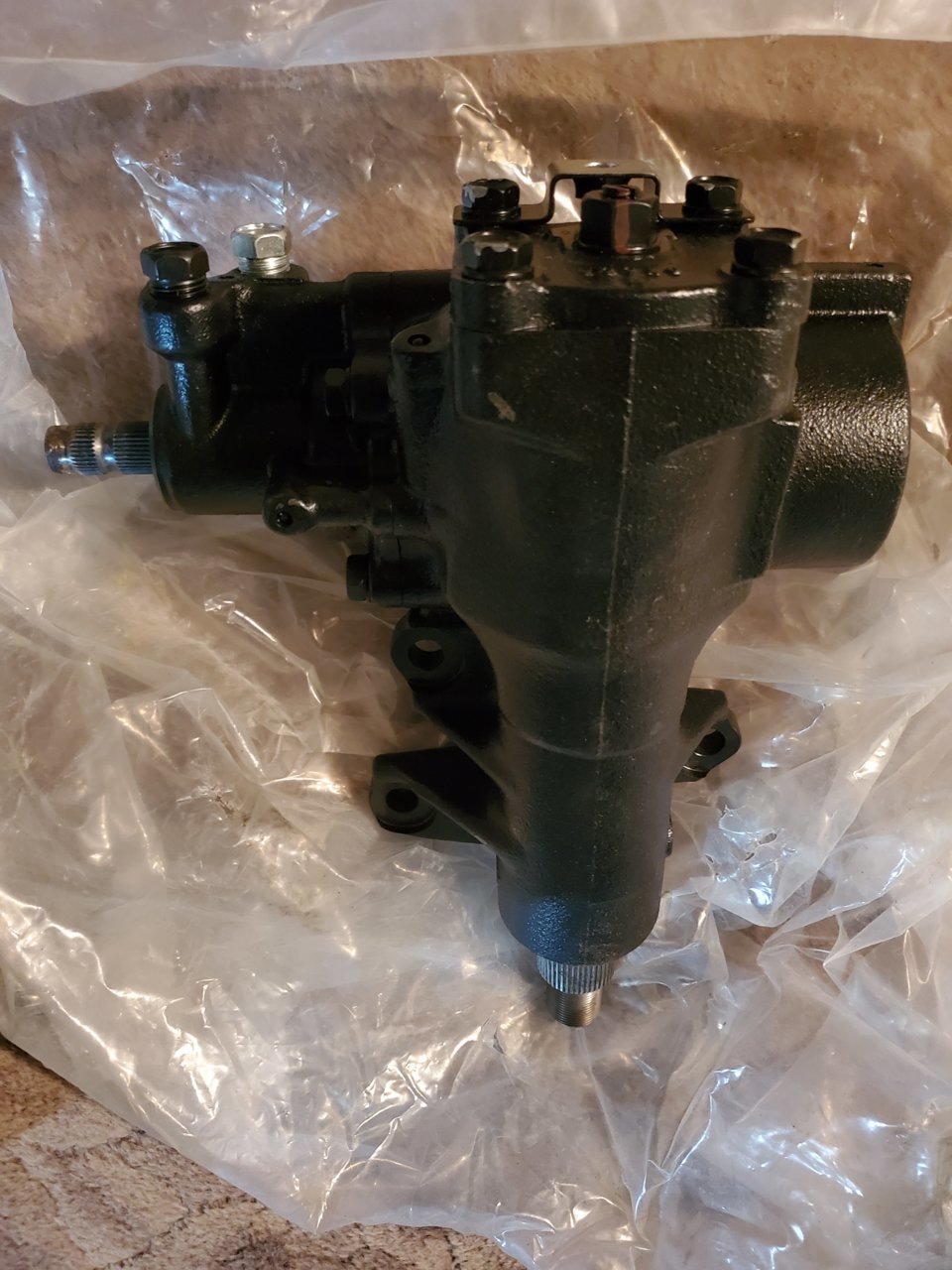

    20210129_181843.jpgIFS style RHD power steering pump. Someone had many brand new old stock for sale in Chicago. I'm going to move over to high steer at the same time as the drive line mods.
    I'm on the lookout for a dual case setup or just the dual case adapter and a top shift case. Advanced adapters has the most reasonable price new. It is an older design and cast aluminum. Hopefully I can find a Marlin crawler, inchworm, or trail gear on the used market.
    Trail gear has a RHD high steer kit I have been eyeing up waiting for a sale. I plan to move the axle forward when installing the dual cases. A local driveline shop is going to lengthen the front driveshaft and covert the rear to a solid one piece. I want to be rid of the center support bearing.
    I been chasing weird charging issues ever since it arrived from Japan. I finally broke down and ordered a high output internally regulated one. I'm going to change out the timing belt and drive belts at the same time as they been on for over 10 years.

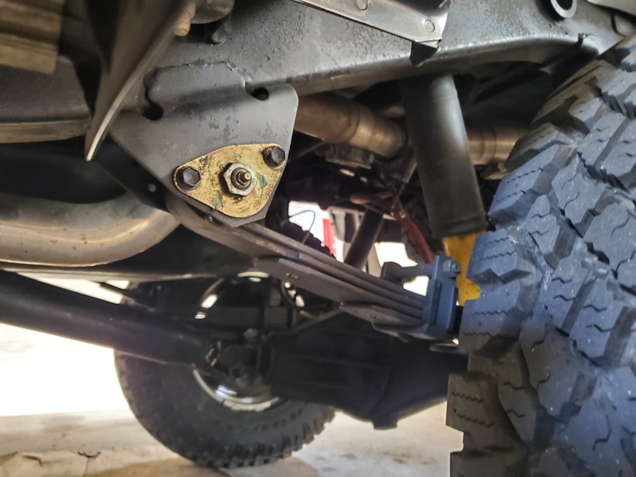

    Here are some pictures of the axle rebuilds I did in the Spring of 2017 about a year owning the truck. I used marlin rebuild kits for front and rear. What a dirty job.
    At this time, I installed the Harrops elockers into third members, old man emu suspension, and stainless extended brake lines. Right now you can pretty much buy the same elockers directly from Eaton without having to ship across the world. IMG_2480.jpg IMG_2482.jpg IMG_2479.jpg IMG_2481.jpg IMG_2547.jpg
    I had to take the rears axles to a shop to get the bearings pressed out. I realize today that i could have just hit them on ground against a block of wood or purchased an ebay toyota bearing press and had the actual tool for less than I was charged.

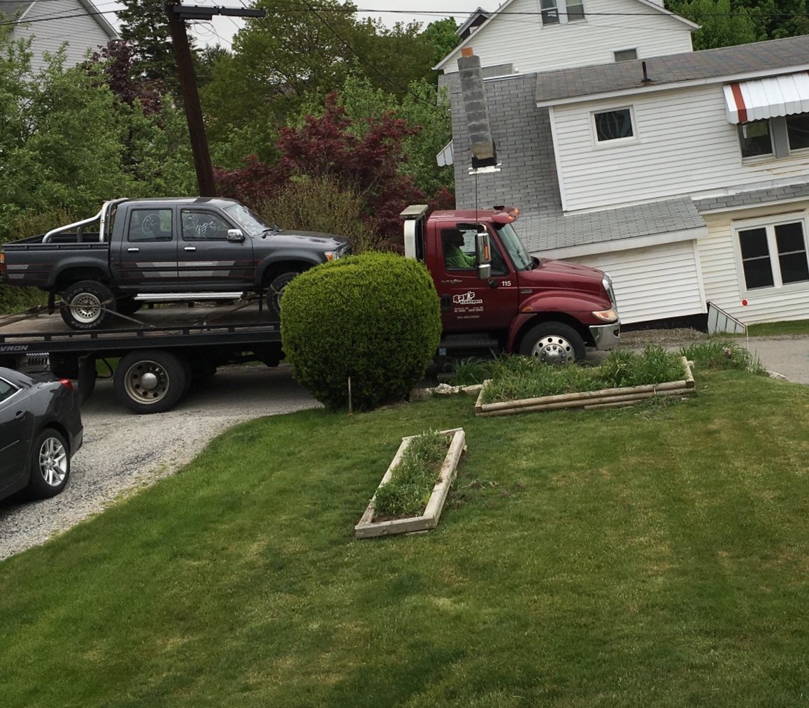

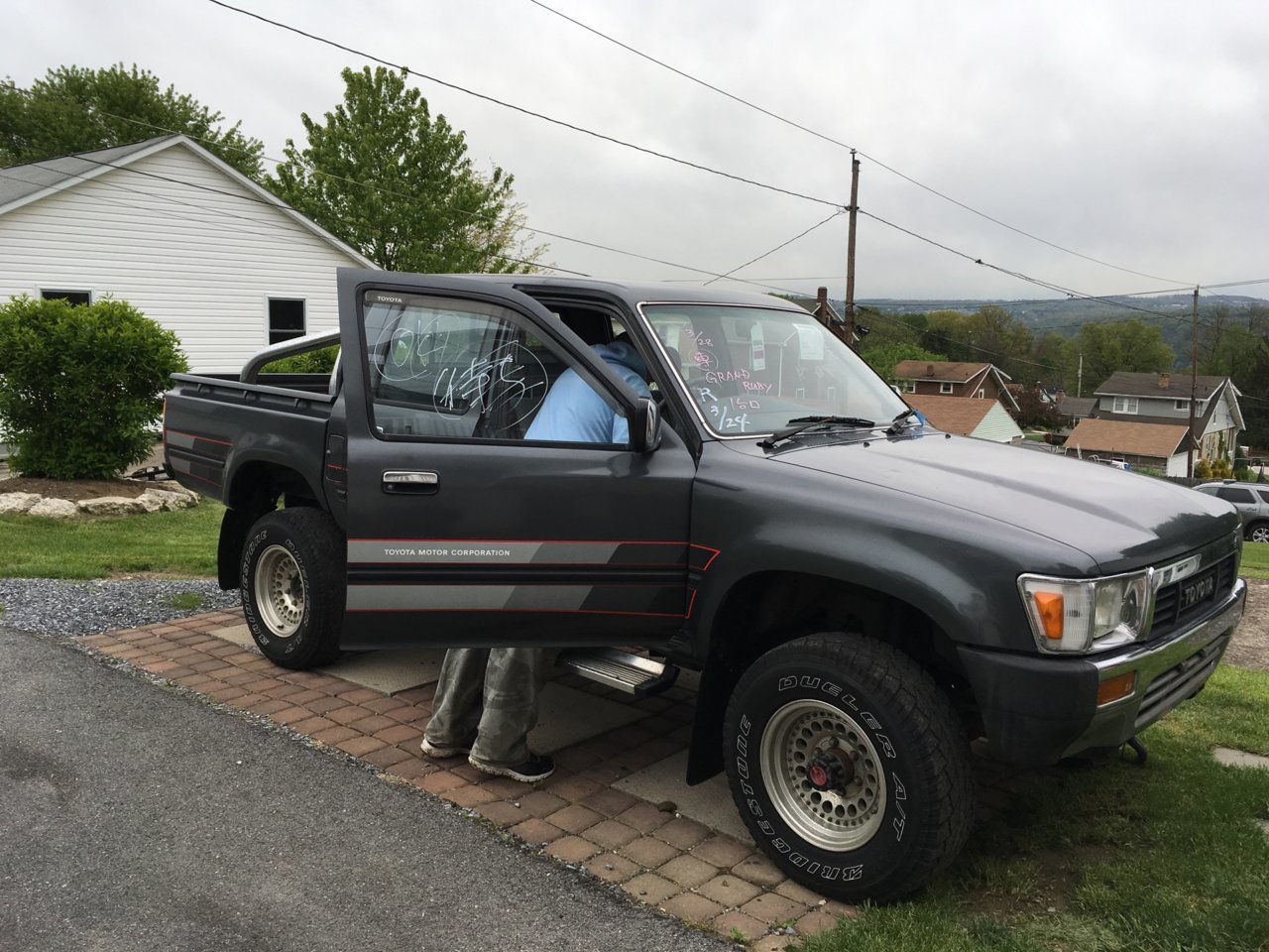

    I found some pictures of the day it was delivered in May of 2016. You can see the writing on the windows from the auction in Japan and from the RORO ship. From the auction sheet i was the 2nd IMG_1403.jpg IMG_1401.jpg IMG_1402.jpg IMG_1399.jpg
    owner. Original owner had it for the first 25 years.
