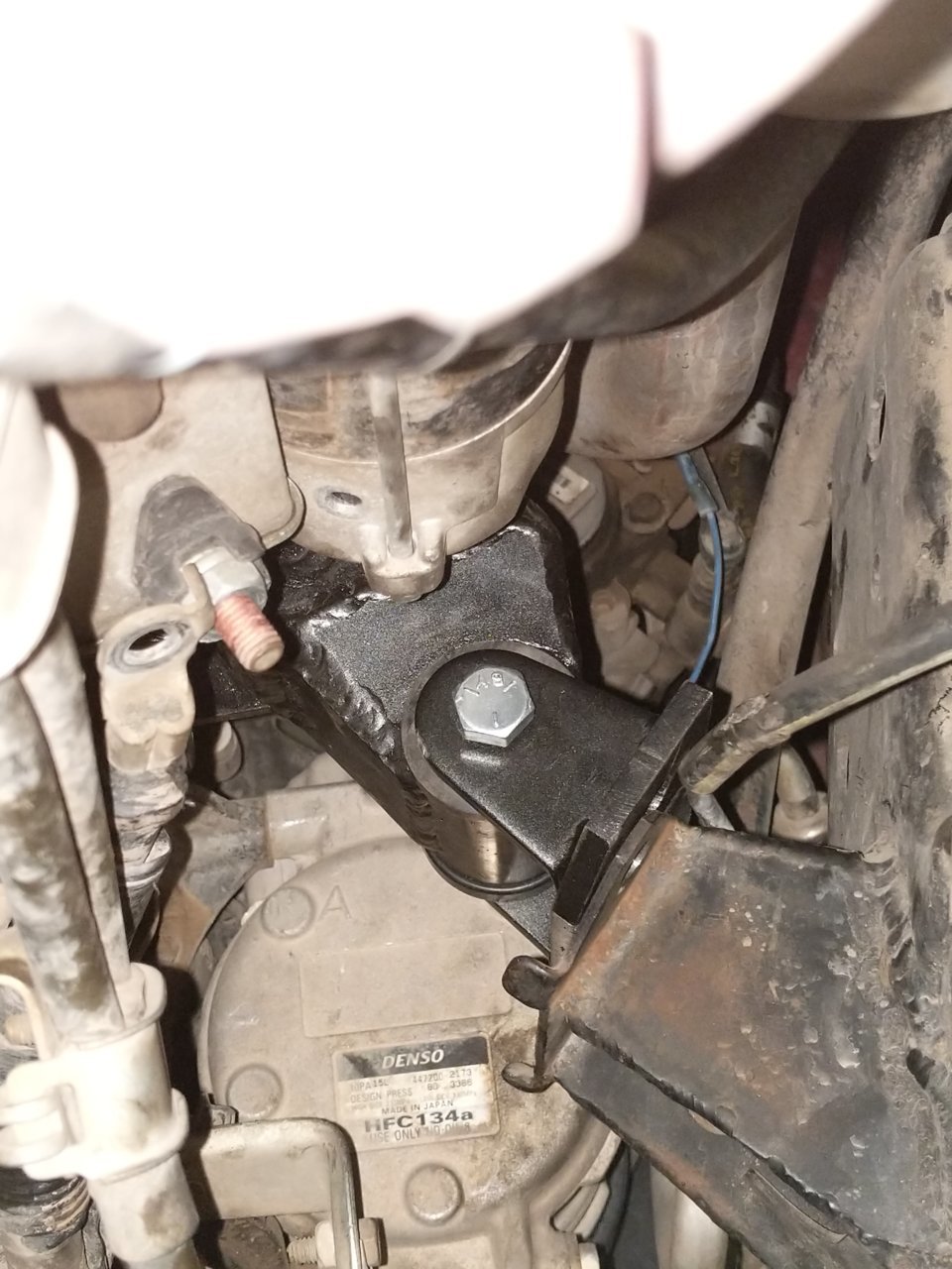

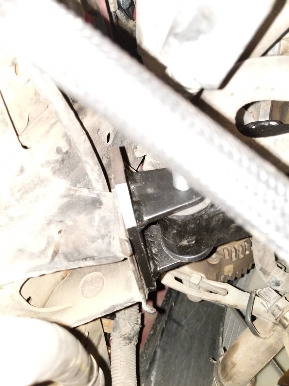

    Metal.
    Driver's side
    I don't know...they seem too off to be tweakable which is why I'm wondering if I somehow swapped the bottom pieces and that's why they aren't lining up

    Anythings possible, should pm the vendor. I haven't got mine yet so I'm no help lol

    Maybe if you tilt the engine forward... I got mine in by bolting up one side first with one or two bolts loose but with the nut threaded on. Then I pounded the other side with a plastic mallet until I got one and then two bolts through.

    The weight of the motor is holding them at that angle. The motor needs to be lifted slightly, and the frame perch mating plates angled downwards to allow the motor to drop another inch. Then lower the motor and the plates will line up. On some trucks its easy. On others not. Make sure all the bolts are in and started before tigtining anything. Trust me they will fit. You have set #200+
