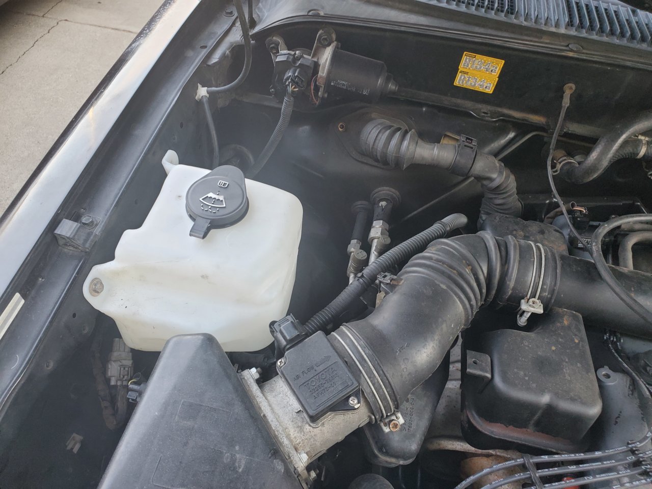

    I got an OEM replacement washer fluid reservoir. It didn't fit in the original spot, so I moved everything up here where this unit is designed to go. Super easy job. Toyota left junctions for both the wiring and the water line here, and there are threaded holes on the inner fender, too. Essentially plug and play.
    The washer nozzles were clogged, so I ordered a set of Honda Odyssey adjustable nozzles (76810-TK8-A01). They popped right in. What an upgrade from stock!
