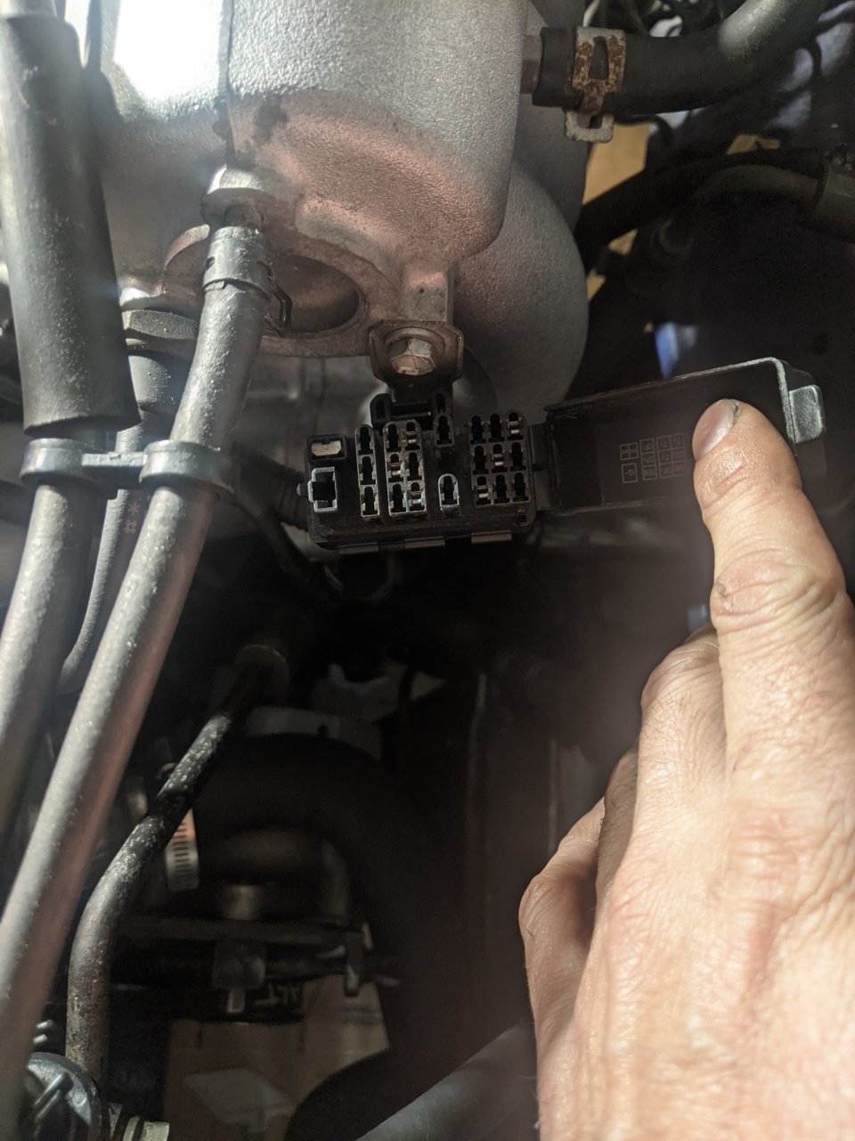

    The '95 models do not have an OBDII system on them, they use the first generation of OBD, so I'm not sure if Autozone can scan the codes or not. If you search on the internet there are some articles explaining how to use a paperclip to find the code.

    If its a Tacoma it has OBDII.
    Your statement would be true if he had a 95 Pickup.

    x2, first gen tacomas has obd2.

    My bad, I must have picked up some mis-information somewhere...:sorry:
