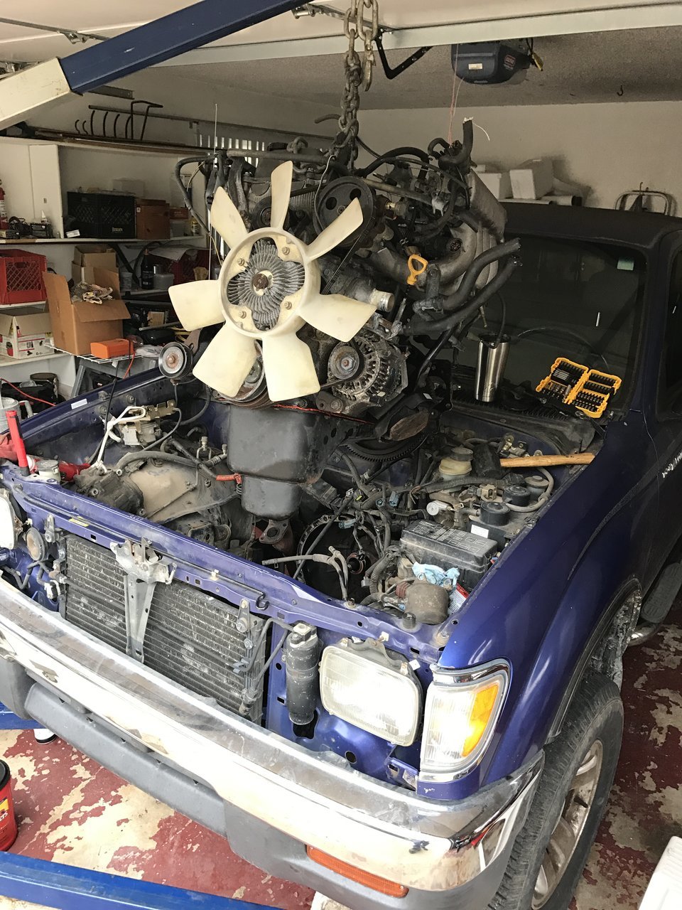

    So I just got finished helping my dad swap a JDM 3RZ in his 1996 Tacoma. There were a few things on his original where we decided to use the JDM intake and exhaust manifold. Had to fab a little on the down pipe, but its fine now.
    Our issue now is with the idling. Truck runs smooth but idles around 1700 RPM. I am guessing it has to do with the EGR valve stuff since we did not reuse it. Checked all over for vac leak and couldn't find anything. After driving when letting off the throttle the RPM would drop and rise a couple times but then stay steady around 1700.
    The JDM has headers instead on the manifold and does not have the EGR hookup. There was also one 2 wire plug on the original intake manifold that was not there, not sure what it was, right behind throttle body and had about 3" of wire coming out of manifold.
    Any suggestions that we could unhook or cap off to fix the high idle?

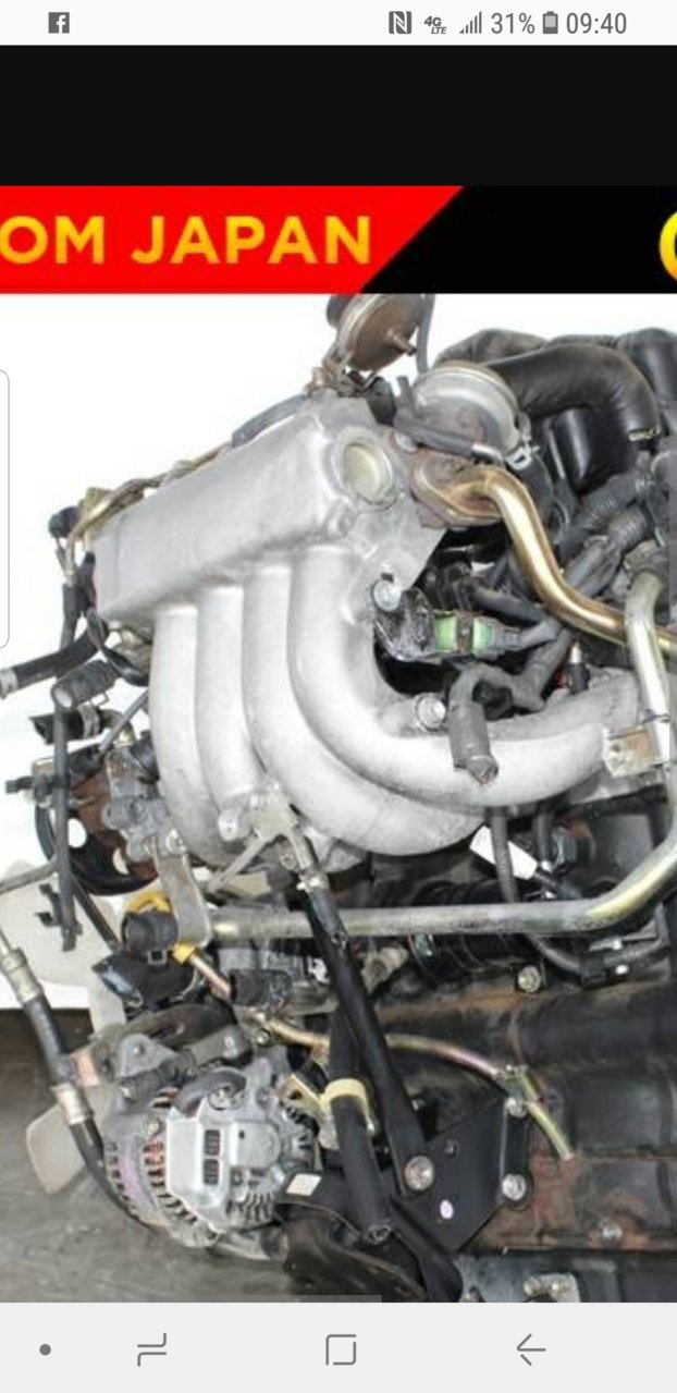

    So after looking at pics, it appears that the jdm intake manifold does not split like out USA ones, so I ca t just split them and use my top half. The motor is a 4 port and my intake is a 8. Did any of you use the JDM intake on the motor with USA harness etc?
  14. Jan 11, 2019 at 6:40 AM
    mataco4wd
    mataco4wd Well-Known Member
    Jun 2, 2016
    #188515
    169
    994wd
    Some I'm basically screwed and need to find an 8 port correct?

    Your jdm 3rz intake split? Not like this one shown above?

    When I got my JDM motor the intake DID NOT split I had to reuse my Intake

    You can see if you can find a use 4 port intake from a US motor. I've read of guys using a 8 port intake on an 4 port head with success. I've never tried it myself so I can't speak with personal experience. It could be something you could try out yourself if you're willing to experiment.

    I'll take a picture of my current intake and i think i have a picture of the original intake to compare but both of them split.
    Do you know some information about the motor such as what vehicle it came from/year it is? I looked at pictures of motors for weeks before i settled on the one i thought was exactly like mine but 3rz has many versions out there and when i got the motor i had quite a few things i had to swap from my original motor: top intake manifold, oil pan, oil pick up, crank pulley. Once i got it in i used the original exhaust manifold and was good to go.
    The only reason i used the original top intake manifold was because the jdm one was damaged and i iust swapped them and put new gaskets in and I was ready to go.
