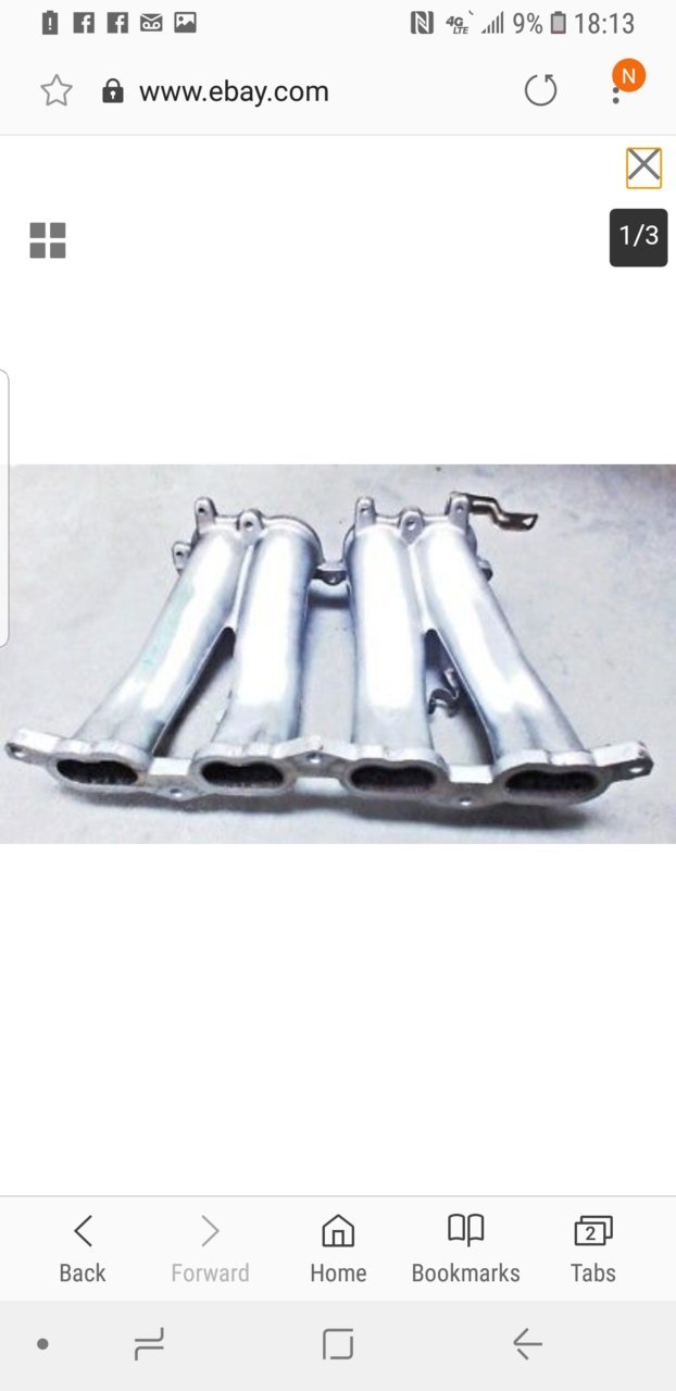

    Nvm so since I need a coil type, they only come with electronic TB. Does the USA TB bolt to the JDM intake? with USA harness?
