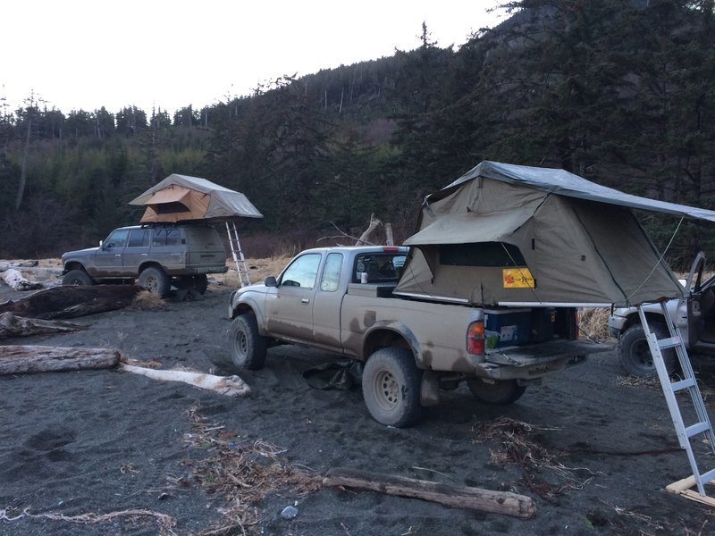

    Just like you were saying, had to swap all my old accessories into the new motor for it to work. But just did a 8 day camping trip in the bush and put around 2000km and it seems to be running good!
