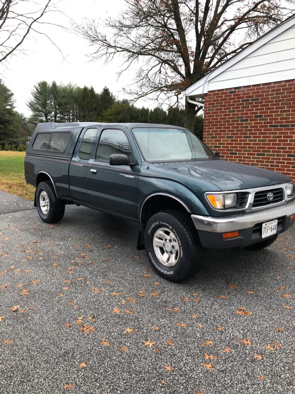

    Here is my 96 Tacoma that was given to me by a family member that bought it new. It's a V6 extended cab 4x4 auto with 172k on it. It was a "spare" vehicle for them for many years and is in need of some love. Overall plans are fairly mild:

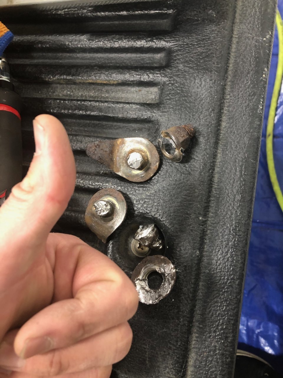

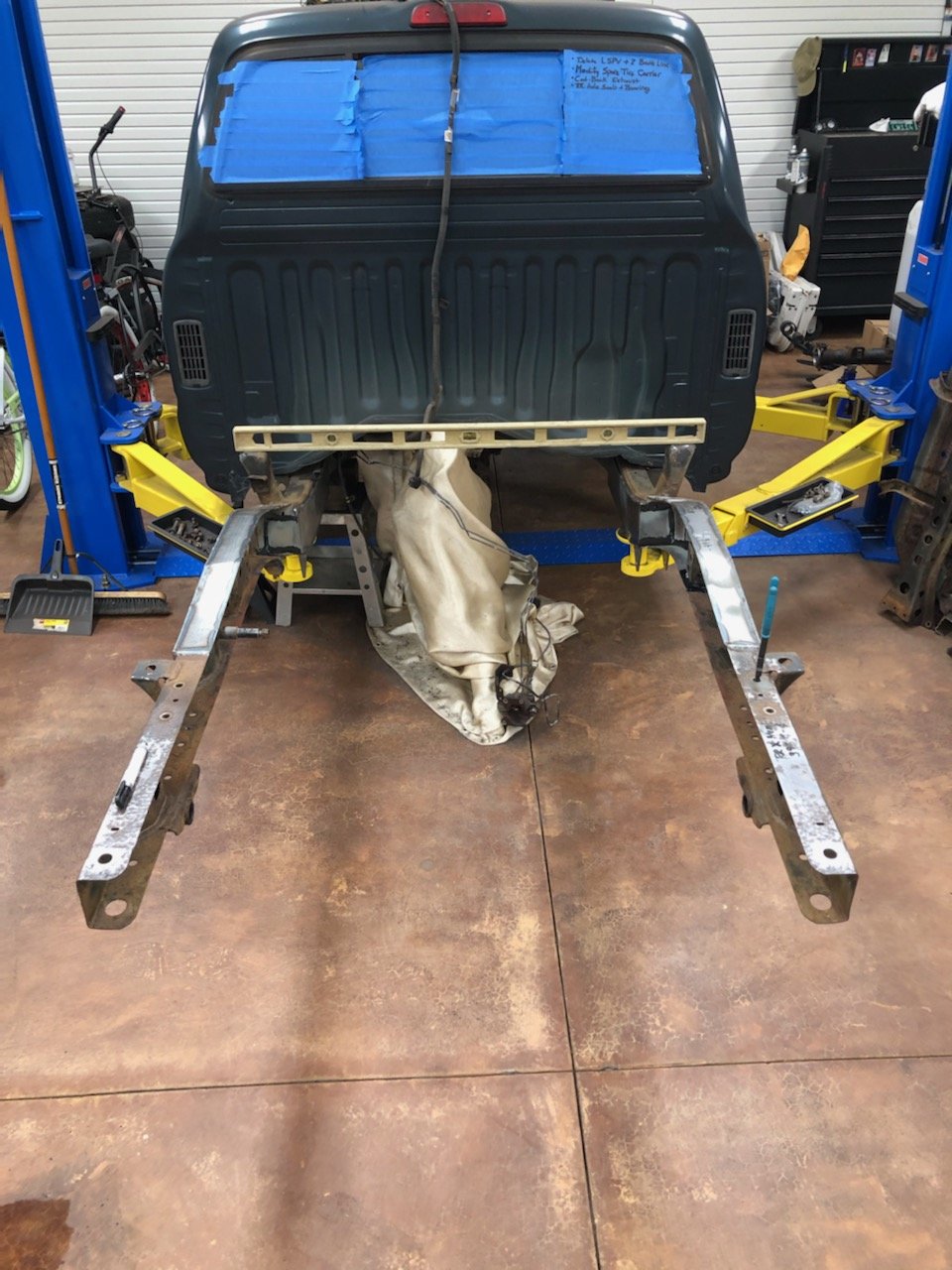

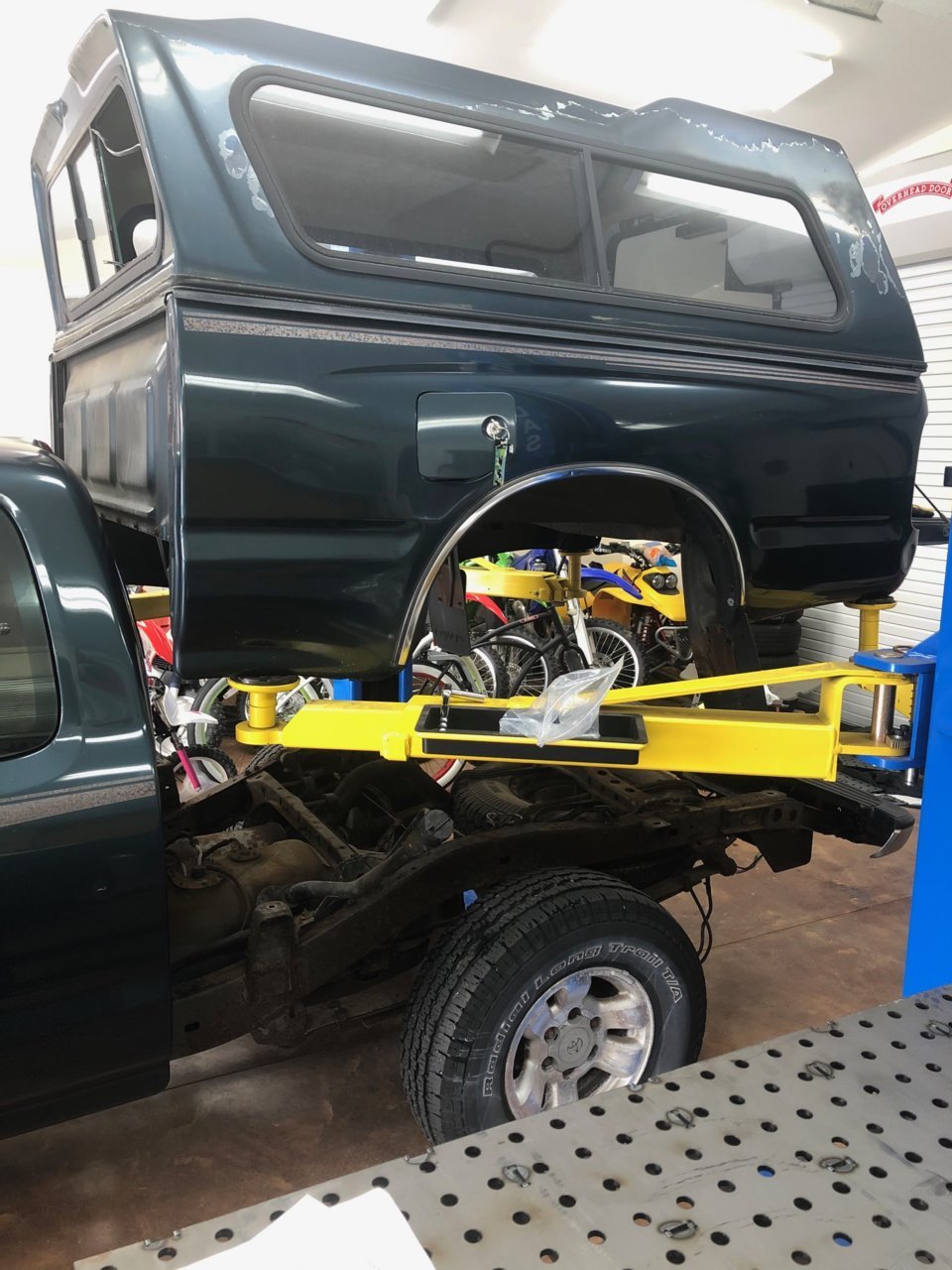

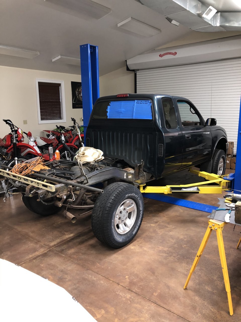

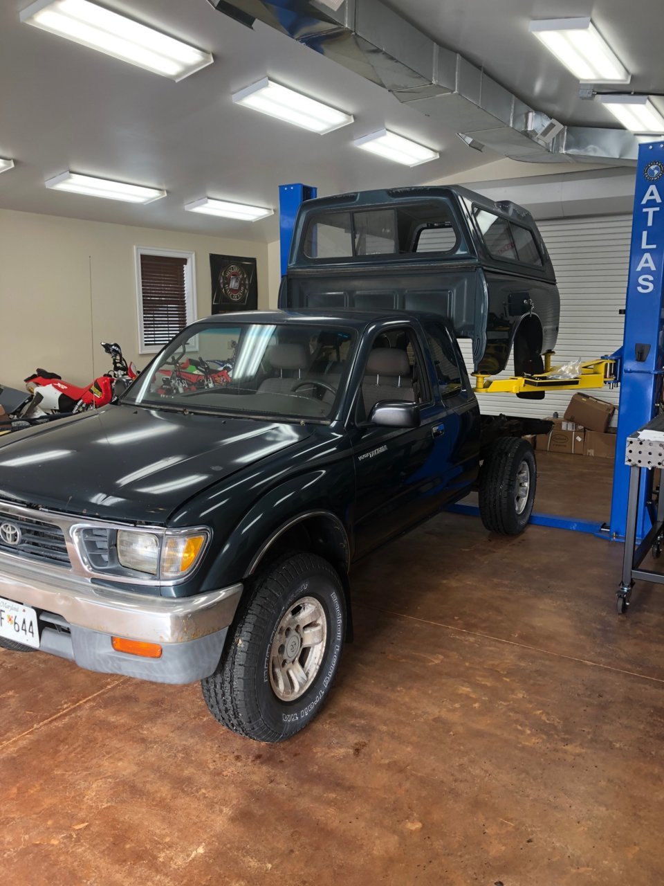

    Bed Removal on these trucks is pretty easy normally. The two rear bolts (what was left of them took a few extra minutes) to get off.63008180547__3ABABB9D-6E82-4CC8-A1A1-D4E04546DDDB.jpg IMG_5210.jpg IMG_5211.jpg IMG_5212.jpg

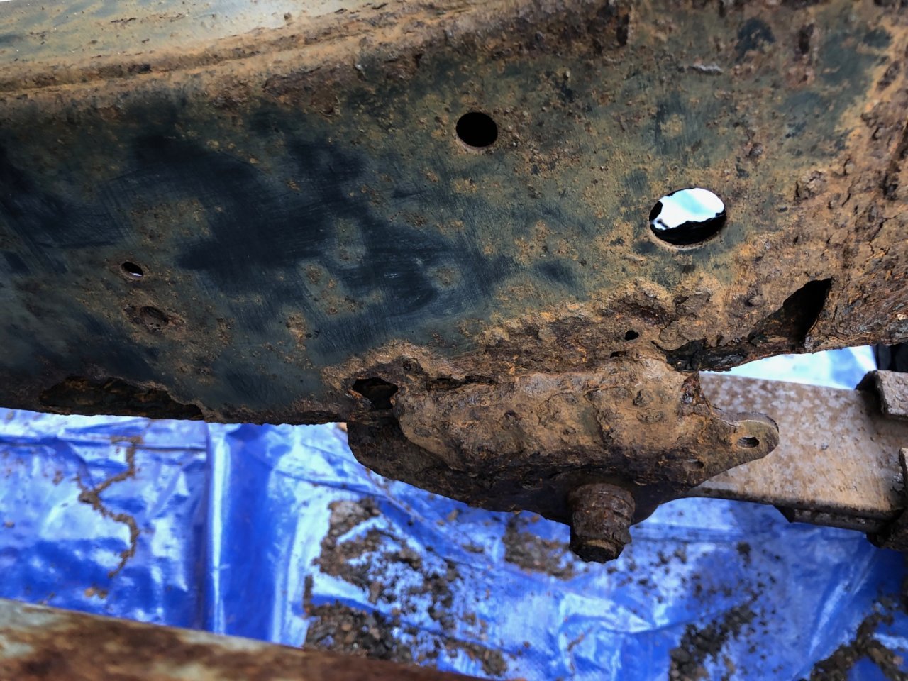

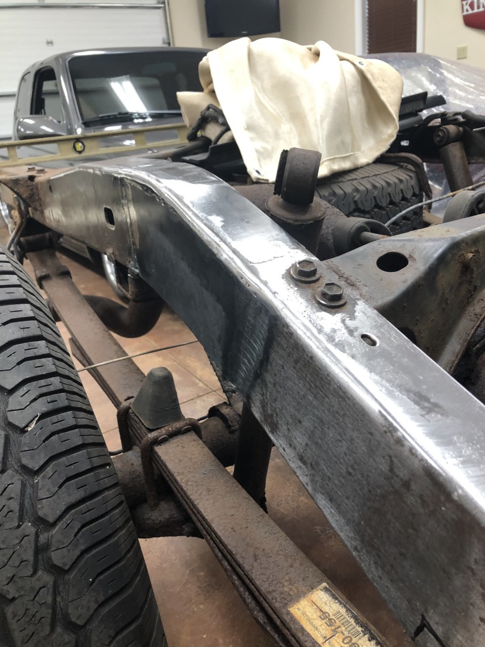

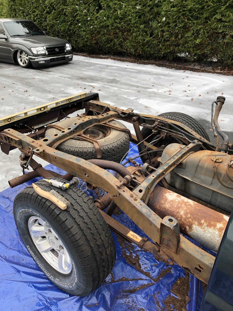

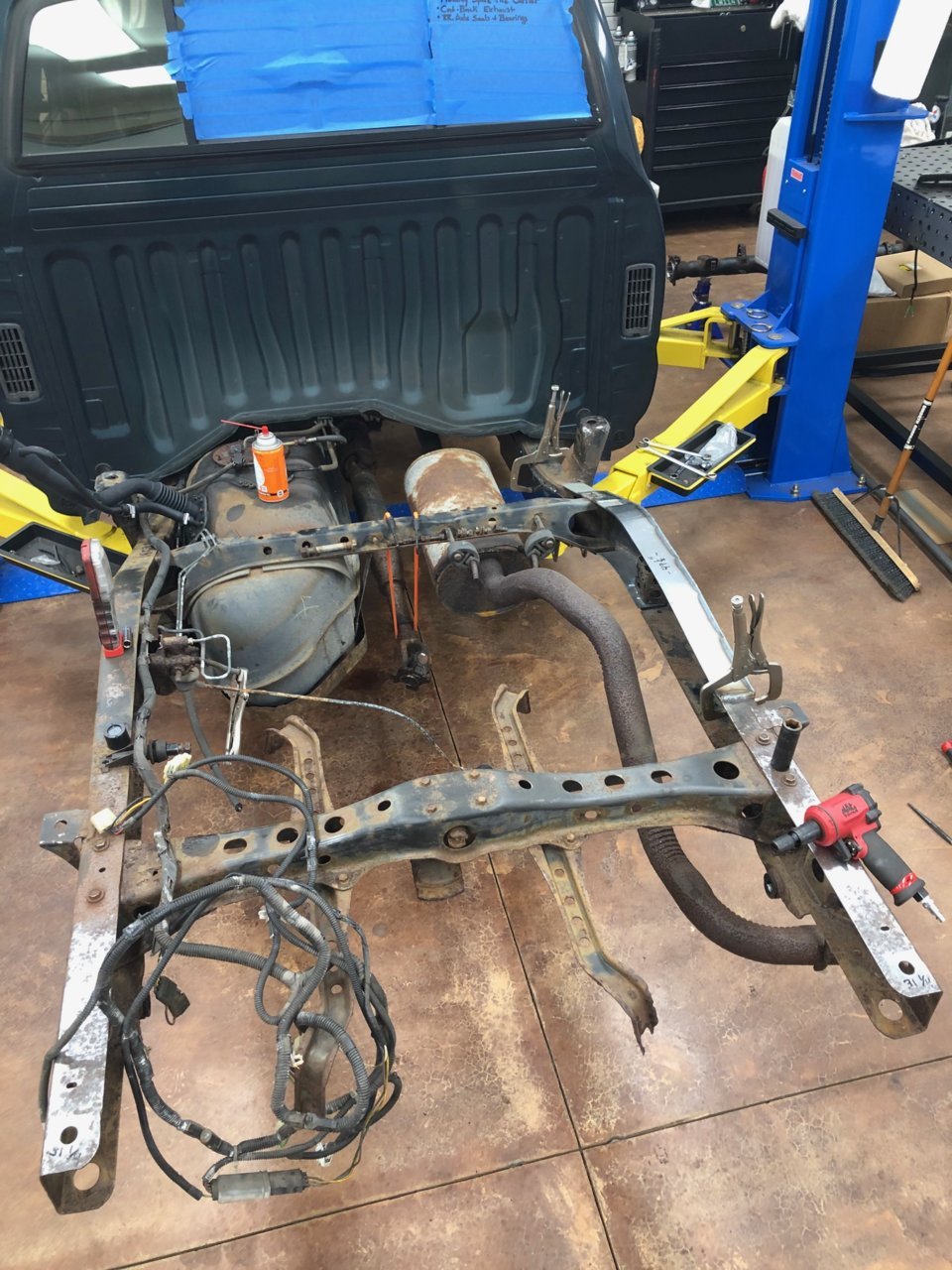

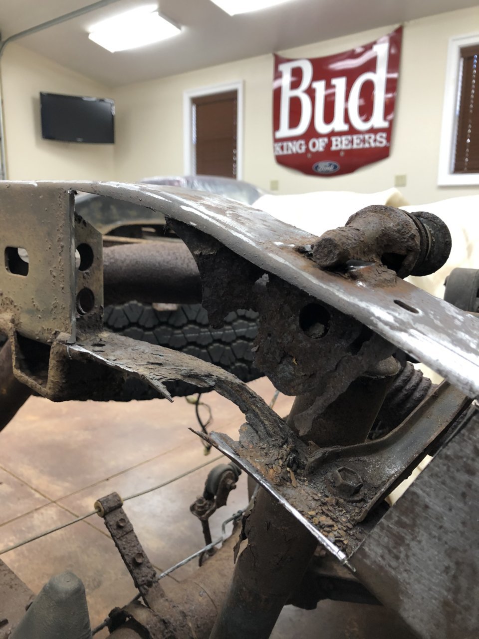

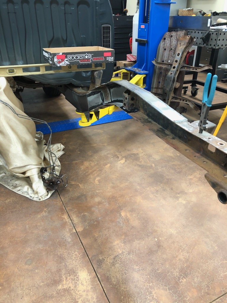

    Had some time to go over the rear of the frame better with a wire brush, needle scaler, and a hammer. Main issues are at the rear shock mount and the leaf spring mount. Welcome to the northeast..IMG_5223.jpg IMG_5224.jpg IMG_5225.jpg IMG_5226.jpg

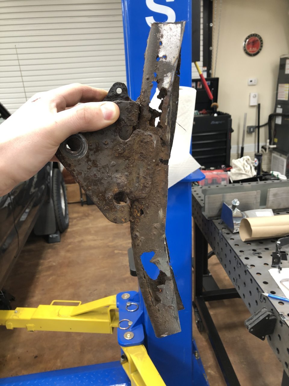

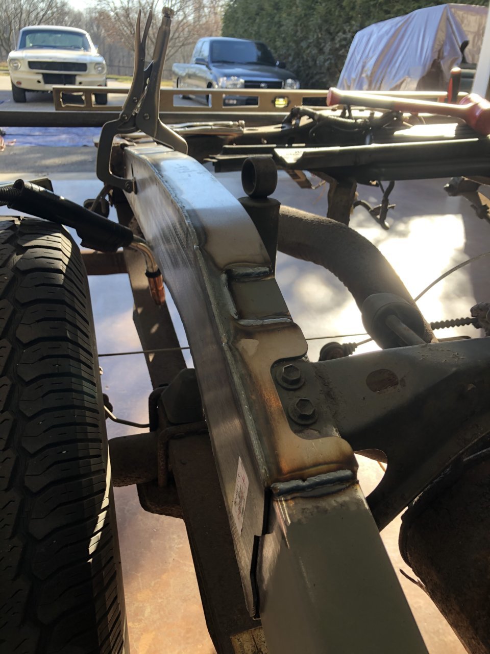

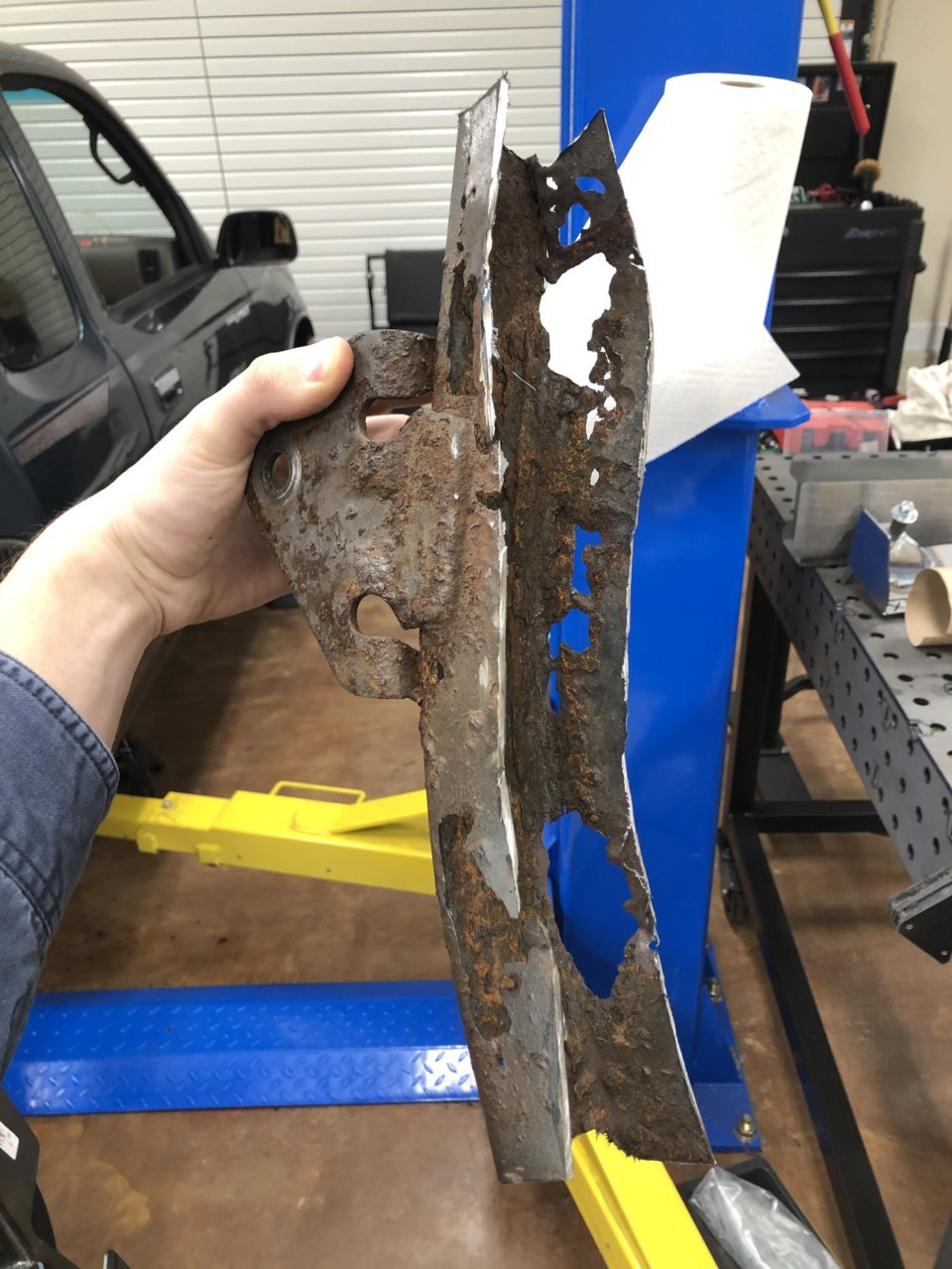

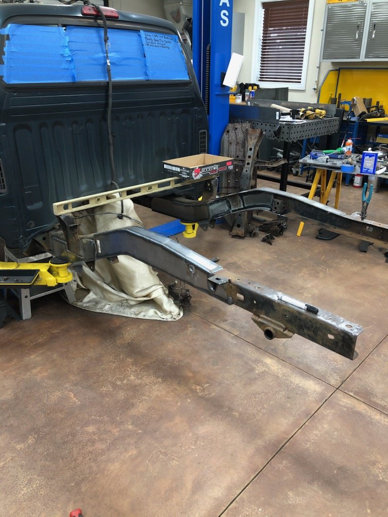

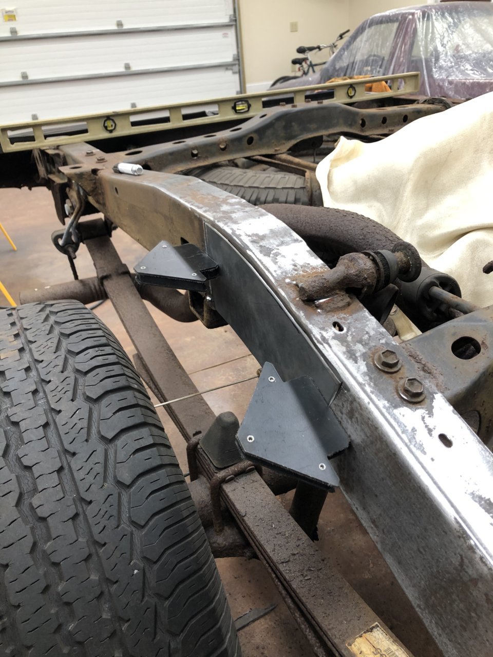

    Since I plan to use safety caps on the right side rail, I still want good metal underneath the caps. Also, 11 gauge sheet is the same
    Thickness as the frame. So I got to work cutting out all the junk. .C2F73678-9B7F-4943-9D3F-46BA0DE2BB91.jpg25B4CE4D-51BC-4A80-A605-811304BC32E6.jpg4D33B665-DBDF-43AF-B504-F79AE10AA59D.jpg

    I am pretty impressed with the quality of the safety caps and how they fit. It’s definitely will make this job much easier. It’s been a while since I’ve ran my mig welder so getting some time on that again is nice. It’s taken a back seat since I got my tig a couple years back. C000E78E-299E-423B-8A64-D4ADEFA4B7DF.jpgHere’s the last part of the rotted frame. Once I removed this and blew the frame out (compressed air) it’s actually very clean inside which was a relief to see. CB7FCB4C-08EE-472F-892A-F10C321D764B.jpgCA5FBAAD-AB54-4E24-914A-5441C56F26A8.jpg4F46867F-C27A-4A26-83A5-4DBC2E089B17.jpg This is where I finished up this past weekend. I still need to weld the safety cap under the cab but the leaf spring section is finished welded as well. I am awaiting my lift kit still but hope it will come along with the other parts this week.

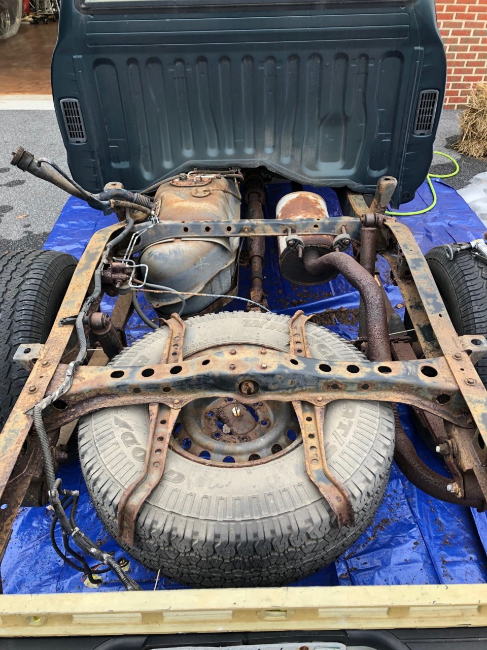

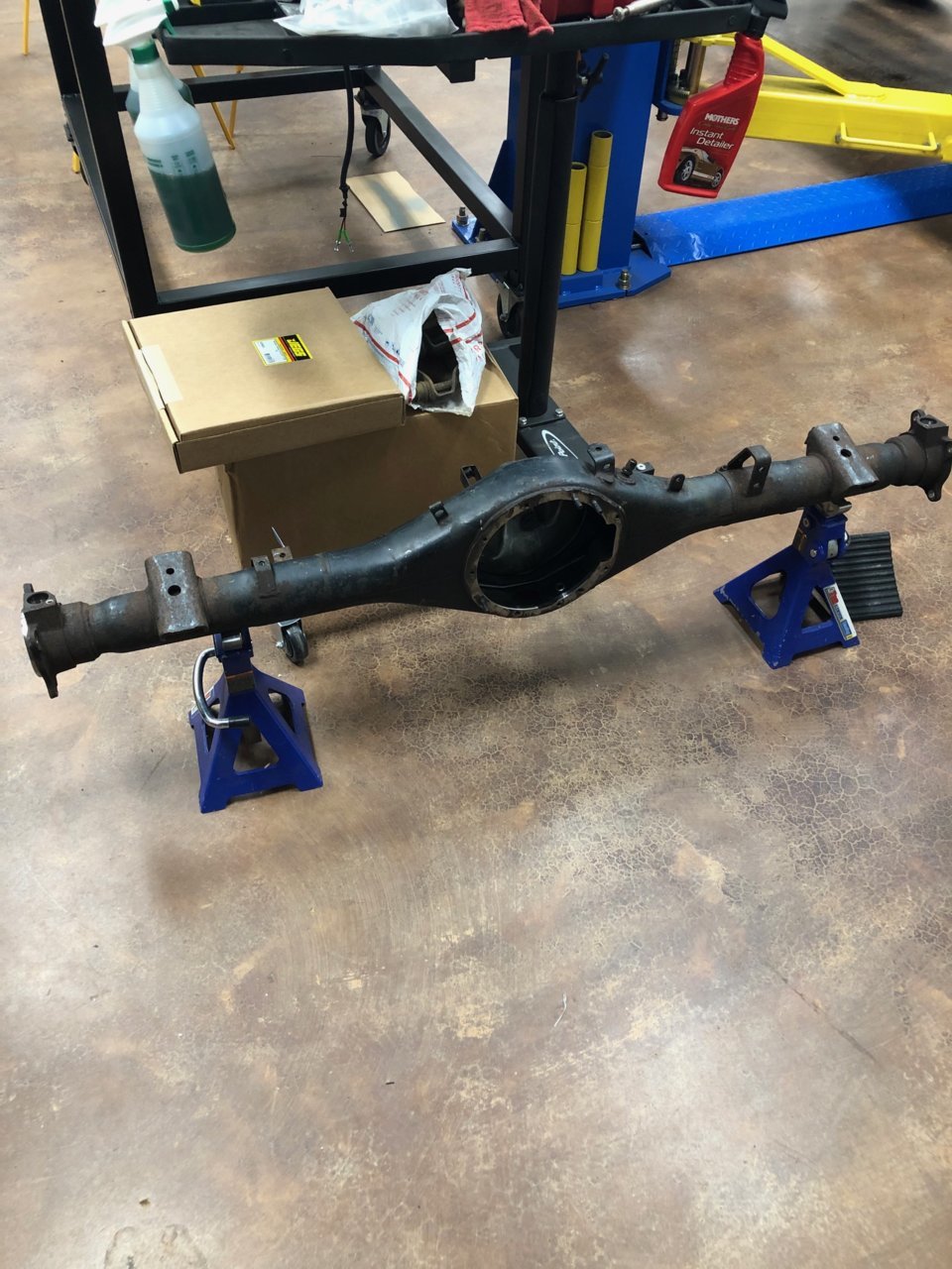

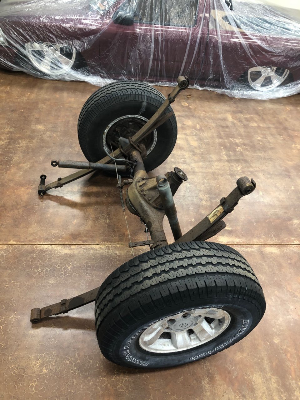

    This weekend very little progress was made. Some of the parts have showed up including the rear disc brake setup, brake lines, and some factory rear axle bearings and seals. I got a call on friday that my lift kit from Wheelers was shipping out. I should see that late this week.
    I did get the rear axle pulled out, exhaust out, and I have the front bolts on the gas tank sitting in Kroil now. Hopefully they wont break. So far I have only had one bolt break on the entire project so far. I should be able to get out in the garage this week between hanging out with my newborn son to get the tank dropped and the 2 rear cross members out. I have a glass bead cabinet that I will blast them in and some of the smaller parts that need to be cleaned up.IMG_5395.jpg IMG_5396.jpg IMG_5382.jpg

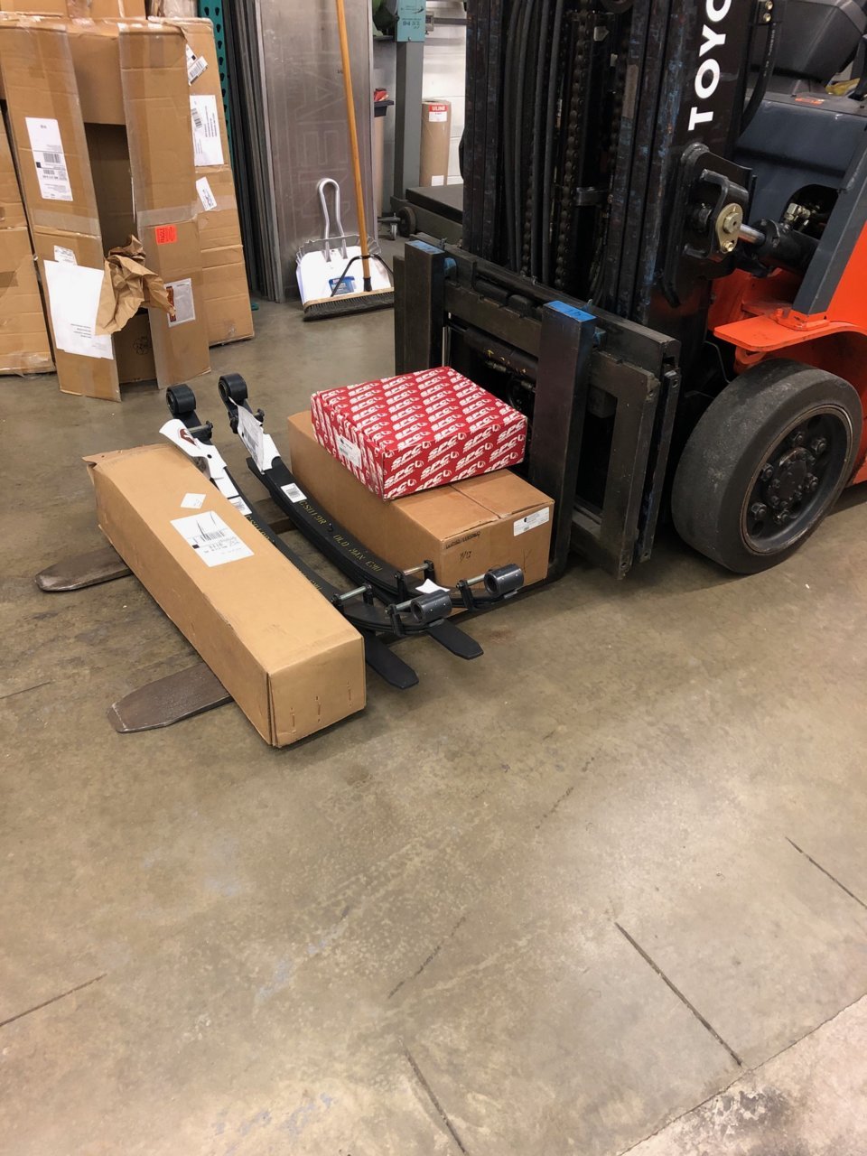

    Not much exciting progress made this past weekend on the truck. Got the fuel tank out, the rear cross members removed and glass beaded. Found a small rust spot on the left frame rail above the front leaf spring mount that was covered by the parking brake cable. While this was unexpected, I went ahead and ordered Safe T Caps for the left side rail as well. Might as well do it all now and never have to mess with it again. Those are supposed to arrive today or tomorrow (Fingers Crossed)

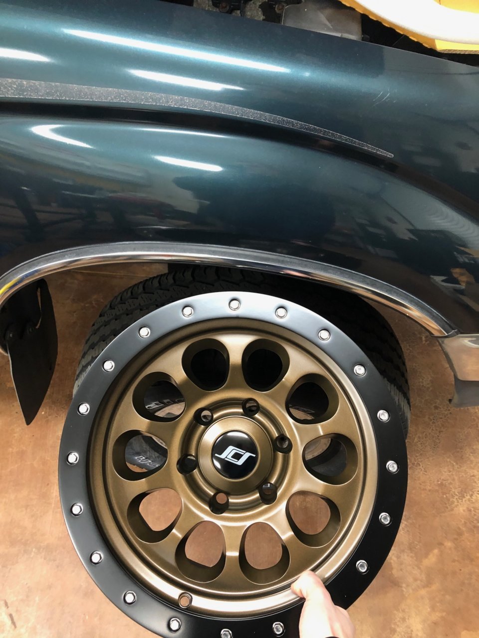

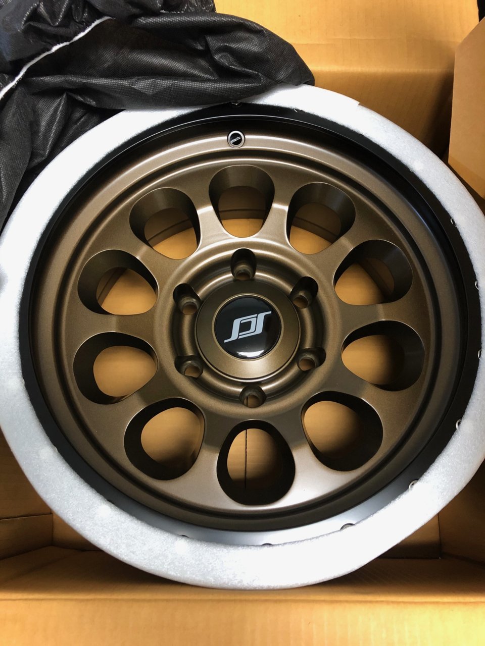

    So parts are finally starting to show up. Got my lift kit and wheels in this week so far.IMG_5443.jpgIMG_5435.jpgIMG_5439.jpg

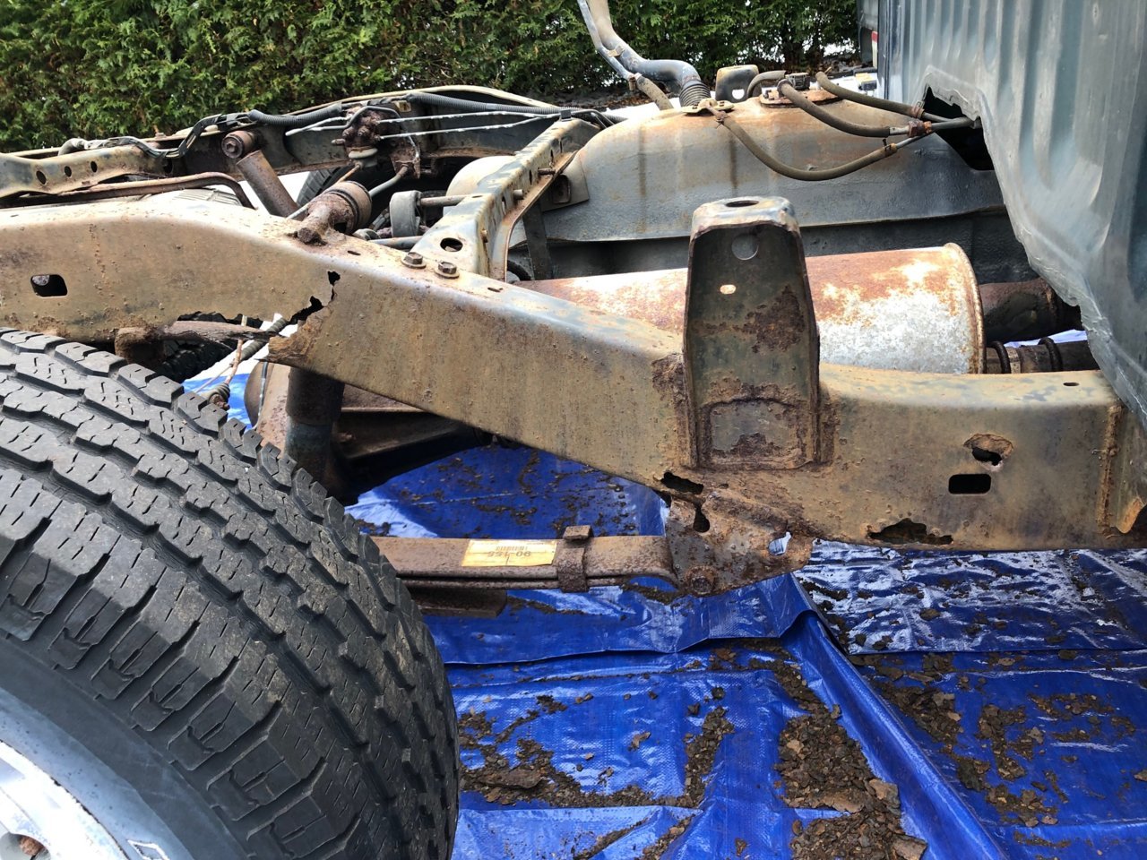

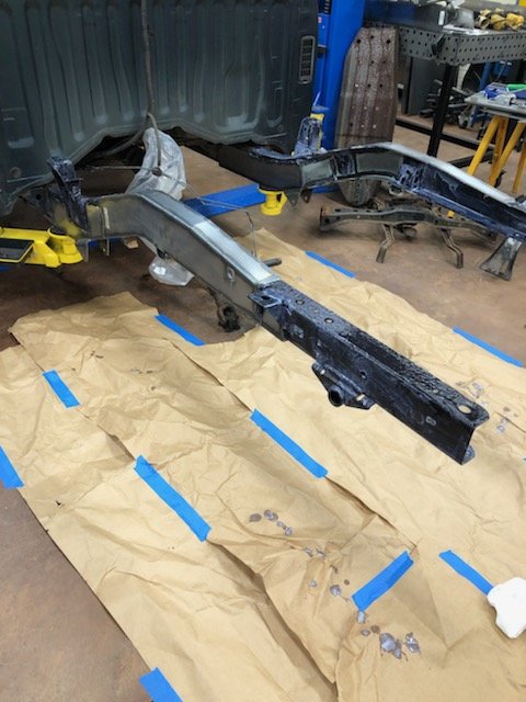

    Few updates. I got the both rear rails all cleaned up and got the safe t caps welded in.

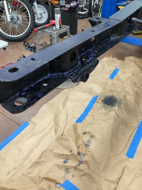

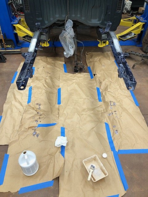

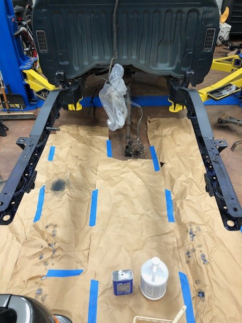

    I have heard great things over the years about Corroseal and never really had a truck that was in need of it...until I got this truck. It was the perfect experiment. I had some time last night to brush it on the rear rails. IMG_5501.jpg
    IMG_5500.jpgIMG_5507.jpgIMG_5505.jpg I am using some east wood products on the safe t cap metal as well as a satin chassis black over the whole frame once the Corroseal is good.
