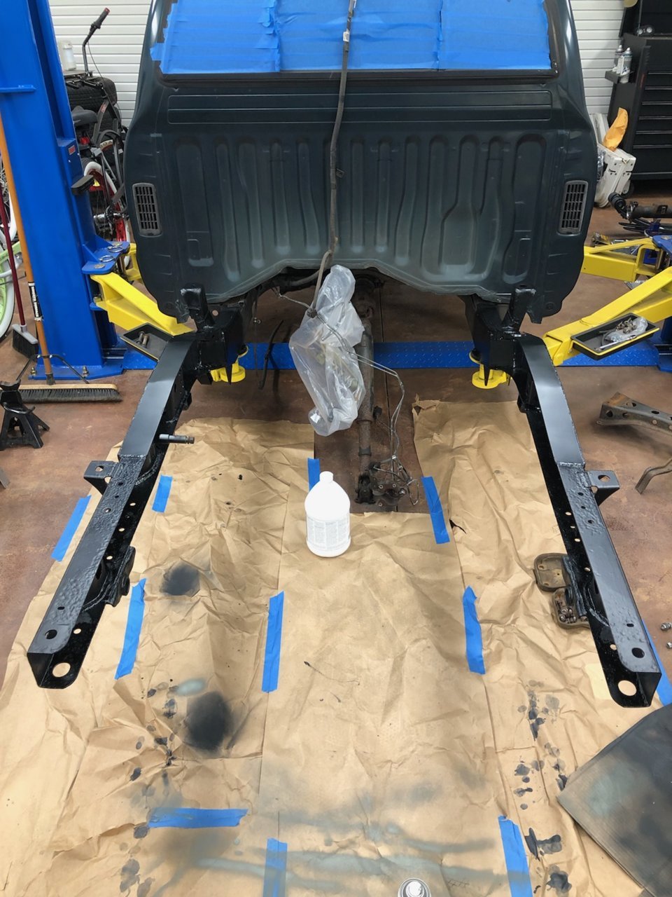

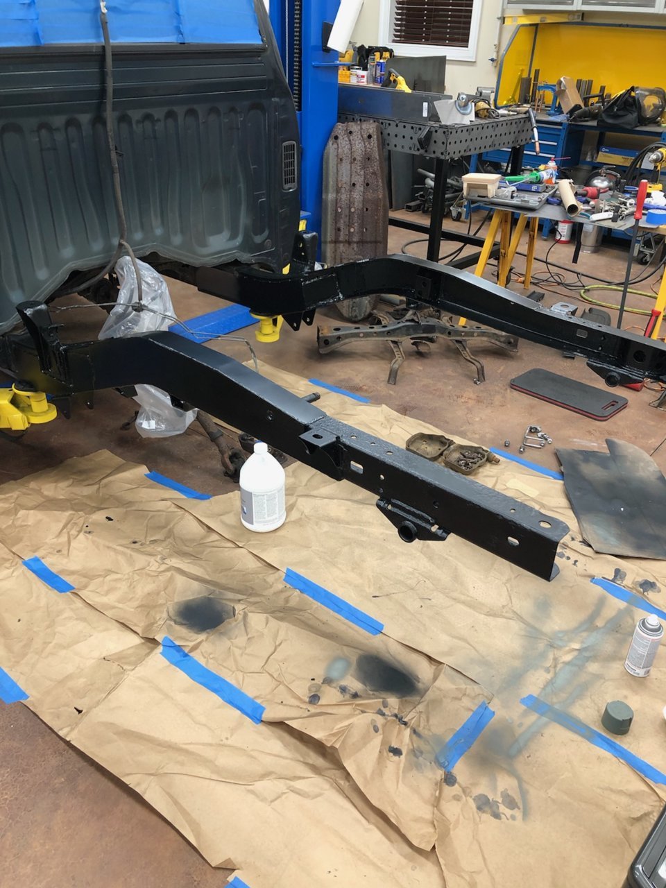

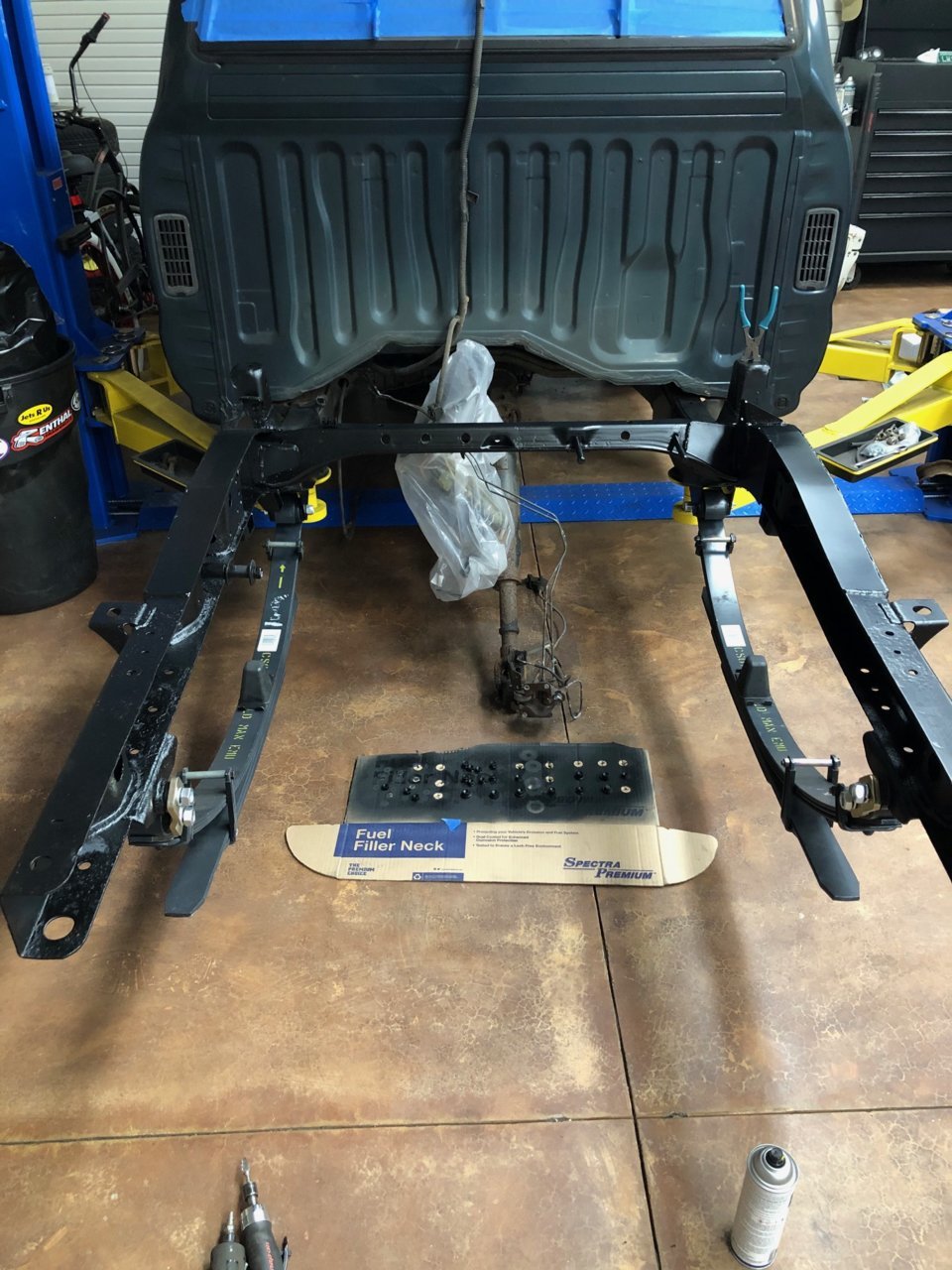

    Had a snow day yesterday which turned out to be about 4" of Ice. I closed my business for the day and got a little further on the truck..
    Painted the back half of the frame and it turned out "decent".IMG_5514.jpg IMG_5515.jpg
    This weekend I should be able to start assembly on the rear of the truck.

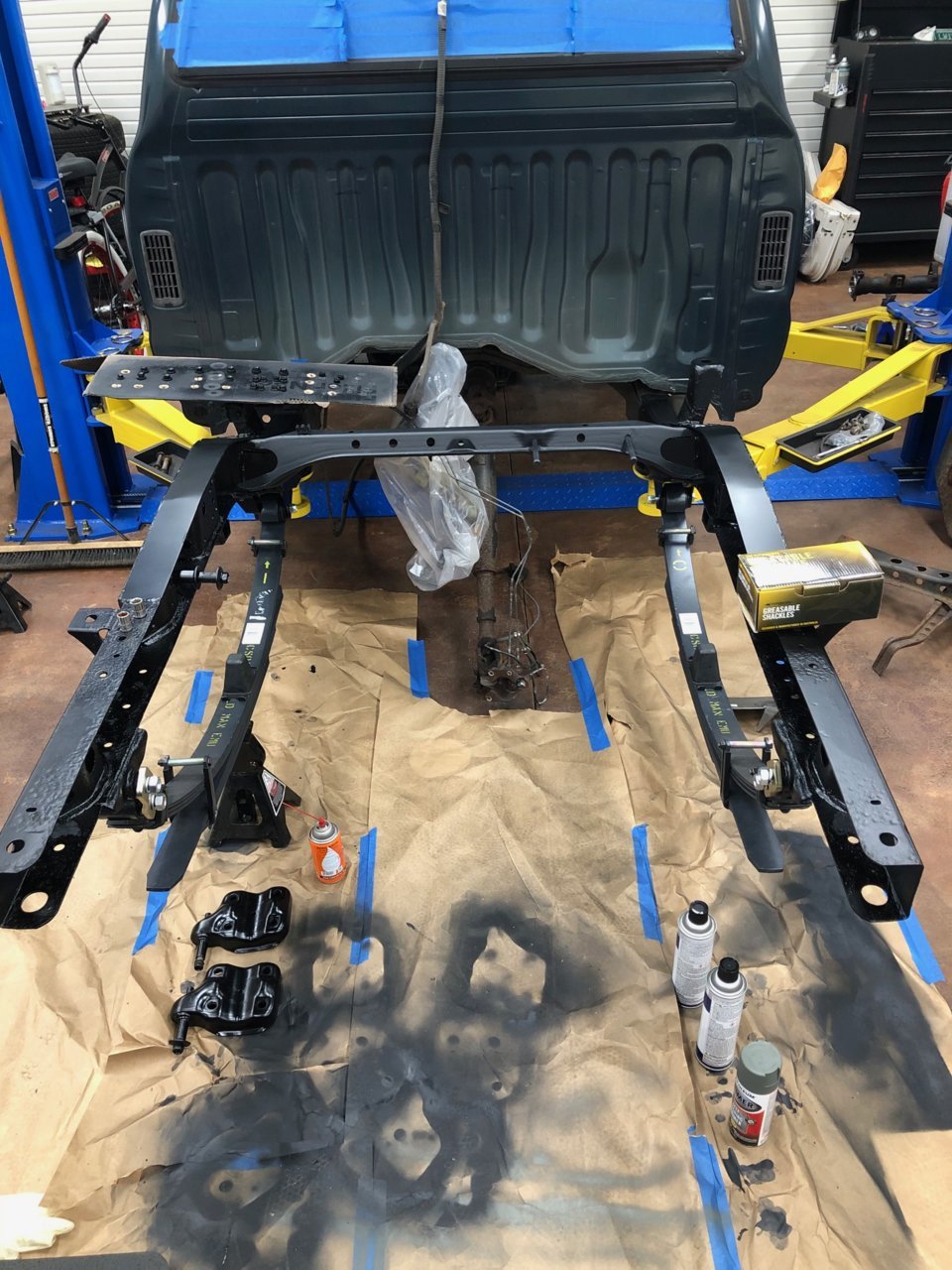

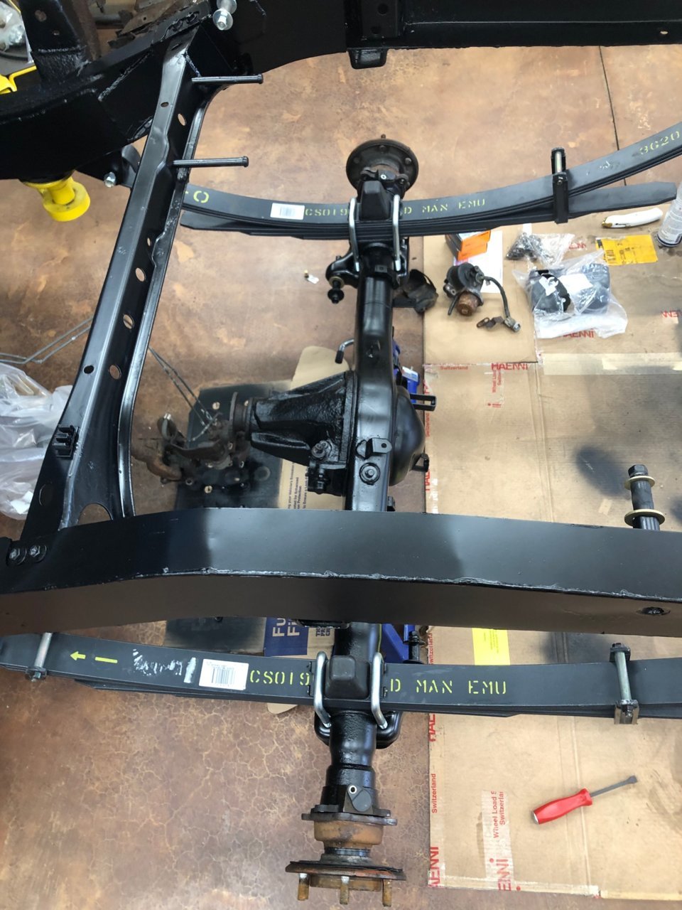

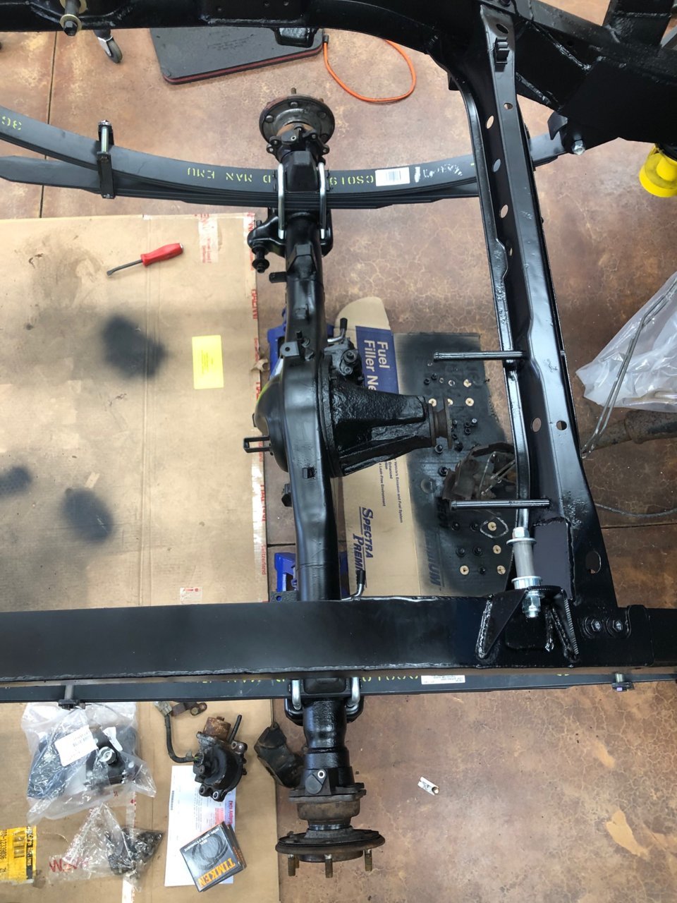

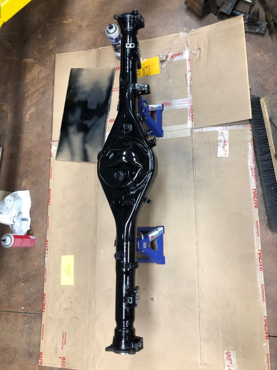

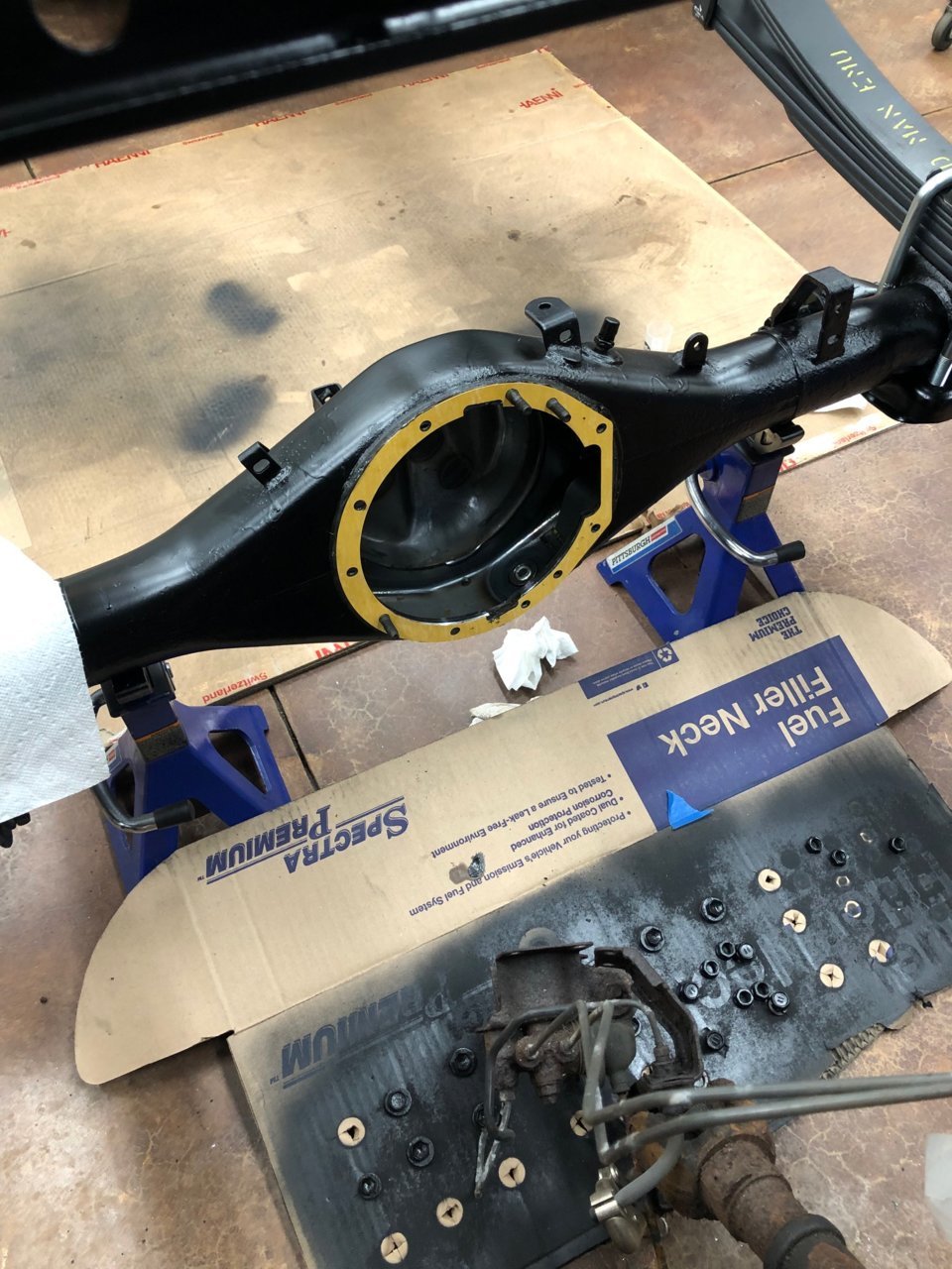

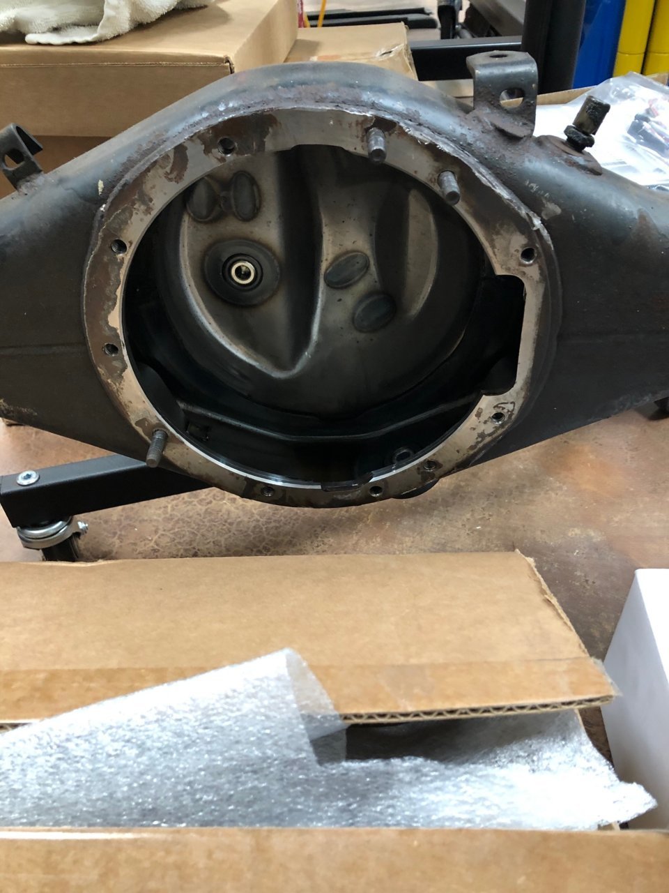

    Well, I took a weekend off last week to head to Lone Star Throwdown in Texas for a truck show. It had been a couple of years since I had been and I was dying to travel somewhere and hang out with friends.. This past weekend....
    Assembly started this weekend. I blasted most of the old hardware and painted it. The Gas Tank crossmember is in along with the upper right shock mount welded in. (this is where this mess started from) I did get the axle stripped and painted as well (satin black). I am awaiting my toyota parts order to come in today. New Axle Seals, O-rings, Bearings, 3rd member gasket and pinion seal were among the stuff ordered for the rear of the truck. I did order lower ball joints and some misc other items for the front end of the truck while I was at it. Thankfully my dad has an automotive repair shop, so I get discounts at pretty much any place I go. Should start coming together now.IMG_5611.jpgIMG_5617.jpgIMG_5628.jpg IMG_5627.jpg

    Makes sense, and seeing that freshly painted axle housing has me wishing I took the time to do mine.

    Slowly but surely, this thing is coming along. I got the rear back in last weekend, along with removing the old backing plates, and pressing new bearings and seals in. This weekend I will install the rear disc conversion and finish modifying my stock spare tire carrier cross member.IMG_5721.jpgIMG_5719.jpgIMG_5718.jpgIMG_5722.jpg

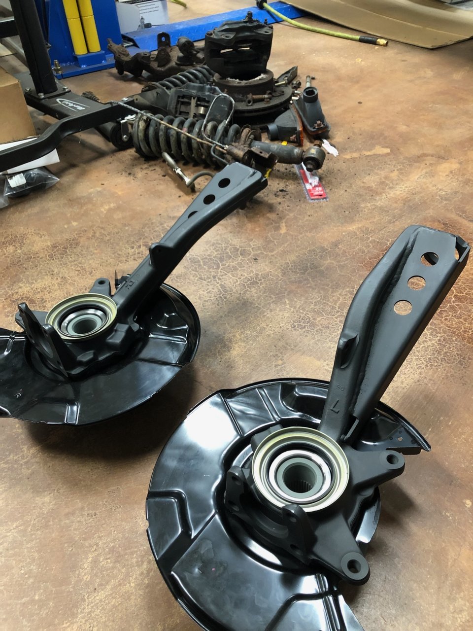

    Thanks man, it definitely has taken some time to do but its coming together. With the spindles I have seen some people talk about them bending. While I was there I just figured I would do it. Inexpensive as compared to the cost of replacing of finding good used spindles out there.

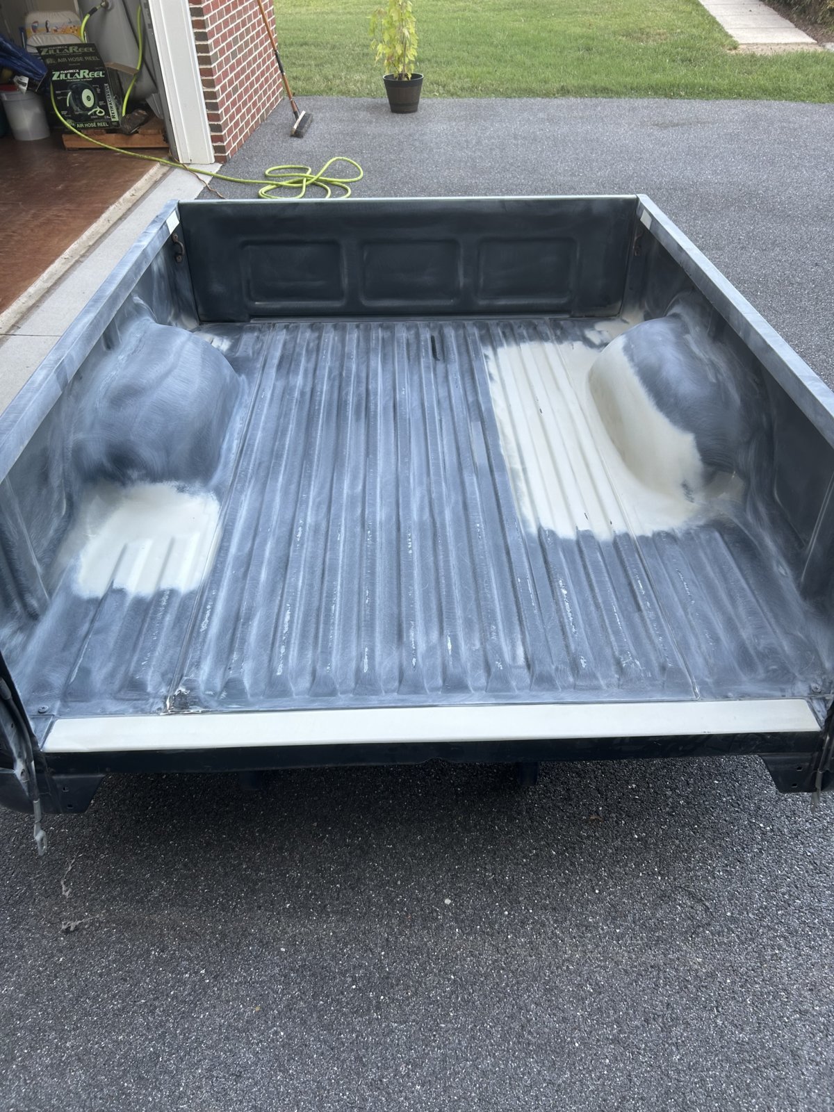

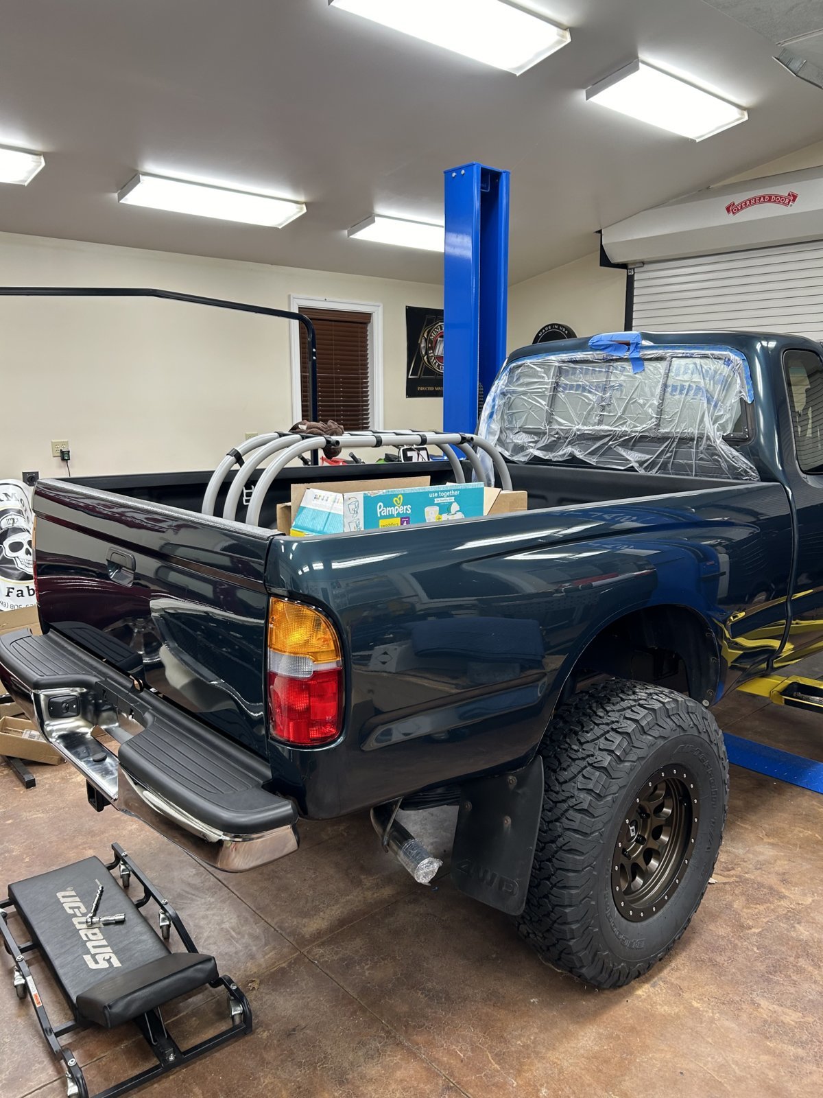

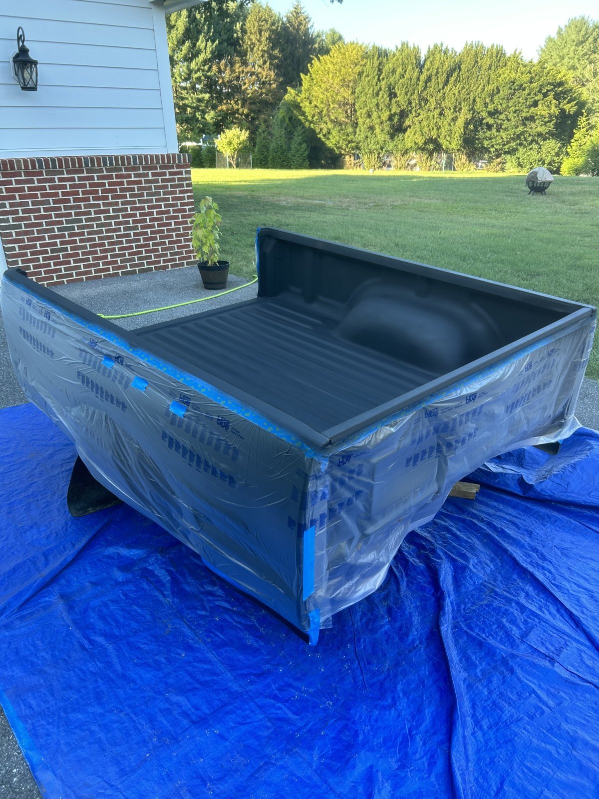

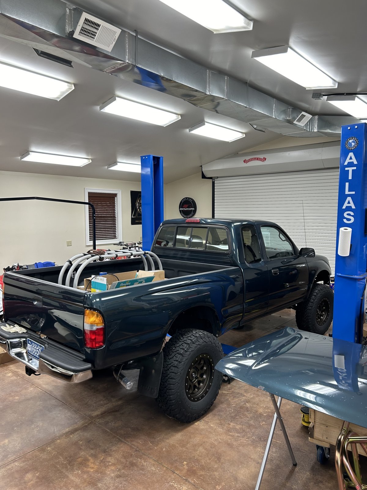

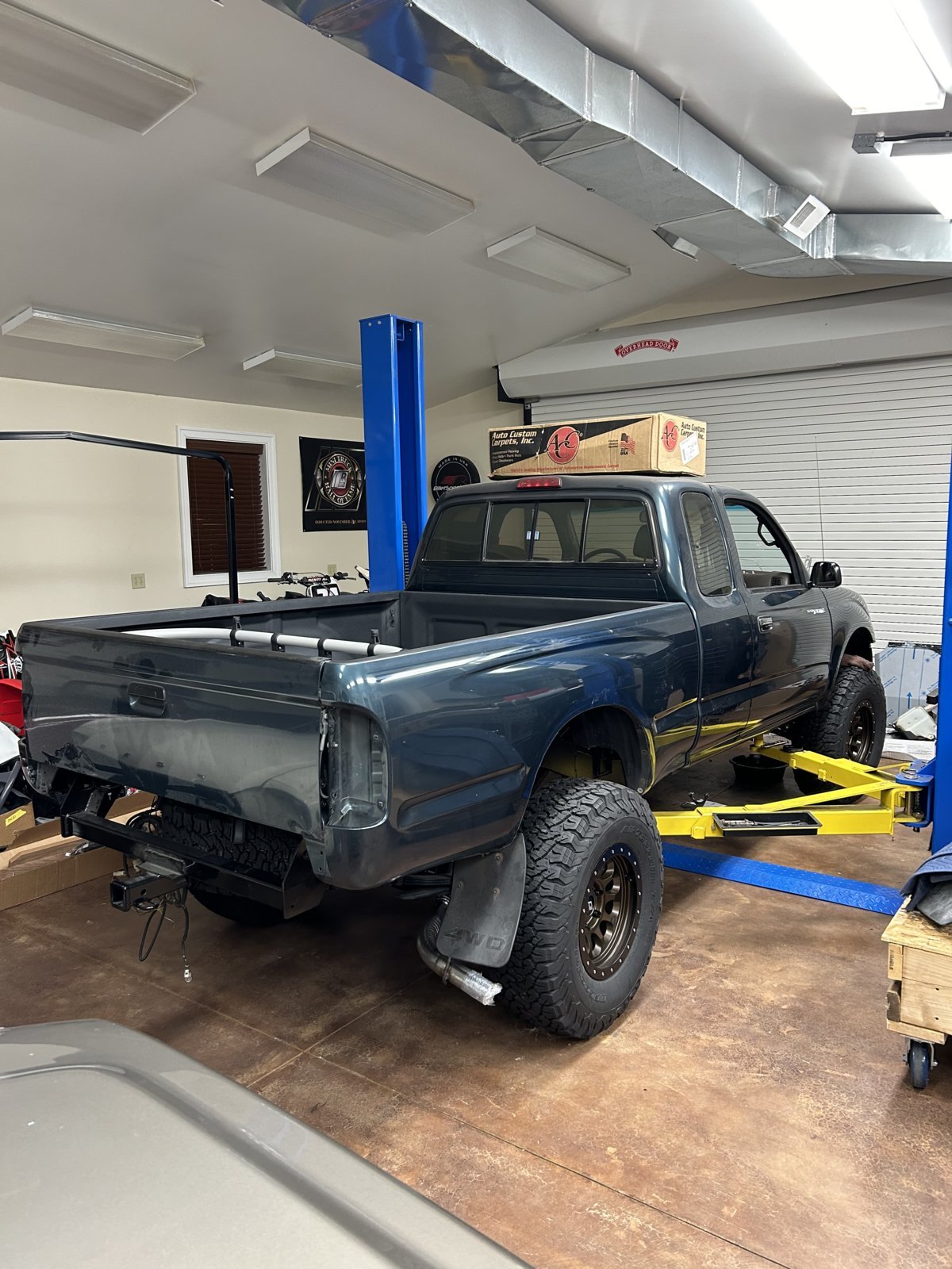

    IMG_0518.jpg I find it hard to believe 2 years has gone by since I posted in this thread. Kids, work, etc pushed this thing off and delayed the finishing but I am about 85% complete at this point.
    The first picture is how the truck has been for a little bit now. Repaired the spot of rust in the bed, Raptor lined inside the bed as well as the underside. Finished up all the brake lines, rear disc brake conversion, new exhaust, full size spare underneath the bed (285/75/16). Another item on the list was to fix the slow water leak which I believe to have been the wiper cowl, so I cut that open and seam sealed everything that could be.
    The paint being 28 years old at this point was pretty tired from sitting out for all of those years. Surprisingly, no clear coat pealing. I had my brother sand and polish the paint to get it to look its best. This is the best side but I am pretty happy with the results. I ordered factory striping for it which was the copper nugget color. Once I finish installing it I will have my brother seal the paint. Then a date with the local PDR guy to pull some of the random dings and dents.

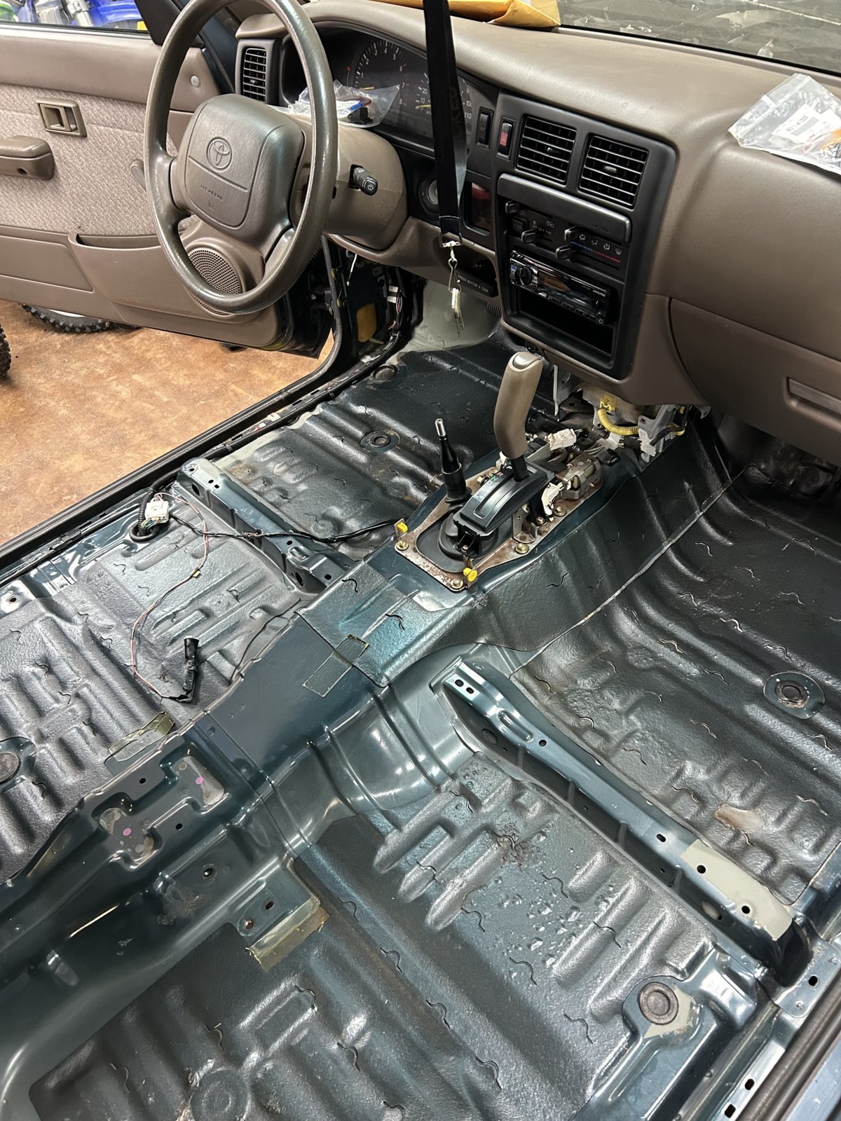

    Now that the water leak is squared away on the passenger side, I removed all the old carpet, and am replacing it with ACC with the mas backing. Should freshen the interior up nicely.
