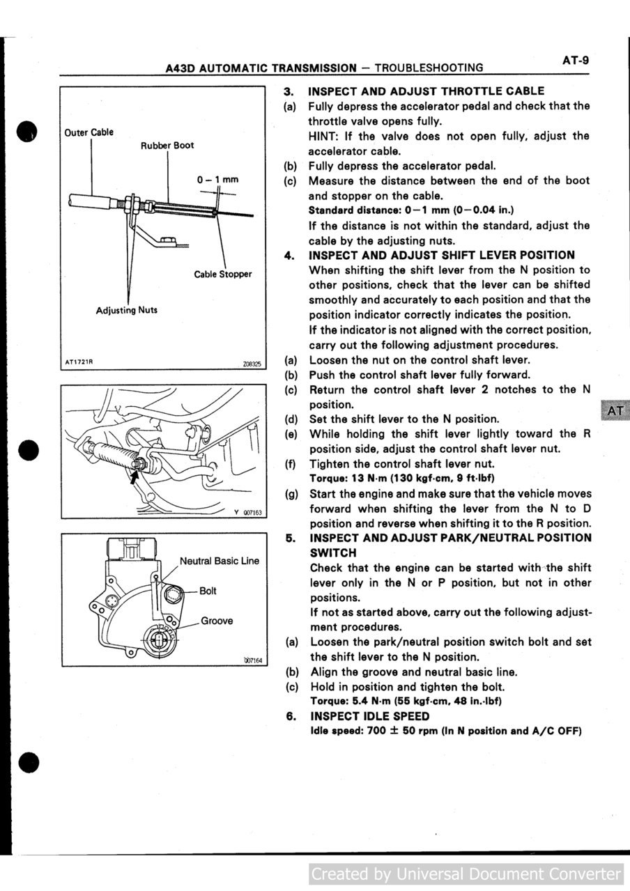

    Have you checked that your TV cable is adjusted properly and not sticking?

    Thanks for the PDF. I have not checked this, I will start there. Are these symptoms indicative of a maladjusted throttle cable?

    Yes, the TV cable controls line pressure and shift points, the farther it is pulled the higher the line pressure and the later it wil shift. It shouldn't be adjusted to compensate for a problem but it needs to be adjusted and working properly for the transmission to operate correctly.

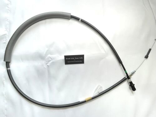

    Hey again. Thanks for your help on the TV cable. So, I did some diagnostics and it appears that the culprit is in the kick down cable running from the throttle to the left side of the trans case (if you're looking at it from the front of the bell housing). The cable appears to not be retracting all the way to engage the pressure adjust valves inside the trans case. When the throttle is at idle, the kickdown cable has a noticeable droop and is not taught. The crimped ferule on the twisted steel wire is out past the adjustment/mount bolt by a good 1"-1.5".
    I disconnected the cable from the throttle and lubricated the steel cable using a syringe and large gauge needle. The cable was not stuck necessary but was not easily pulled/retracted. At max throttle, there's no way the cable can retract back into the transmission appropriately. No amount of adjusting the nuts at the mount point would correct the issue; there's THAT much extra cable sticking out.
    I tried to remove the cable from the transmission side to investigate there, but I didn't have time. I noticed there is a wire connector right in front of the point where the line enters the transmission, and I didn't see any obvious way to disconnect the line. Do I have to drain and drop the pan in order to see/investigate what's going on in that area?
    If it is relevant and helpful at all, I think I know what caused this issue to present itself. This is my daily driver and I rarely ever drive it more than 5-10 miles at a time, and always in the city. Right before this problem began, I had to drive ~80miles on the interstate at higher speeds/more throttle which, if I am imagining it right, would keep this kick down cable pulled out. That trip was the first time I had driven the truck that kind of distance in years, and probably the first time the truck had seen those speeds/max throttle in just as long. Hopefully that will help you help me.
    Thanks a million for any information or suggestions you might be able to give me on how to remedy this issue/diagnose it further/etc. :help:

    Your post has motivated me to go ahead and replace that cable...it sits above the exhaust manifold....so its slowing cooking.
    Even after wrapping in a silicone jacket....
    The tranny is super sensitive to the free operation of that kick down cable....
