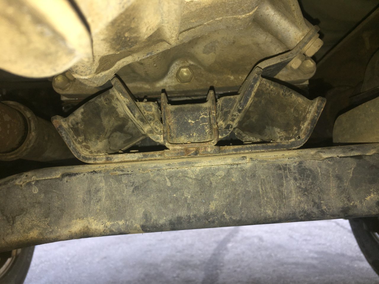

    So I went to the stealership today @7:30am and boy am I glad i booked an appointment cus when I got there it looked like a line before the dmv opens, so 7hours later they told me from what they gathered was OEM trans and engine mounts and the hesitation was from my driveshaft, what do yall think? I checked my transmounts myself got like 3 different opinions on mechanics said they looked good,i changed the engine mounts myself a month ago, so thats what they told me.....
    I’ll update as I will get these installed

    They said needed oem mounts, also drive shaft was giving me hesititation from takeoff even after greasing, I just ordered the engine mounts and trans mount online oem should be here 12/20 I should have them installed next week Saturday, I also will have my new muffler installed this coming weekday, as far as the driveshaft its about $500 for part, ima take it to a shop first and see what they can do

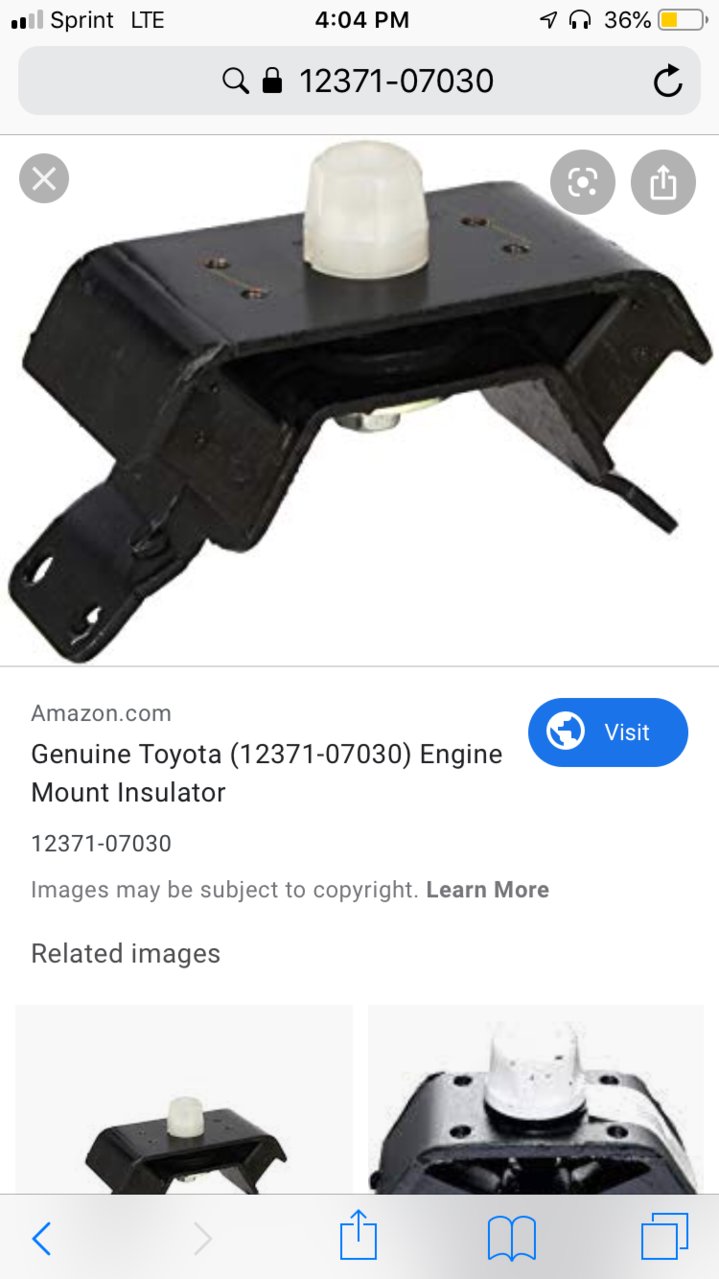

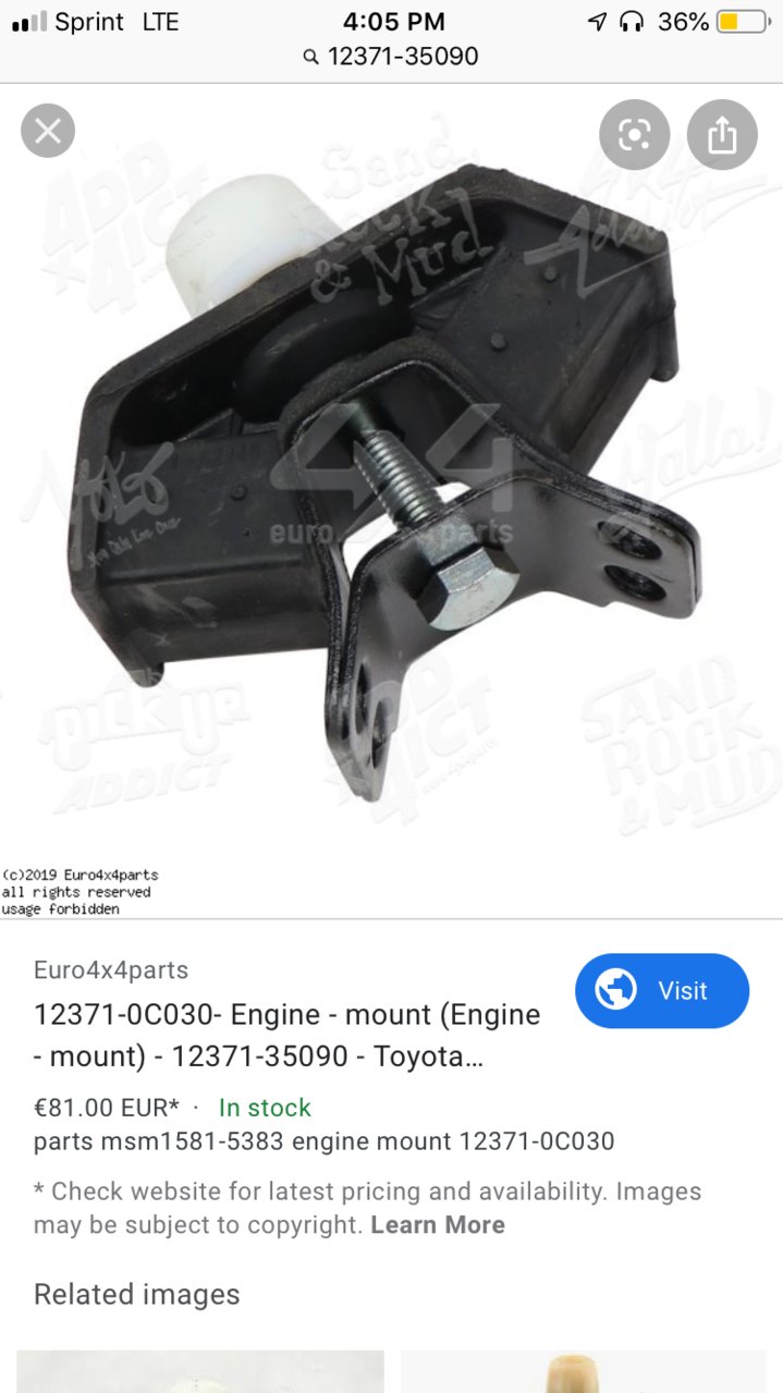

    So after ordering the oem transmount toyotapartsdeal cancelled on me because it was discontinued aswell as dealer, so I bought one off of oreilly and when getting ready to install you can clearly see they were different, i returned the part told the guy the part was wrong, but the part number12371-035090 was the correct one the one on mine looks like a v6 one but i have a 4cylinder auto..........im stumped, helpD6F17E7B-1AE2-466C-BD64-C851282C8FC1.jpg 2262D6DC-B1AF-492D-9676-80F660DB1119.jpg EB429A1E-1A5B-4171-B113-92B3B329B833.jpg

    not sure if this helps but 1237175090 is the part number for my 99 4cyl auto 2WD PRERUNNER.
    if you want to find the right one for your truck go to toyodiy.com and plug in your vin.
    the part is called “INSULATOR, ENGINE MOUNTING, REAR NO.1”

    I did purchase the correct part for the truck turns out it’s discontinued nationwide, went on Amazon and Toyota sells it, but when checking fitment it says wont fit, well it will because they just have a picture of part number, but the funny thing is that theyre not gonna ship it till March 26, 2020 .....so yeah gotta wait, but thanks
